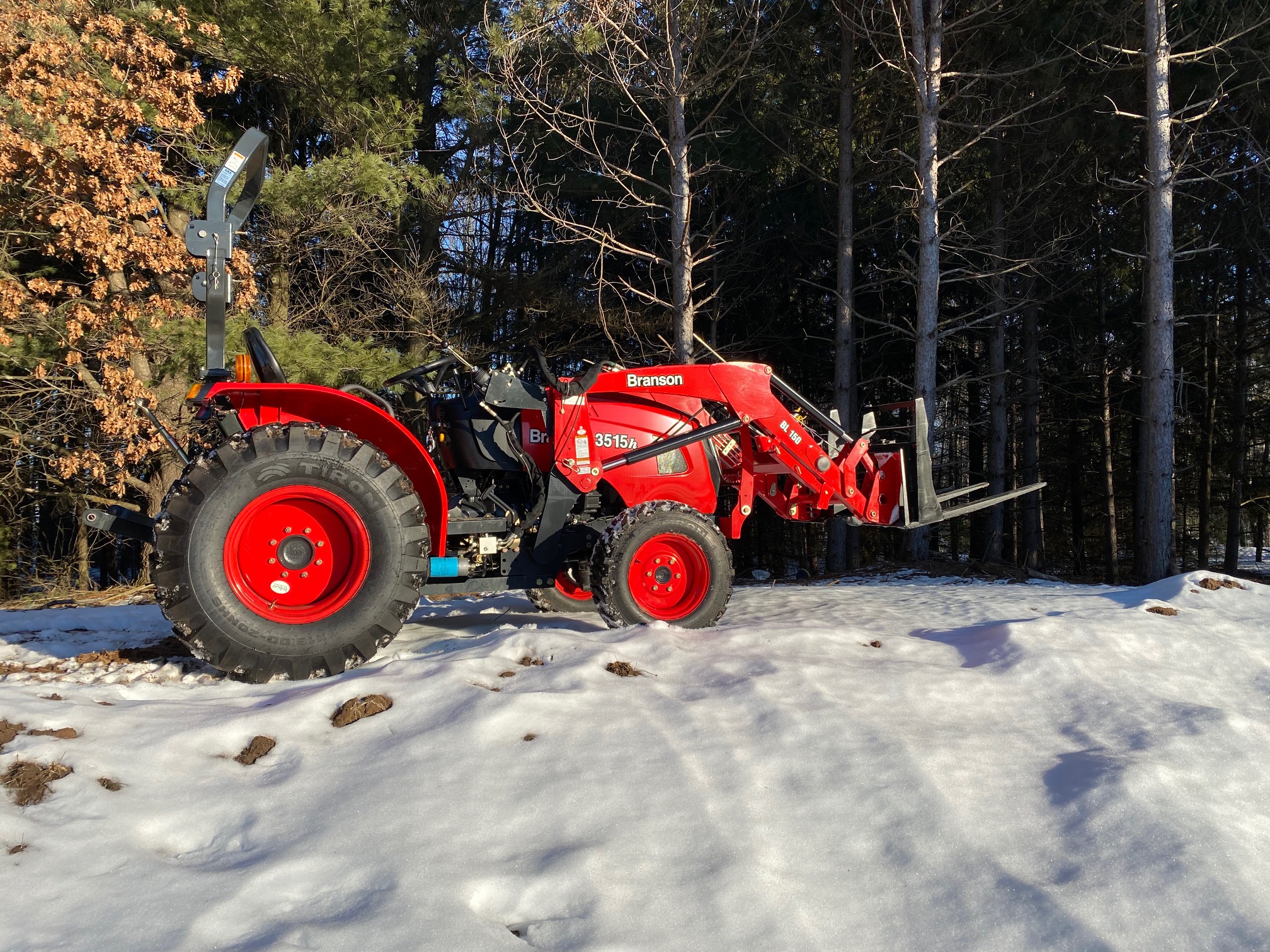

Branson 3515H
I bought a 3515H with forks a grapple, and a box blade. I have never owned a tractor, but I'm in love. I think my wife is jealous it was dropped off Thursday and I have 15 hours on it already. I have been watching these forums for a week and appreciate all the info. The 2 main reasons i bought it are limited electronics and the loader lift capacity.

Welcome to TBN. Congrats on the new toy! Looks nice!
Sometimes dealers can overlook things during the pre delivery inspection, so don't forget to check the loader mount bolts and lug nuts and here is a list of all the zerks as the manual only displays some of them:
- 1 for the left tie rod
- 1 for the right tie rod
- 2 for the front axle pivot blocks
- 1 for the clutch pedal
- 1 for the brake pedals
- 2 for the release bearing clutch pivot shaft (one on each side) These two are kinda hidden and are a bit of a pain to access with the grease gun, so they can be overlooked by the dealer.
- 1 for the top link draft linkage ( I don't think this applies to US models)
- 1 for the adjustable side arm
- And of course, loader ones.
Remember, with great loader lift capacities, comes great responsibility. :D
Although it's a heavy tractor, I would still consider getting the rear tires filed and/or attaching a implement on the 3 pt.
Enjoy the new toy. :thumbsup:
