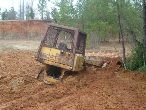

I was on a roll. I finished off two areas that I'd been wanting to get done and decided to clean up an area with some drainage issues.
It was getting late, but I still had plenty of light out. I was moving dirt and happy with the results I was getting.
The low area was holding about two feet of water. I filled it in and cut a wider drainage canal to bring the water away from the hill and spread it out to dry faster and minimize erosion.
The darker it got out, the more impatient I bacame to finish it off. I knew I could get it done nf just a few minutes, but was having trouble seeing.
That's when I made my mistake. I went too far into my fill area and sank.
This picture is what she looked like yesterday morning.

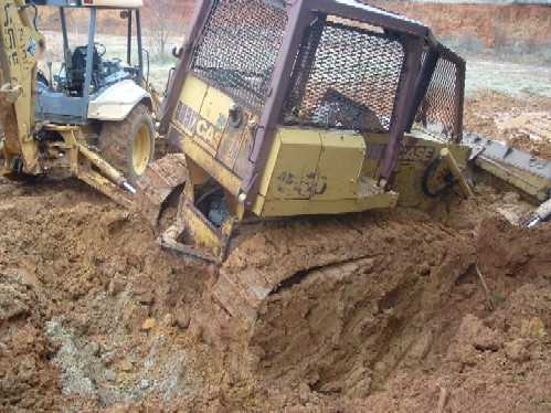

She weights a lean 40,000 pounds and all woman. hahaha
First step was to dig out all the dirt around her and hope for the best.

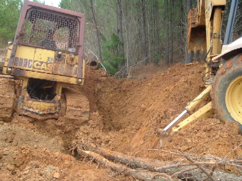

Just digging around the sides wasn't enough. Next idea was to add some traction with a few trees. I also made the hole bigger.

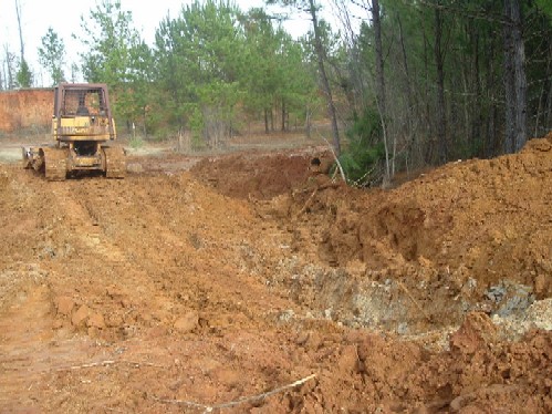

I used to have a culvert in that area to help with the water issue I was attempting to correct. Instead of one 20 foot culvert, I have a bunch of culverts 2 to 4 feet long.
The logs didn't work, so I my final idea was to get to dirt out from under the belly pans. I figured she was resting on her belly and the tracks wern't getting a hold of anything.
It took a regular shovel and a garden hand shovel to finally break her free. I was gonna take a picture of the little tunnel I dug under her, but by the time I was done digging, I was done messing with the camera!!! hahaha
This picture is her after she broke free of the mud hold. She still couldn't get out of the hole, but that is just a matter of cutting a ramp.

Once she had traction, it was simple to cut a path out of our little hole.
That was the first time I've gotten something that big stuck. I'll have to be more careful in the future.
It kind of reminds me of my first jeep. I figured it's four wheel drive and I can go anywhere. Ooops. I learned real quick how untrue that is. Same with tractors and dozers.
I've run a little John Deer 450G that only weights half what this one does. When I buried it in the mud, I just hooked a chain up to my backhoe and out she comes. Real simple and easy.
Theres a reason for small light dozers.
There's also a reason for big heavy dozers. I've started a new project clearing land with her and will start a new thread with those pics pretty soon.
