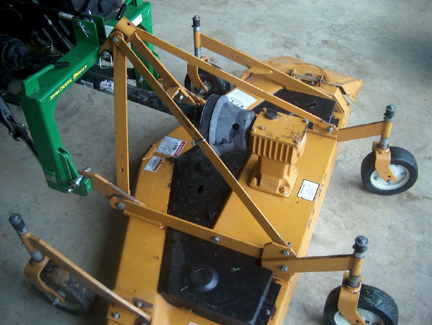

its a woods rm550. i will try and post a pic. tell me a fair price for this good condition mower. It mounted right up to the iMatch!

i am trying to get in touch with Woods to get some touch up paint. i will sand off the surface rust and do some painting, should be good as new. the only new price i could find was 2180. that seems high, but was all i could find, let me know. thanks.

I've been shopping for a RFM and I've saw prices all over the scale for this type of machine. The cheapest I saw was $550. Side discharge seems to sell cheaper than rear discharge. Not sure your iMatch is a good match. If you had a quick hitch with adjustable top hook it would work great. The way yours is hooked, you have very little float on the top link. Hopefully your lawn is relatively flat?

I think you still need the Woods RM Quick Hitch Kit or, at a minimum, the LandPride Quick Hitch Kit. See the picture below. Note they replace the lift arm braces with chains so the rear of the mower can tilt up; this comes into play at the bottom of a hill or when backing into a hill.
With the way you have it, you would want to be careful when lifting the mower. If you were driving over bumpy ground, the floating top link could pop out of the iMatch and the rear of the mower would drop to the ground! These kits prevent this from happening.
