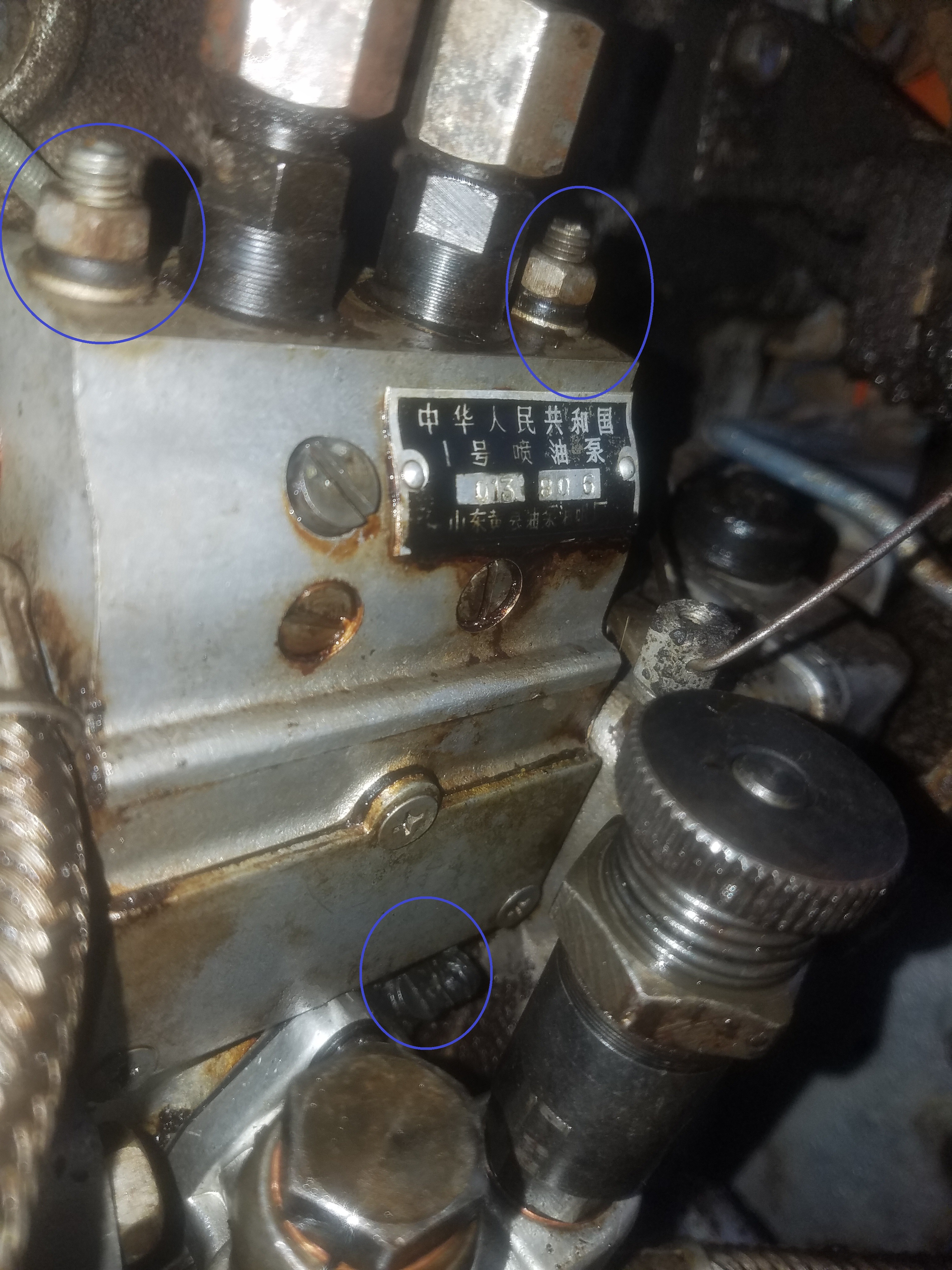

There is a small black plastic dipstick. When I initially checked it the oil level was below the stick so I drained it an put in 20W non detergent oil. After it ran the first time, I drained some oil and added a bit of the marvel mystery oil thinking it might loosen things up. Can I pull the 2 nuts circled in blue and not have anything fly apart? Or is it safer to take off the cover with the 3 screws? Is the rack what adjusts the volume injected per stroke?

Put the MMO back on the shelf. Use the same oil in the pump/governor assembly that you use in the engine. Please reread my previous post about the cover plate and disregard the two circled nuts. I suggest you do some research on diesel engine governors and fuel injection pumps to learn about barrel and plunger assemblies, scrolls and helixes, and why there are no seals in these pumps.

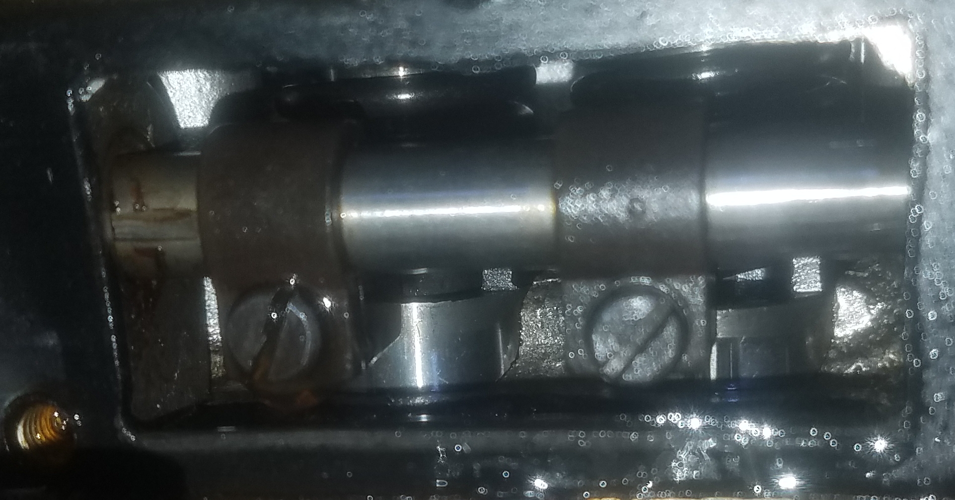

Got it. Did my homework today and read up on the pump, went out and pulled the cover and the rack was not moving at all when changing the throttle position. Gently pried to slide it and then pulled the back cover on the pump to expose the end of the rack shaft and pushed it back. It took a decent amount of force to move it. Applied oil between each manual movement of the rack and after about 100 times it seems to free up pretty well. Put the back cover on and the throttle position now changes the rack position. Thanks Bob for pointing me in the right direction.
