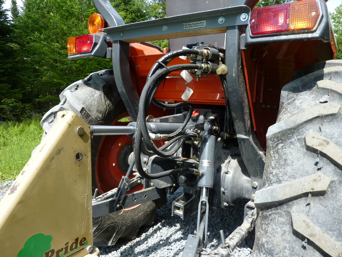

I recently installed Pat's Easy Change System on my Kubota 3430. I'm very happy so far. I had one of those "why didn't I do that years ago" feelings.
Well, that has brought on a want/need feeling for a hydraulic top link. This is for all you users of HTLs. How would you rate them?
1) Must have; why did I wait so long.
2) Nice addition; useful.
3) Like it but could as easily done without.
4) Wish I hadn't wasted my money.
I got a quote from Fit Rite Hydraulics, $262 which includes the cylinder, hose kit, hydraulic flow restrictor, and shipping. All feedback is appreciated.

For me it turned out to be catagory 1 on your list. I've had it just over a year now. FitRiteHydraulics. Adds alot of versatility and convienience.

I am curious on how you hook up the top link.. so school me some.. Isnt the hydraulic top link going to drop down and point toward the ground, due to its weight, just like the screw jack does? and how do you hold it up to point to the attachment point while going around the right tire to get to the hydraulic control. to extend or retract the cylinder rod to make the length correct to get hooked up.. My arm is not that long.. I can see it if you could reach the control valve lever and hold the cylinder up with your left hand, But I cannot envision on how to do this the way my control lever is set up from the factory.:confused3:

Just use a small bungy cord. Thats what i use to hold it up if i need to make an adjustment to get it hooked up.

I recently added TnT to my tractor so I'm still learning how to use it. So far though I definitely agree the HTL makes hooking up my various attachments easier. It's also easier and saves time while using my attachments to make adjustments right from the tractor instead of getting on and off the seat. When I use my no till drill and bush hog I want a level grade and just adjust the top link. For using my rear scrape blade, landscape rake and box blade however I also felt it worth the investment of adding the hydraulic side link. When grading our gravel road I find I'm actually making adjustments more with the side link to pitch the road to get a proper crown as well as ditching the sides. Brian from FitRite Hydraulics custom made the side link for me. I already know I would not be happy having to go back and manually make link adjustments. If my dealer had demonstrated TnT when I was buying my tractor I would have added it sooner.

I thought about this dilemma as well. However, I checked and I can easily reach the lever that controls the hydraulic valve so this shouldn't be a problem for me. Maybe some of you HTL users can weigh in.
