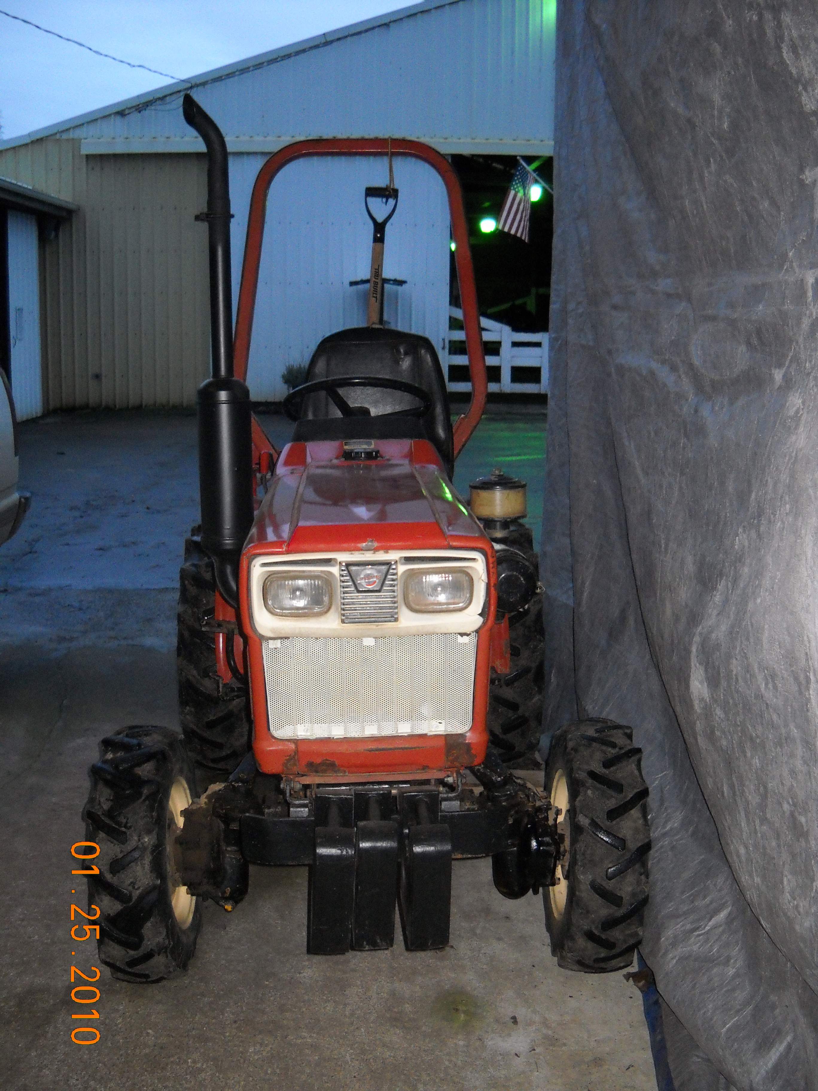

Has anyone ever reversed the front rims on a 4x4 MF1010, to make it a wider track? It looks as though someone did that on the rear wheels, since the inflation valve is on the inside of the wheel.
I know for trucks, there are usually spacers that widen the wheelbase, if so desired.
   / Got the right size tires on the MF1010 #2
For reversing the front tires, just take the left tire and rim and put it on the right side and vice vesa. You can see in my picture that i have reversed the front tires on my Yanmar once. it was very simple but I swiched them back so i could get between trees when im working in the woods. I have the Simplicity 9518 (same as massey 1010). glad to know there's people out there with a similar tractor.:thumbsup:

As to dishing the tires in or out, for the 4x4 model, the manual says ag tires cannot be dished out on the front. Maybe they changed that on later models. I assume what they mean is it won't change anything.

OK swapped them around tonight, but didn't get to test em out yet. Fit with no issues. The added about 5" to either side of wheel base.
