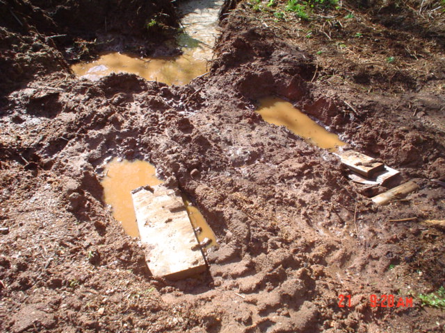

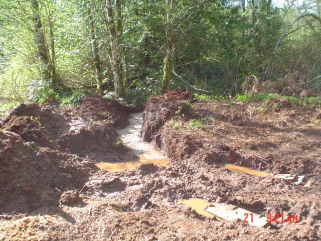

Well had the tractor out a couple of weeks ago to level an area we wanted to build a new chicken coop. I had driven over this area a few times before with no problems. Was going back and forth trying to just scrape a few inches off the top as we are going to put in a cement foundation. Then it happened, tractor wouldn't go and realized the back was in mud. Put it into 4 WD but that didn't help. Took a deep breath and pondered what to do to get her out. Had the backhoe on so used the stabilizers to lift the back end and put some scrap 2 X 6 bits of board under the back wheels. Dug out the front ones a bit as they were down a few inches. Put boards in front of all the wheels and out she came. Put the tractor back in its home as I was calling it a day, didn't want to push my luck. Next day I dug a ditch to help drain water from the area into a seasonal creek close by. Lucky I had the backhoe on, made getting out simple. Measured the mud line on the backhoe and it was 19 inches. The most interesting thing is my wife was gardening not far by and didn't even know I had gotten the tractor stuck. Sometimes I can use loud and interesting language. :D:cool: Guess I just didn't get that excited about it.
So found a new use for the backhoe :D :cool2:

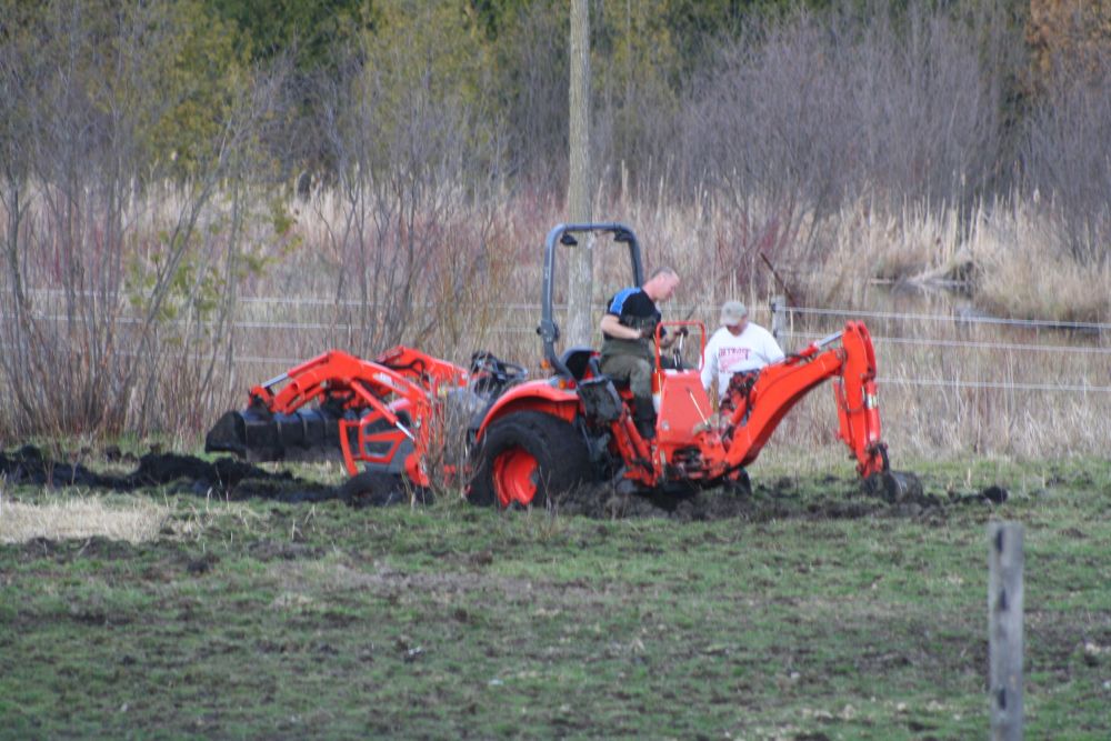

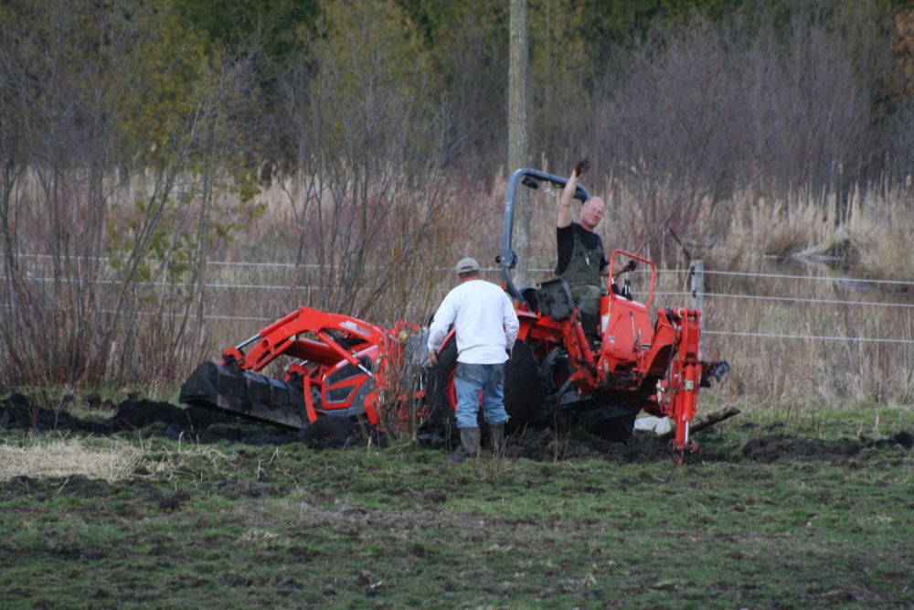

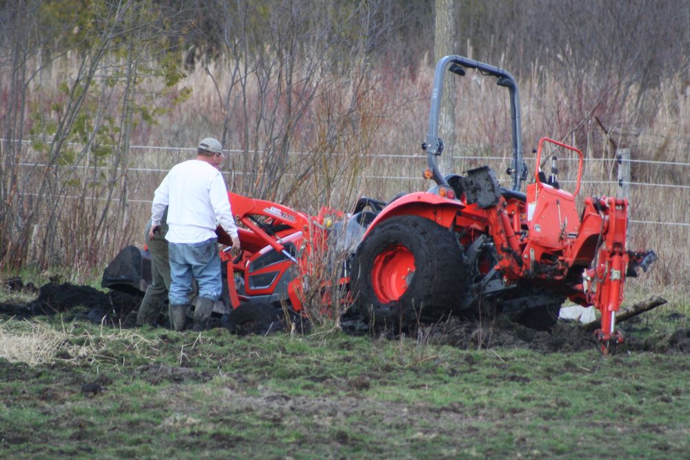

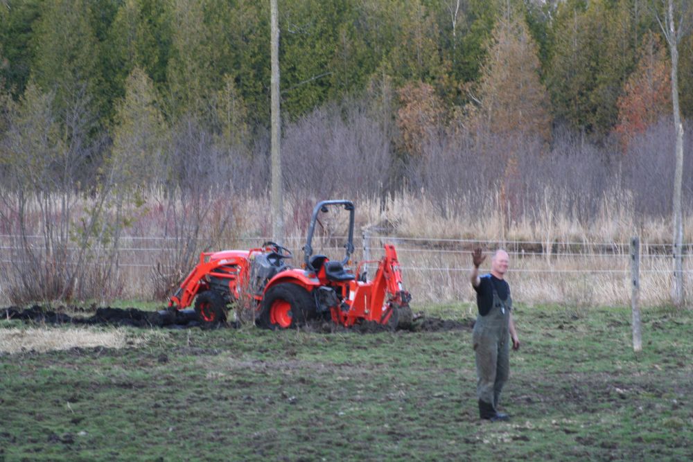

Well, since you are sharing....
This is my neighbour and I stuck in his field. It went from dry and firm to goo in about 10 feet. Took over 2 hours to get out. The goo was so deep when I tried to put the bucket or BH down they would just sink deeper and deeper. We had to lift what we could by putting down boards and so on. It took us a whole 6 pack to get out!
I'm the guy in the overalls with the muddy hands. The other fella is my pal Kenny.
It was fun to be honest. Got a little tippy trying to lift the back end with the hoe though.

We have our own environmental laws up this way. I only dug the ditch towards the seasonal creek, which flows into our year round one, it still has to naturally find its way about 30 ft to the seasonal creek. :) Since we moved here we are no longer allowed to do ANYTHING :( within 10 meters (about 33 ft) from the TOP edge (bank) of our year round creek. In some ways that is good but it does run 900 ft through the property, that's a lot of land to give up with no compensation. My wife and I have received, from the local stream keepers, an award :thumbsup: for being good stewards of the creek/land, we do try to be sensitive about the land/environment.

Good job getting out of the mud. It is amazing how quickly they sink, and then absolutely no traction. I am glad the muck was firm enough so that the BH could lift the tires. I similarly stuck a rented tractor in the lake bed at my house several years ago. It has BH and FEL so I thought, "No problem, I will just walk this thing out" No such luck, the black muddy muck in the lake bed did not offer enough resistance; the BH and FEL just sank. I was able to swing BH to the side and raise one tire at a time, place boards under and proceed. Got it out after several tries at this.
