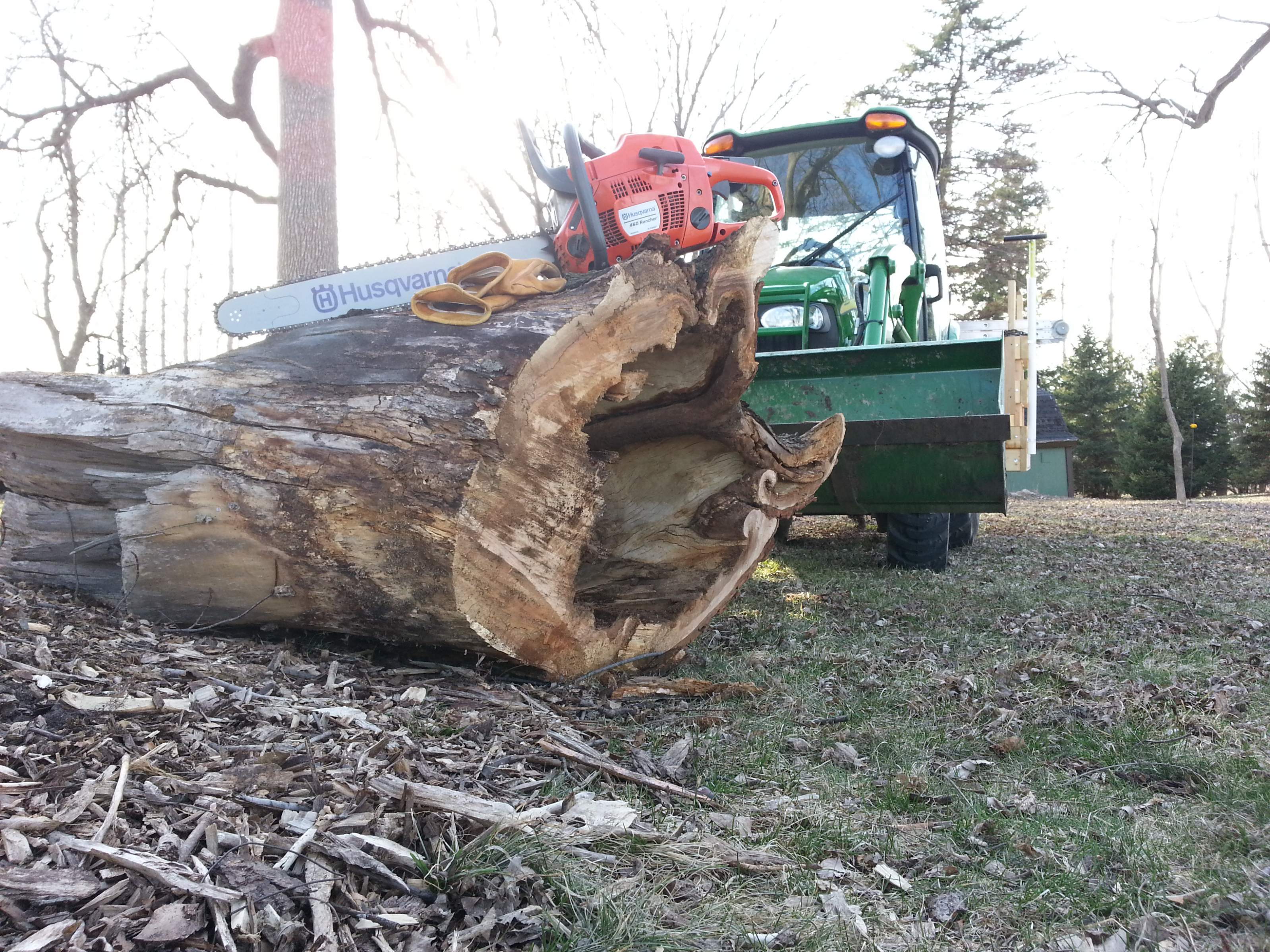

I've been using using my 18" bar for almost everything but today i decided to pop on the 24" bar and try it. granted most of this limb was hallow so it wasnt a full load for it but part of it was solid and totally sunk the bar. it handled it well but you can tell 24" in hardwood is a load for this saw but for the few times i need a huge bite its worth having around.
Also finished my wood cutting carry all i use to haul my gear into the woods and the logs out of the woods.
I posted a couple pictures in the attachment section if anyone is interested in my wood cutting rig.

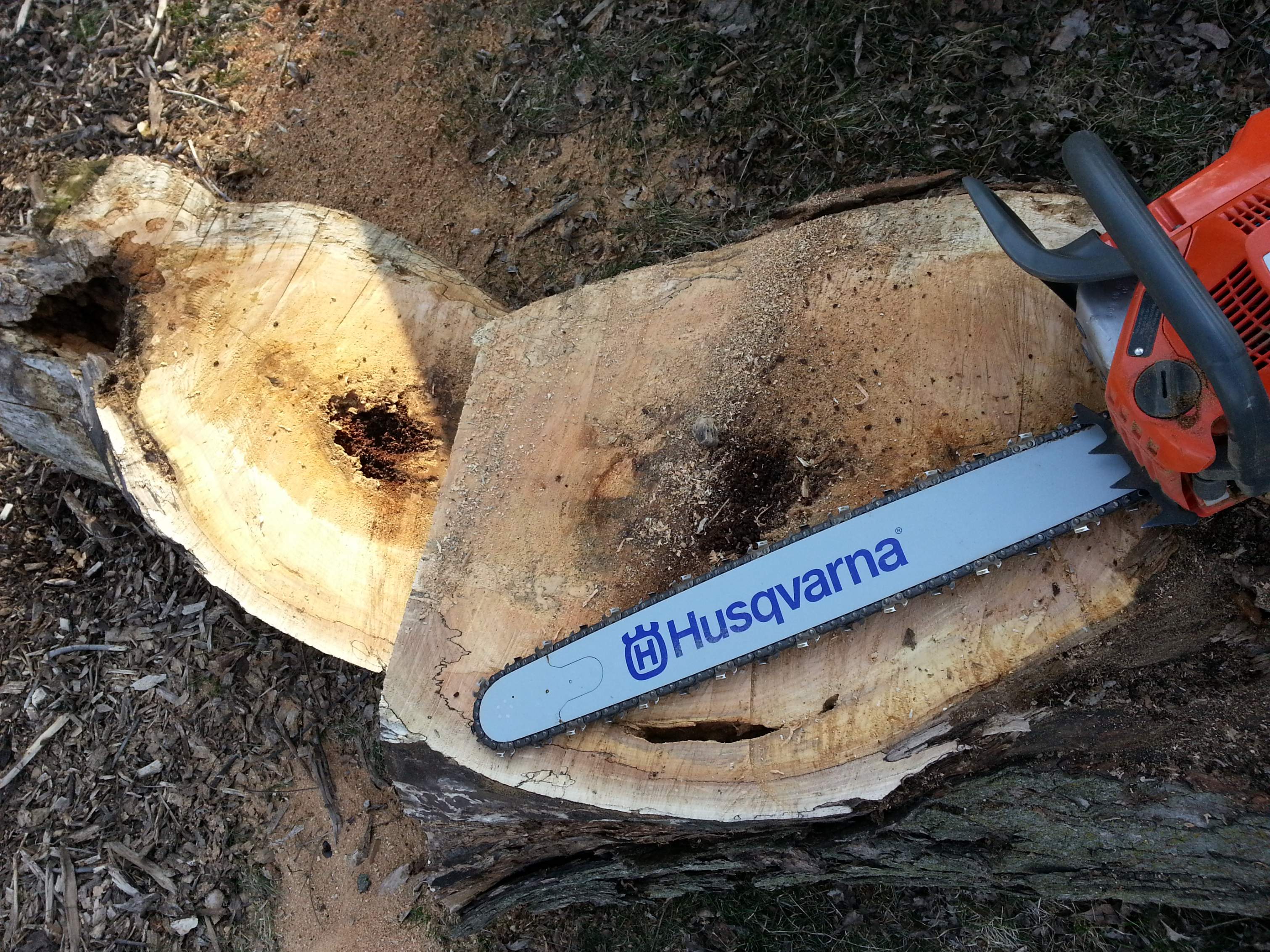

Thanks good info i should do that. in pine this chain does fine but in hardwood she gets a little slow i don't want to overwork the saw. most of the stuff i was cutting looked like this.
   / Got to try my 24" bar on hardwood today #4
Sorry BR but this is no test at all to measure your saws cutting prowess with a 24" bar. The real test would be to bury your bar in a solid 28" piece of hardwood. Be careful if you do and not feed the saw too fast.

I agree a hollow log is no test the above picture had the bar totally sunk. though its getting soft in the middle still.
I'll talk to my husq dealer about a skip chain. granted 95% of my cutting is with the 18" bar. the 460 flat out rips with an 18" bar.
It'll be good to have if you want to use your 24" bar with any efficacy at all for that occasional thick piece.
