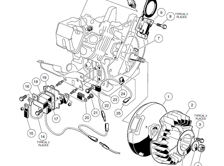

The rev limiter is used on Club Cars to prevent destruction of the engine by users who don't care.
Here is a cut and paste from the PDF on an older Club car.
ITEM PART NO. DESCRIPTION
18 101909401 Limiter, RPM, OHV
FE290 ENGINE –
IGNITION COMPONENTS AND FLYWHEEL
Here is the Club Car site:
This jpg shows the connection to the engine ignition system:
The rev limiter monitors the frequency of the ignition pulses and cuts the spark, limiting the rpm to about 4,000. Is it placed in-line with the kill switch.
