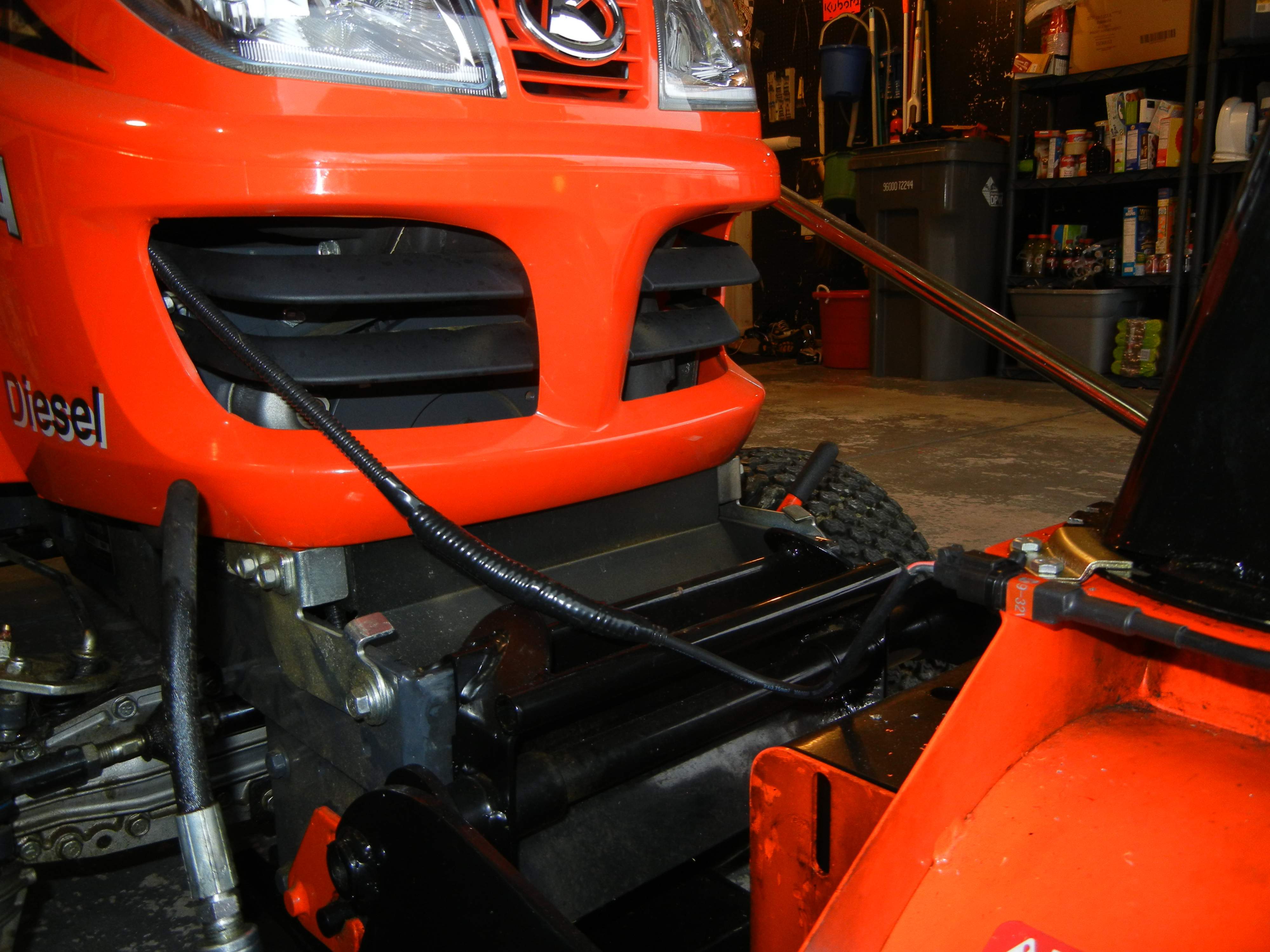

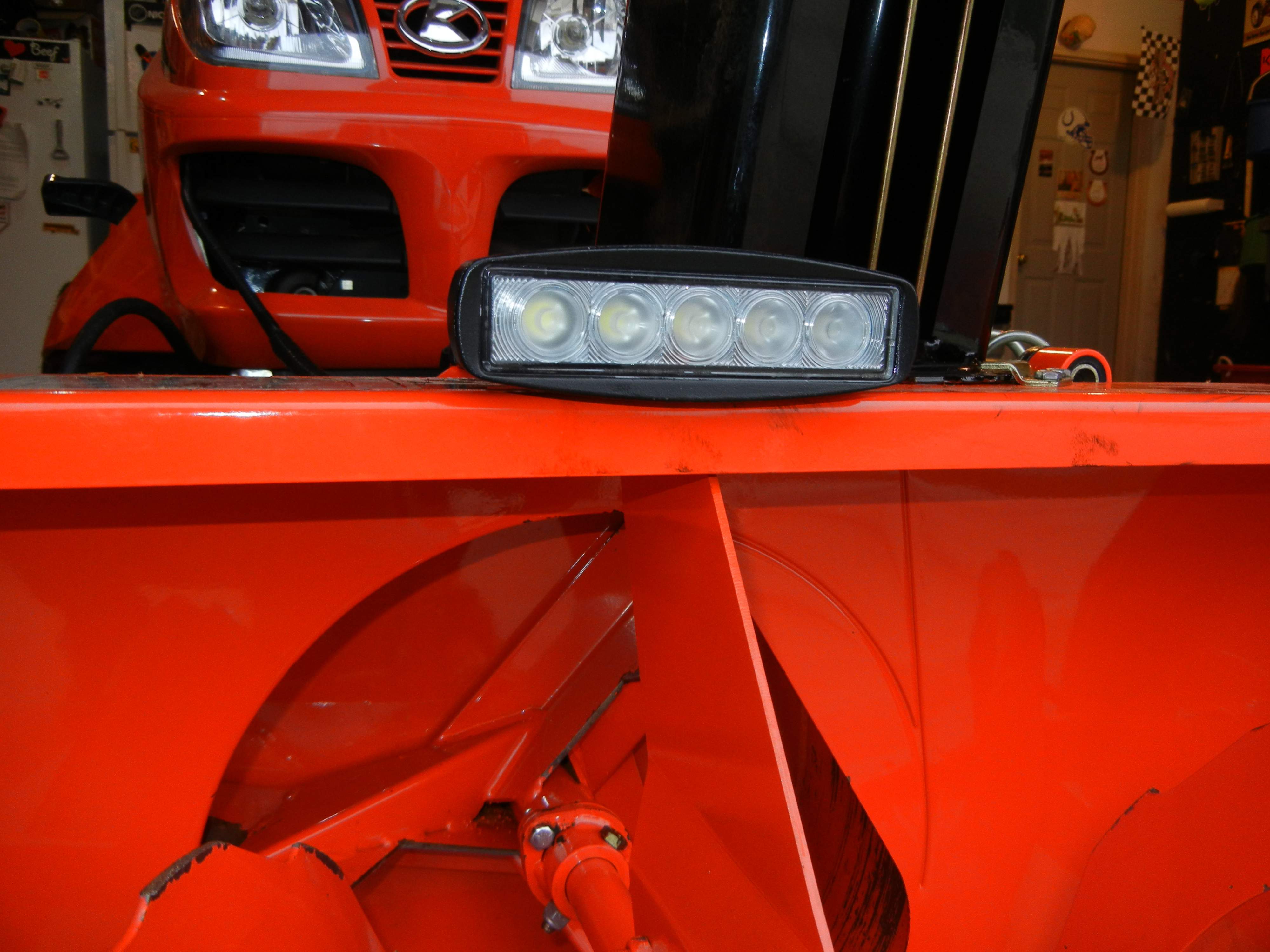

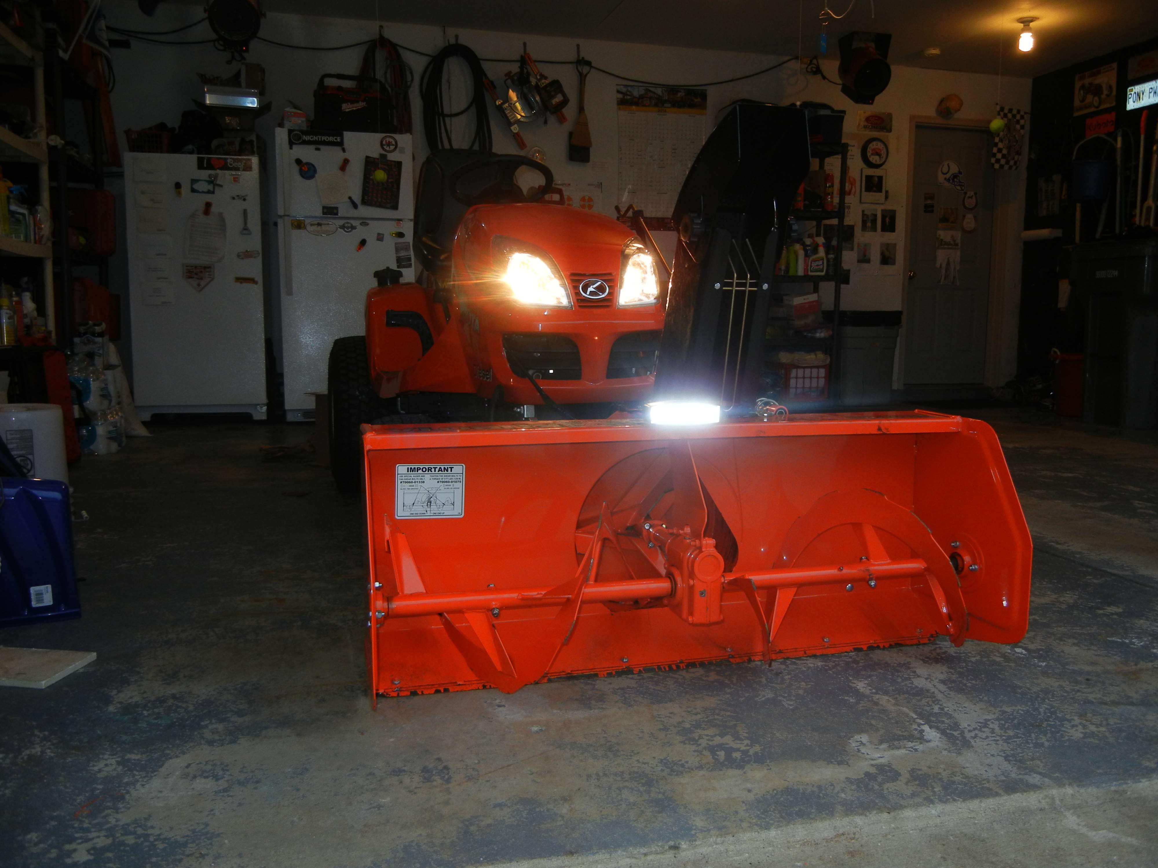

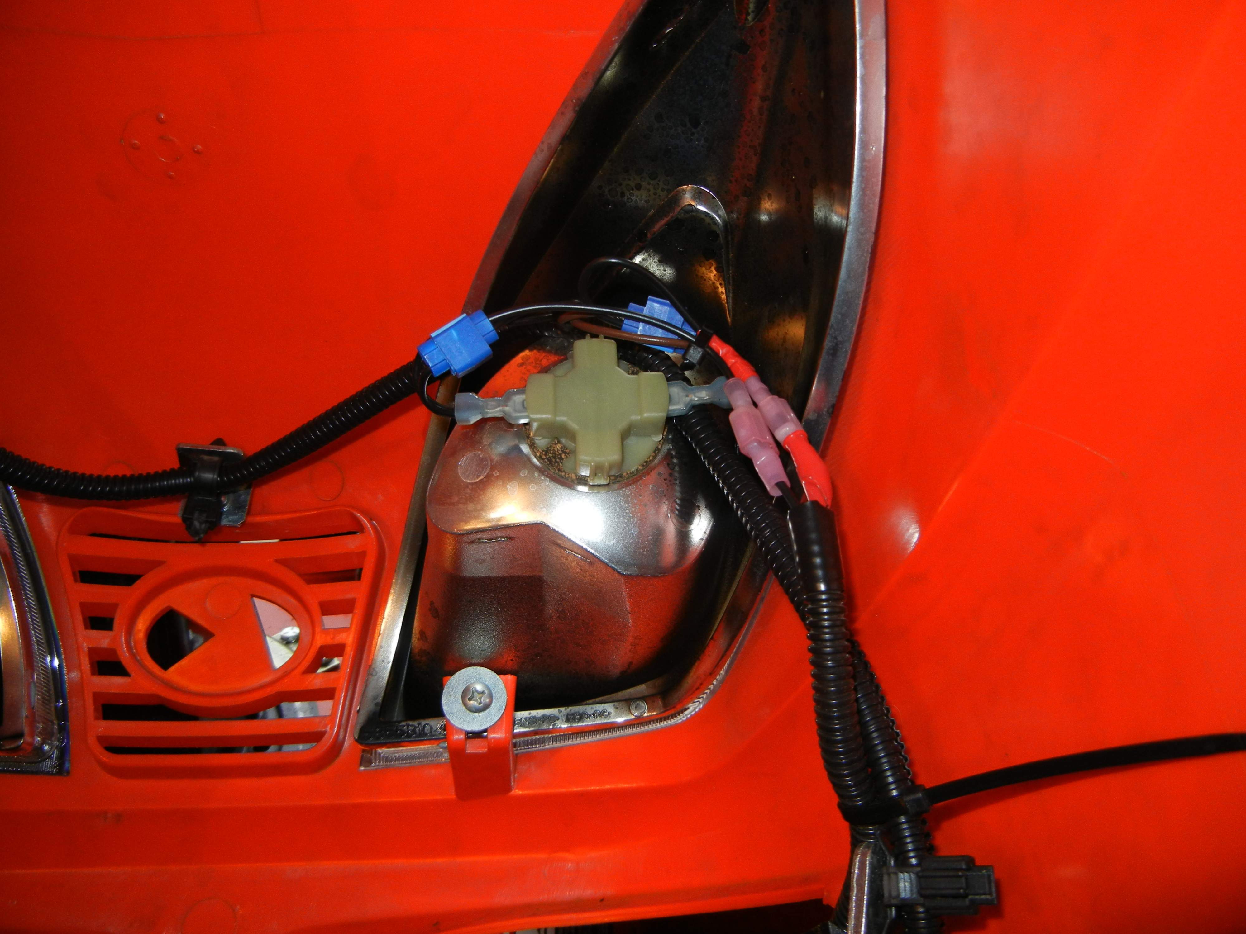

Got to use my GR2120 snowblower allot last winter. Main complaint would be lack of lighting. I just added a led light to the blower itself. I got 2 lights, but found a very simple mounting method for 1 light utilizing the gearbox brace. Just took the oem bolt out, and added the light bracket. Wiring was very simple too. Drilled one hole to tie wrap the harness to the blower, routed thru the grill, tie wrapped to the existing harness, and did a simple spice to the oem light harness with 1/4" spade connectors so I can remove it in the spring. This light only draws 1.2 amps, so pulling off the oem wiring will not be an issue. This will be a big improvement, but I may want a wider angle light if I am not happy. This may also work for a BX snowblower. Philip.
