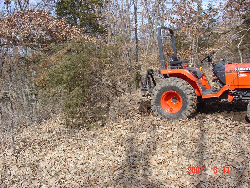

Here's what you need. Then your FEL is free to do piling duties. It's the simplest, easiest to build, most effective attachment I ever built. You can modify to fit your personal needs. Best part is you never leave the tractor seat. :)

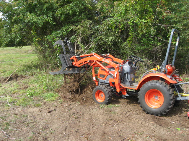

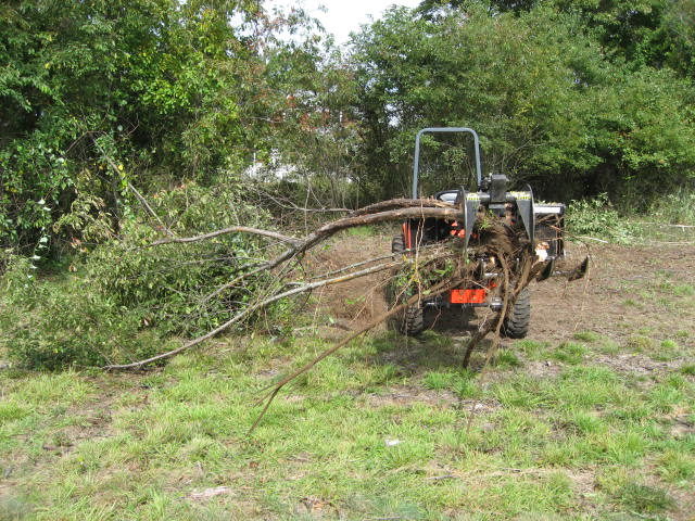

   / Grabbing Small Tree Trunks #9
A Root Grapple works fine. You don't try to grab the trunk however, you simply slip the grapple teeth under the tree and lift. For trees less than 4-5 inches it works very easily. No need to get off the tractor to fiddle with straps, chains etc. Steps are as simple as 1) give the tree a shove to knock it partially over and expose the roots, 2) put grapple under roots and either lift or drive forwards to pop the tree out, 3) grab it and you're done. See photos.
