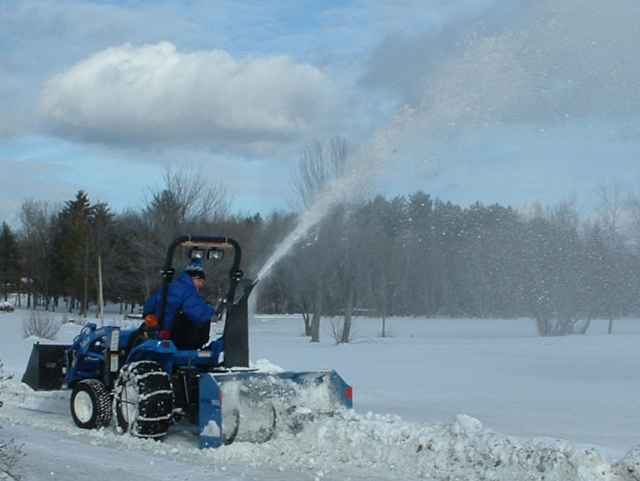

I gave her a test run down a scraper bank using a Gr 2. Lots of chunk ice and some small stones from the road, no problems. That's my dad on the machine - he's much better at running tractors than digital cameras /forums/images/graemlins/wink.gif
Brad
