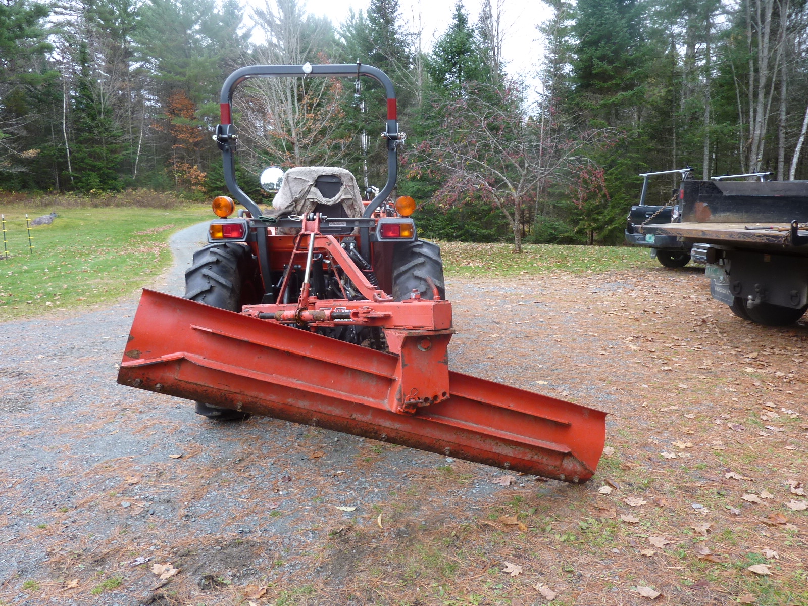

I知 having trouble finding a 5 grader blade that will tilt - is it because everyone is tilting them with their lower links on the 3 point? I知 wanting to dig a ditch for my roads with a smaller tractor. I know my grandpas 8 blade tilts (and I知 talking about lowering one edge, not spinning the blade closer/further to one tire.

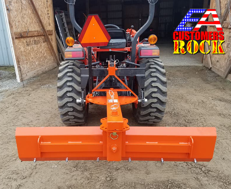

Here you go. You’re just outside their free shipping range tho
6 Way Deluxe Scrape Blade for Compact Tractors

Most of the major brands offer tilt on there blades, they cost more than without tilt..

I own 3 rear scrape blades.
One - brand unknown
One - King Kutter (tilt)
One - EA 6 Way Deluxe Scrape Blade
I have two blades for sale!
The brand unknown, and the King Kutter.
The EA blade is 1000% better than either of the other two.

Thank you guys! I would agree that the 6 way would be soooo much better. Thank you for the kink - I think I値l give them a call and see if they値l work with me on the free shipping distance...maybe they could ship it to my buddy in Joplin.

LandPride RBT series (Rear Blade Tilt) if they still make them. I have a 6 footer.
Also a 7' Tufline but not sure they are still in business
They ship outside their 1000 mile "free shipping" distance every day.
If you are just barely outside, they may ship for free anyway, if not, they will likely charge only a very little bit for the distance beyond 1000 miles.
Do understand that they only ship to the nearest freight terminal, or a business address, for free.
Shipping to your residence is much more expensive.
Their "6 Way Scrape Blade is worth every penny"!
