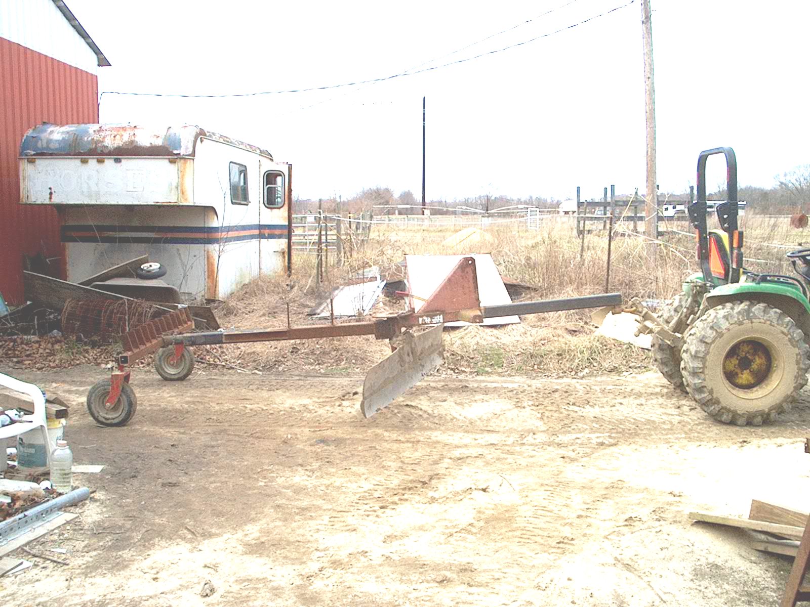

here is what i did with a used blade that did a very good grading job.
not fast but very smooth and level
used it to grade an oval horse training track
