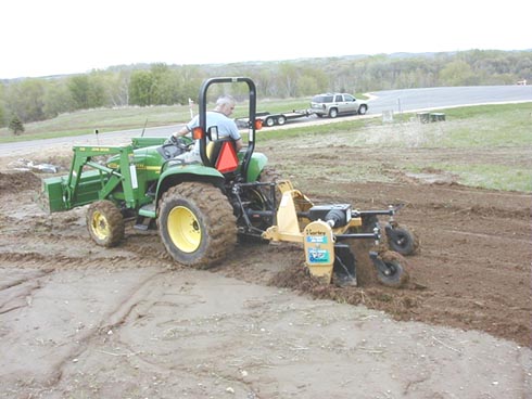

There are landscape rakes and there are powered landscape rakes. The powered ones are much better, and look at the Harley rake for the ideal way to grade your rough yard. There are past posts that are searchable with pics as well.
If you could rent a Harley rake, it would be the best way to go. It's what I do, and it's a one, maybe two passes, and plant grass seed.
