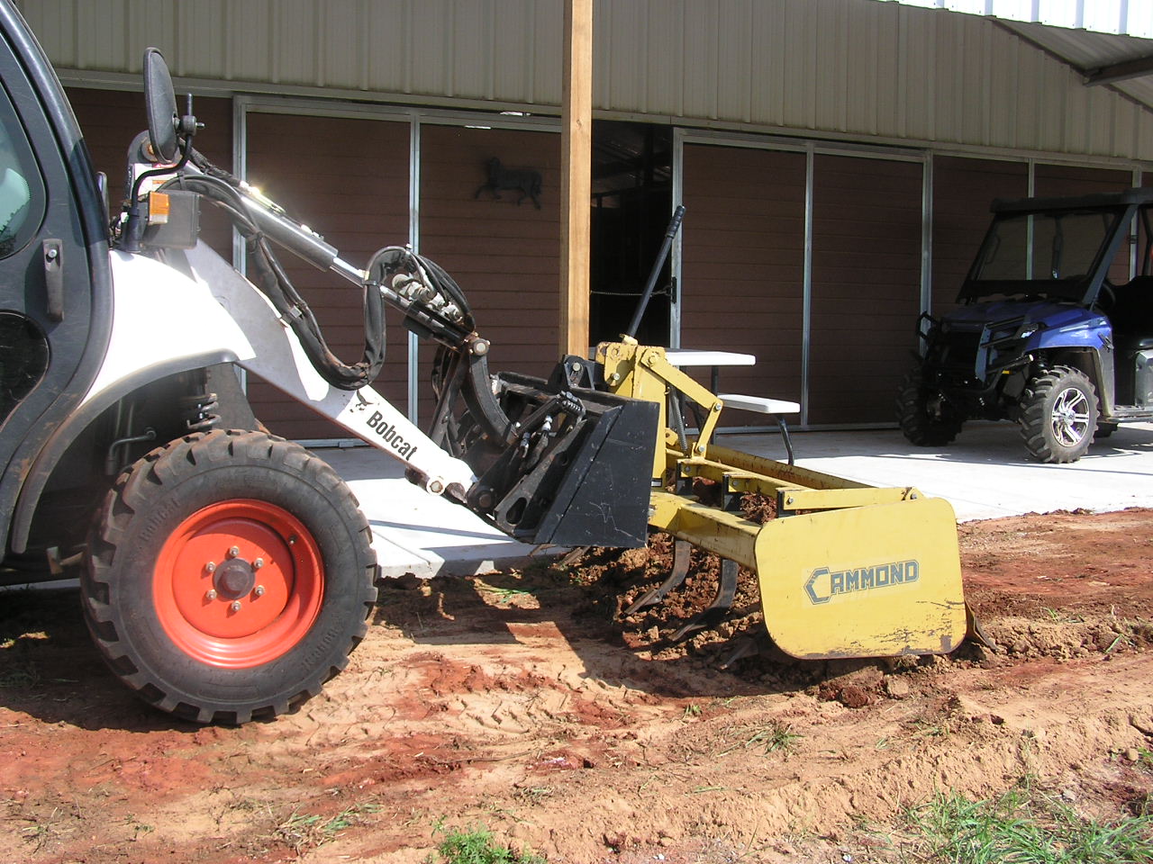

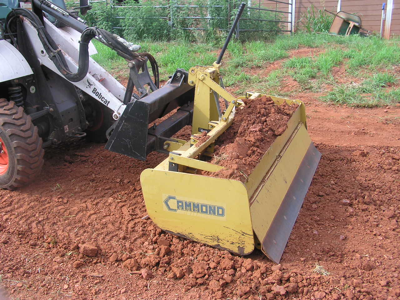

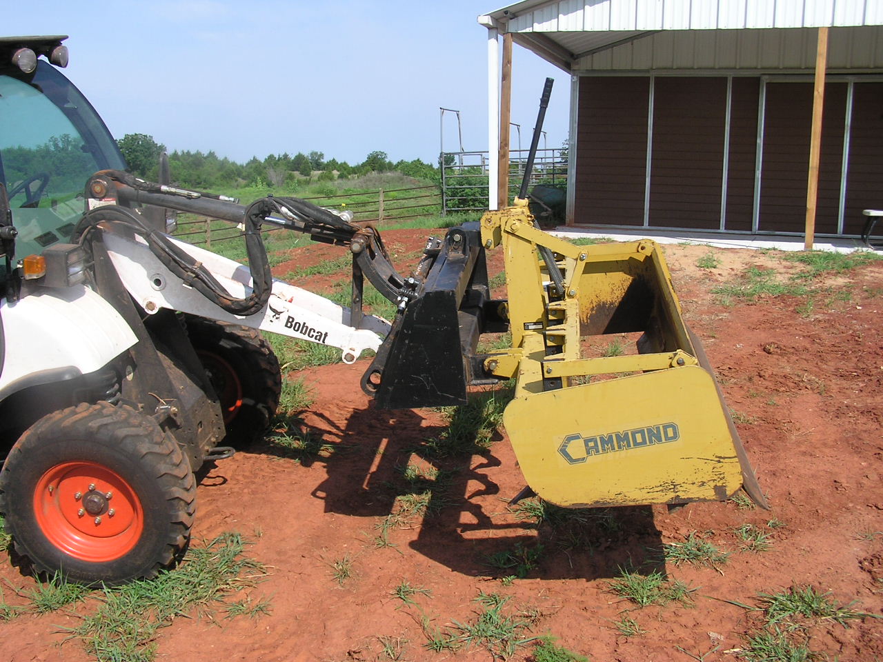

This is my grading attachment, a 6' box blade on a 3 point adapter:

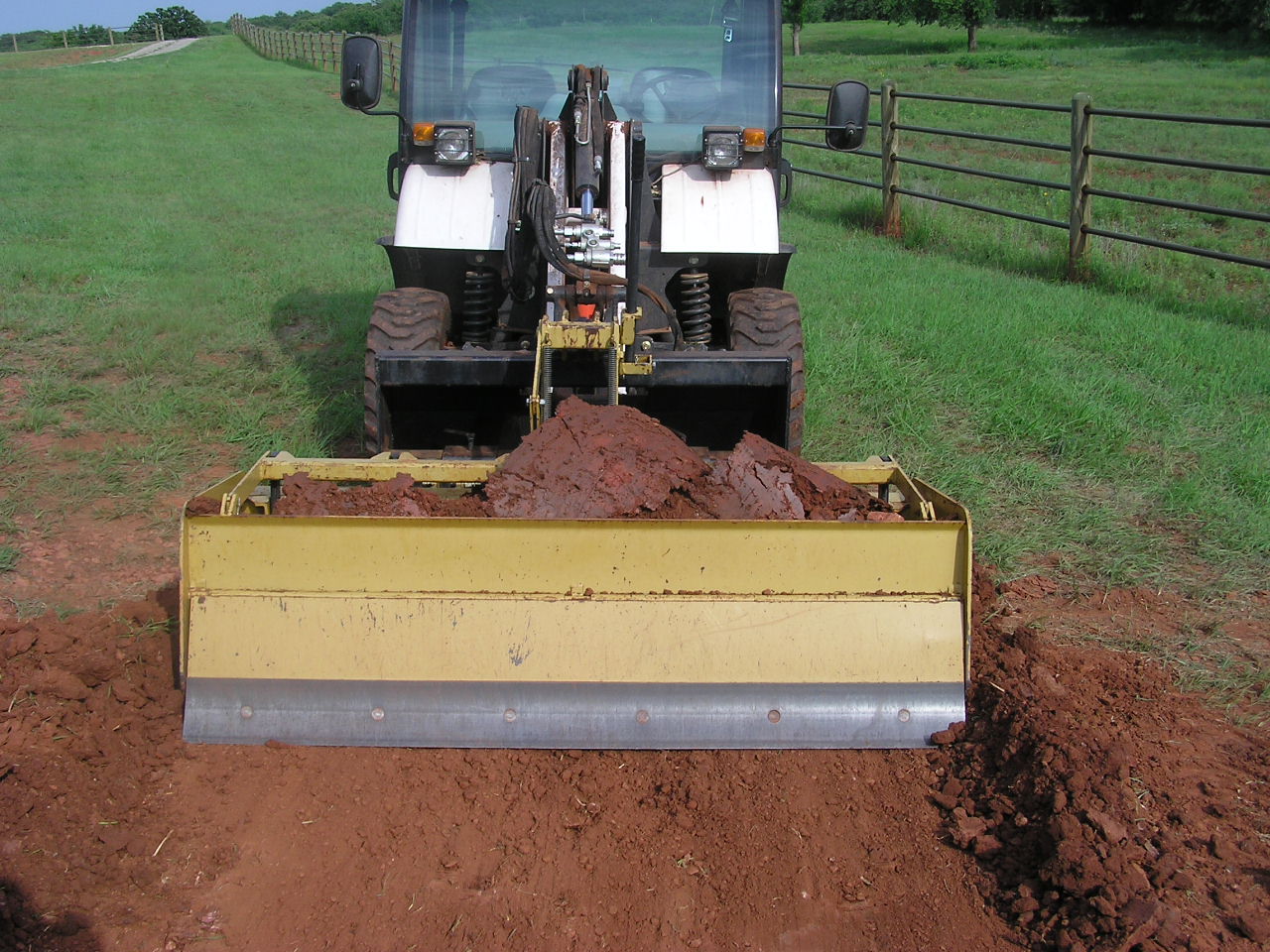

Dozer mode:

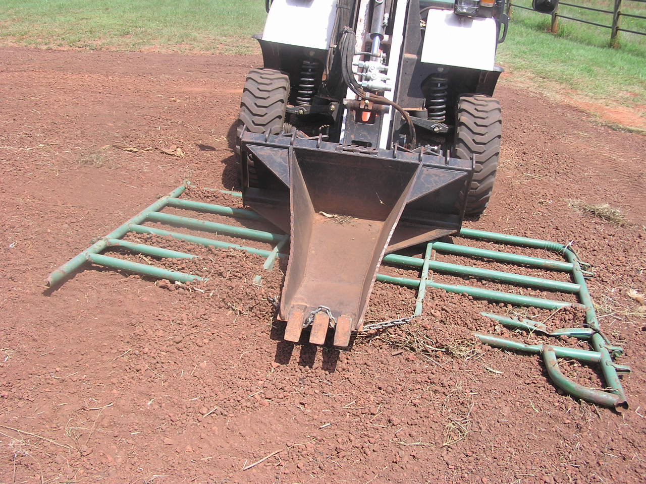

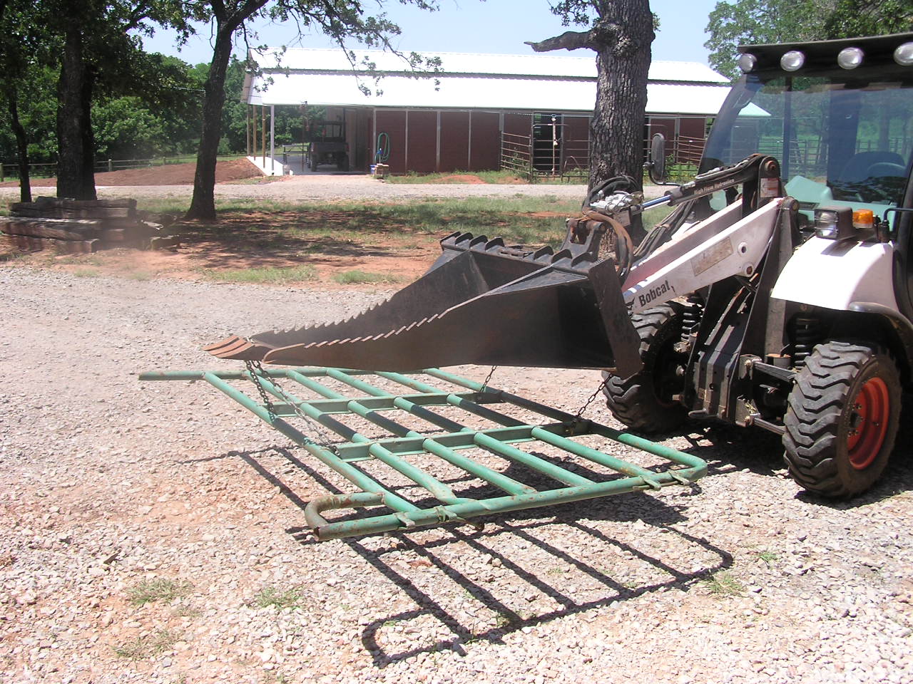

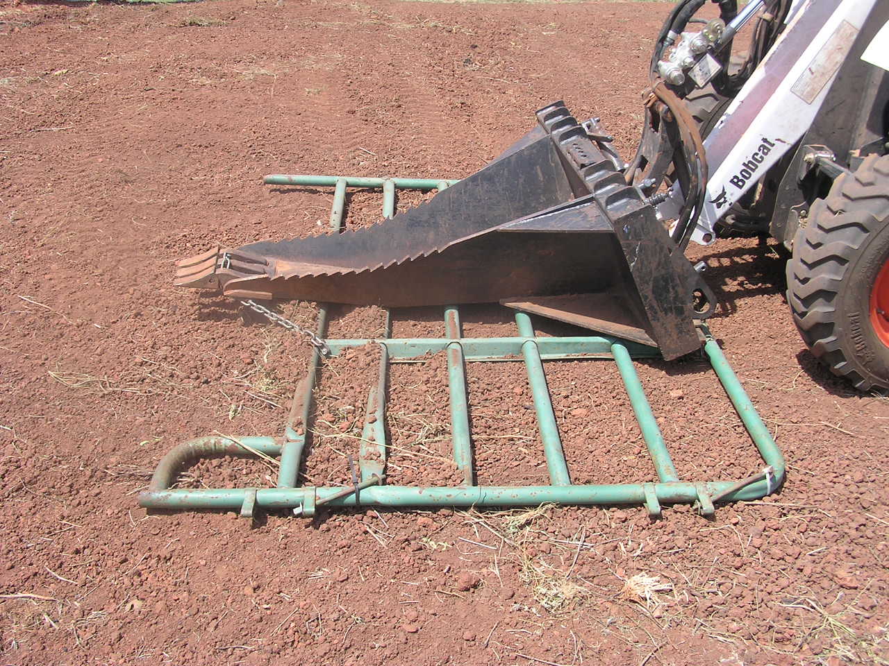

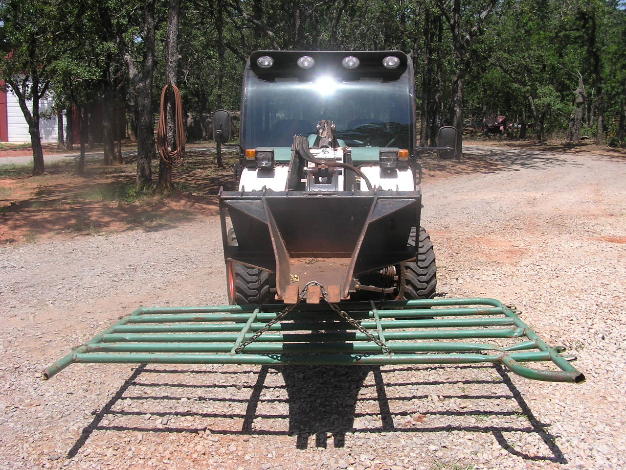

And my land plane :D:

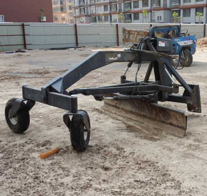

this is the grader attachment Im referring to, anyone used one on the Toolcatbobcat-grader.jpg_300x300.jpg

this is the grader attachment Im referring to, anyone used one on the ToolcatView attachment 623957
I figured that was the attachment you were asking about...nice. For lighter work, I would think the toolcat would work fine. For heavy work though, I think the double loader arm strength of a SS would be better. Also, the toolcat has suspension so it might not be stable enough with heavy cuts. :2cents:
   / grading attachment on Toolcat #7
Bobcat is usually cautious about approving certain attachments to carrier machines. The grader is listed on their website as approved for the Toolcat although it may not work as well as on a skidsteer or track loader.
it works decent on the skidsteer, Im sure it would work on the Toolcat for grooming but the lack of arms is my concern, the suspension is not that much as I find it works better in float, anyone used this attachment that can give some pointers as how to get the best use of it?
on the drive way its use is smooth out washboarding and pull the gravel from the sides, its not great at least for me on the yard getting it flat, seems its always digging in the sides
