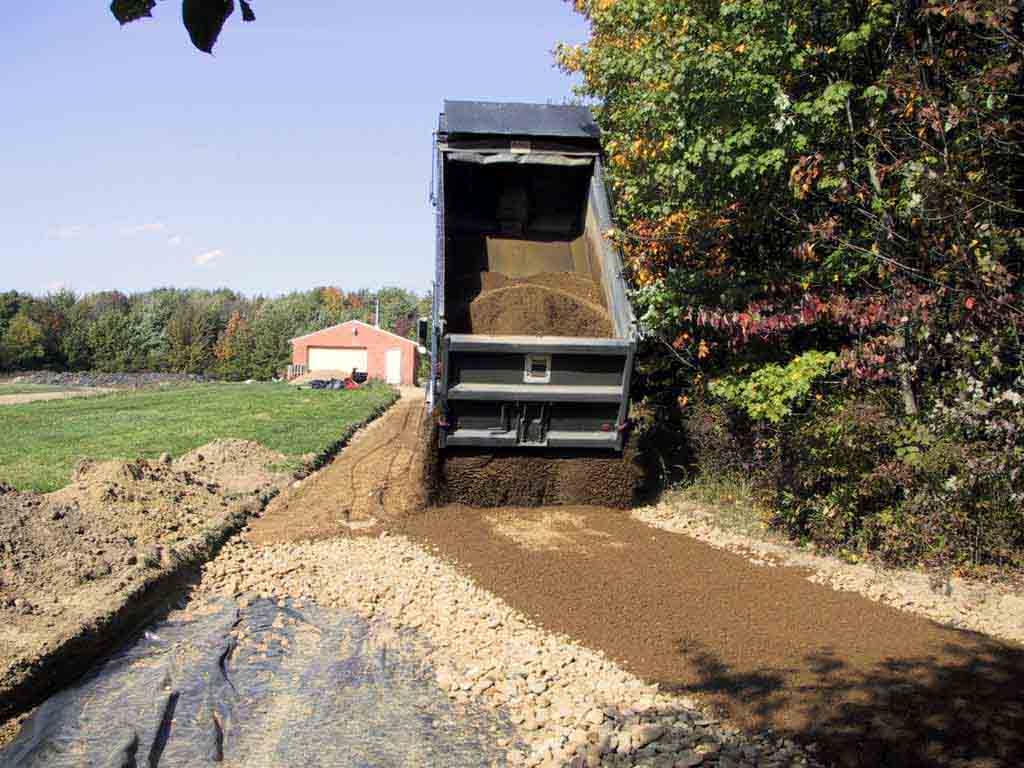

Last year I put down about 4" to 6" of No. 2's (fist-sized) on top of my fabric and then topped it with 4" to 6" of crusher run. The No. 2's gave the crsuher run something to stick to so it wasn't sliding all over the fabric and the fines in the crusher run worked down into the No. 2's to lock them in place. Eventually the top layer of crusher run was only about an 1" or so thick. It's getting to the point where I need to add another layer of crusher run to top coat it.
