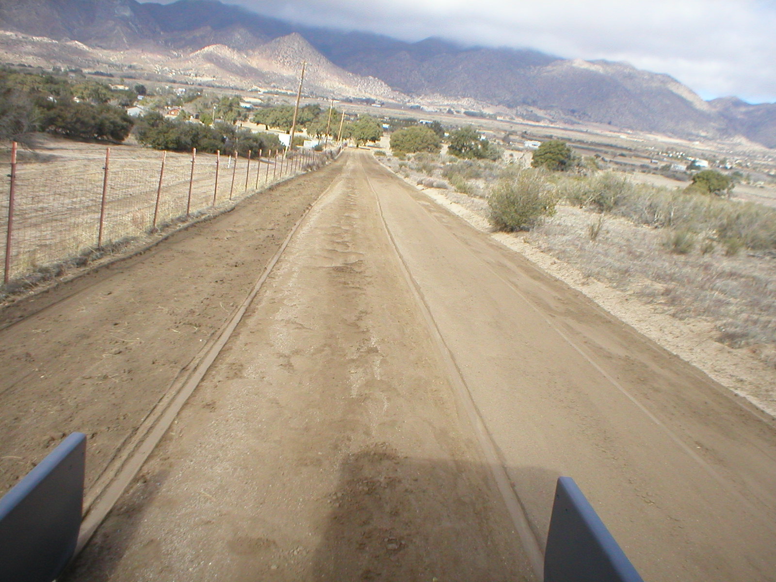

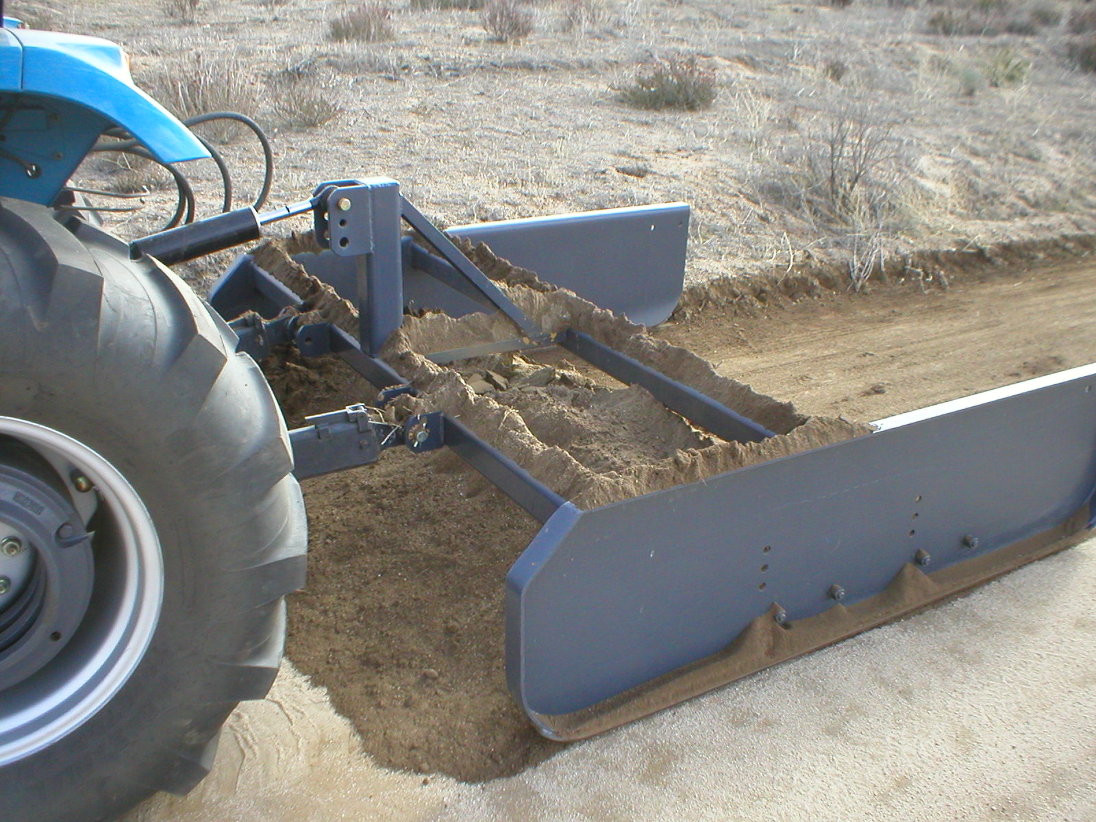

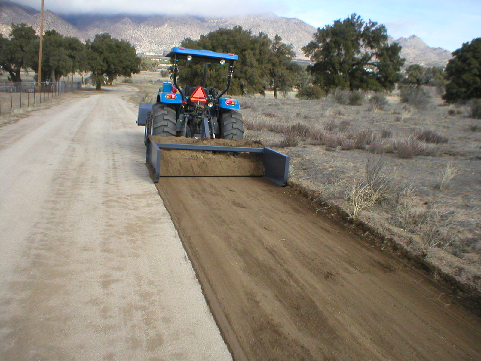

My grader blade works great for me. Not sure what works good when you have to deal with rocks and such. Typically heaver is better when grading, so you need to keep that in mind. If you search TBN you will find more threads and pictures on this topic.

Thanks. I've been poking around other threads and there is some great info. Unfortunately for me my driveway has as many rocks as yours does sand. arg. Some of them are poking out and are so compact I have thought about renting a mini excavator with a hoe ram to bust them up. I would rather put the money toward an implement that I will own. And that grader in your picture looks almost identical to what I saw today. Has anyone else used something similar but with lots of hard pack gravel and protruding rocks?
