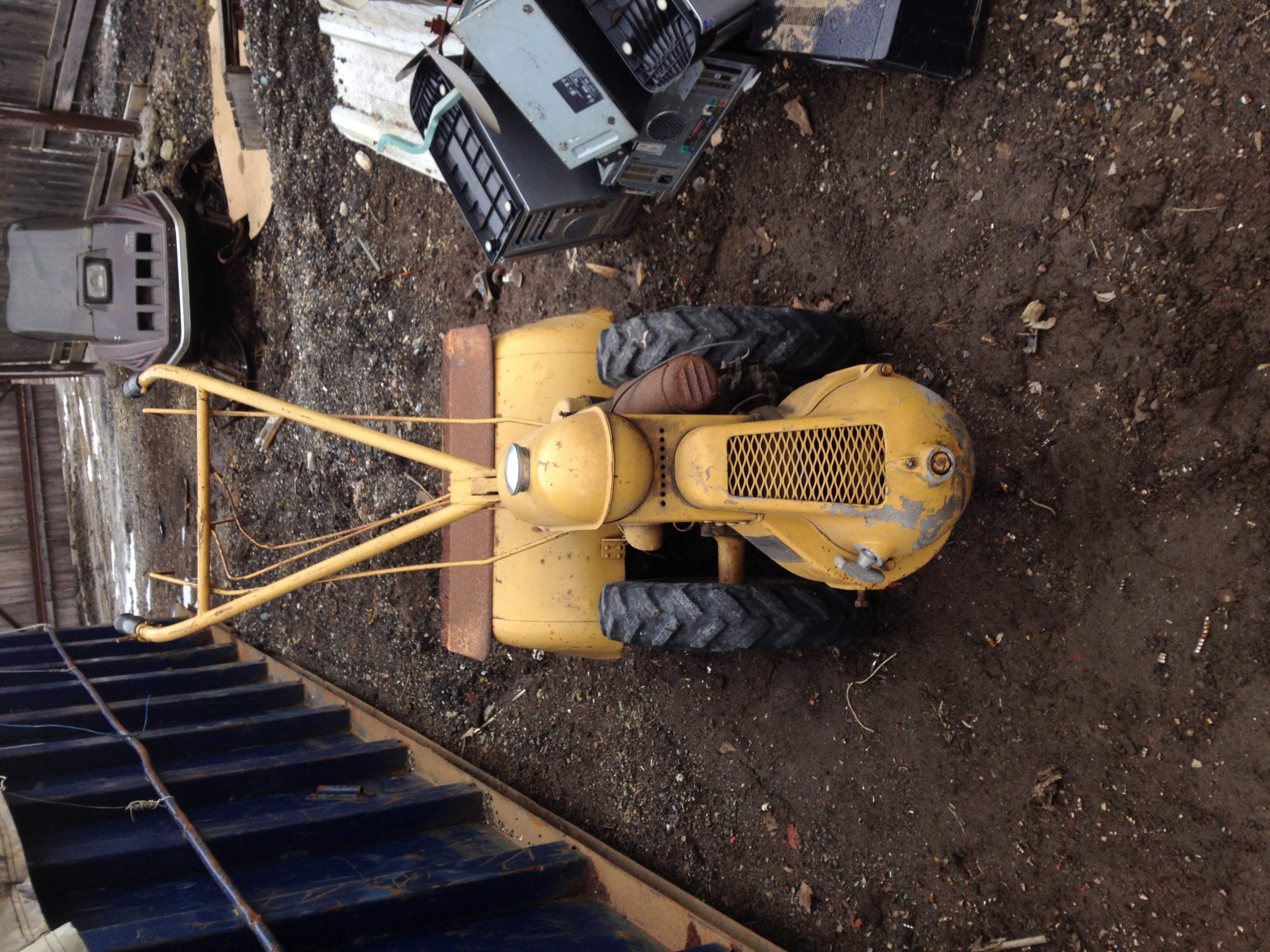

I found this rototiller at the local scrap yard in very good condition but missing the magneto.
Looks to have been under cover it's entire life, the gas tank is clean with no rust & the engine turns over easily.
Anyone have any info on this or it's value?
I feel I may need to save it from the crusher!!!

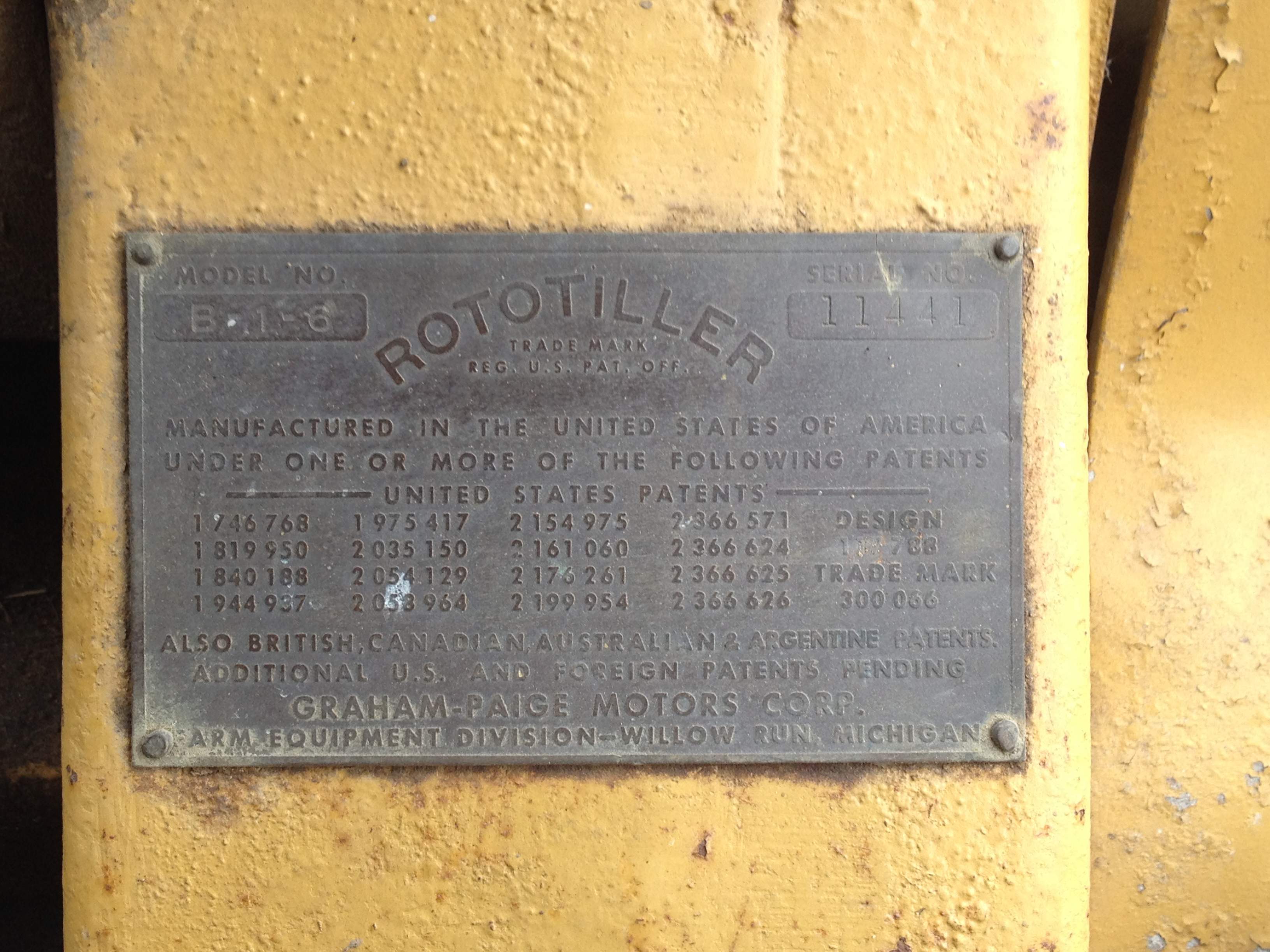

If you search for Frazer rototiller you should find a lot of info. There is a still a guy in Ft Wayne In selling parts. Watch Ebay.
I've had a Frazer for close to 35 years now. I finally put a hole in the piston and am saving to buy a new one. Best tiller ever built IMO.

I went back to the scrap yard & bought it for $100.00 I couldn't let it be destroyed. It weighted 435lbs and was sold for scrap value at $0.229 per/lb.
Got it home & checked it out briefly, it turns over nicely and looks to need a spark plug, magneto and two tires.
Anyone have a magneto for sale??
I will keep you updated on the progress.

Hi! May be you can replace your missing magneto by Gravely L model magneto.
Inside magneto they are breaker point. These one must be clean and bright and adjusted to .015 in.
Magneto must be timed with engine piston 30 deg. ahead Top Dead Center TDC on compression stroke.
Good Luck Oldmech
