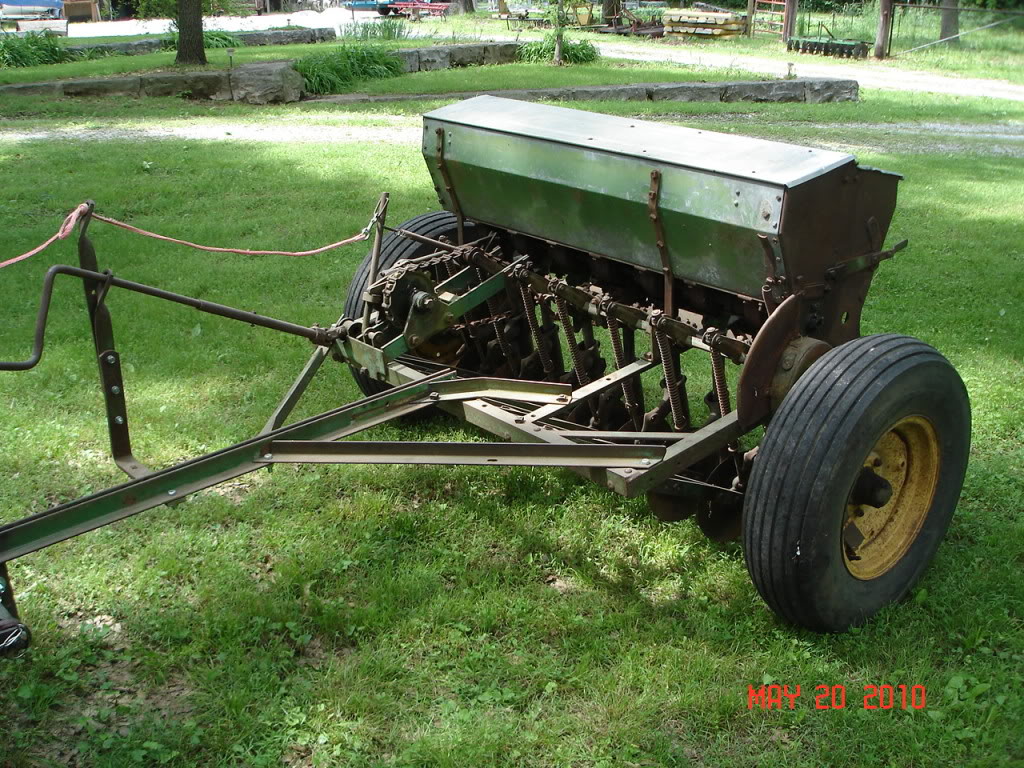

looking for some advice on grain drills? How is fertilizer used with grain drills? What is the difference between a $500.00 used grain drill like a john deere Van Brunt Model Fb "A" 13 hole grain drill (this is the one im looking at buying) and a no till planter. Is there a major difference in soil preparation? Thanks guys for any help, I know very little on this subject..
   / Grain drill for food plots. #2

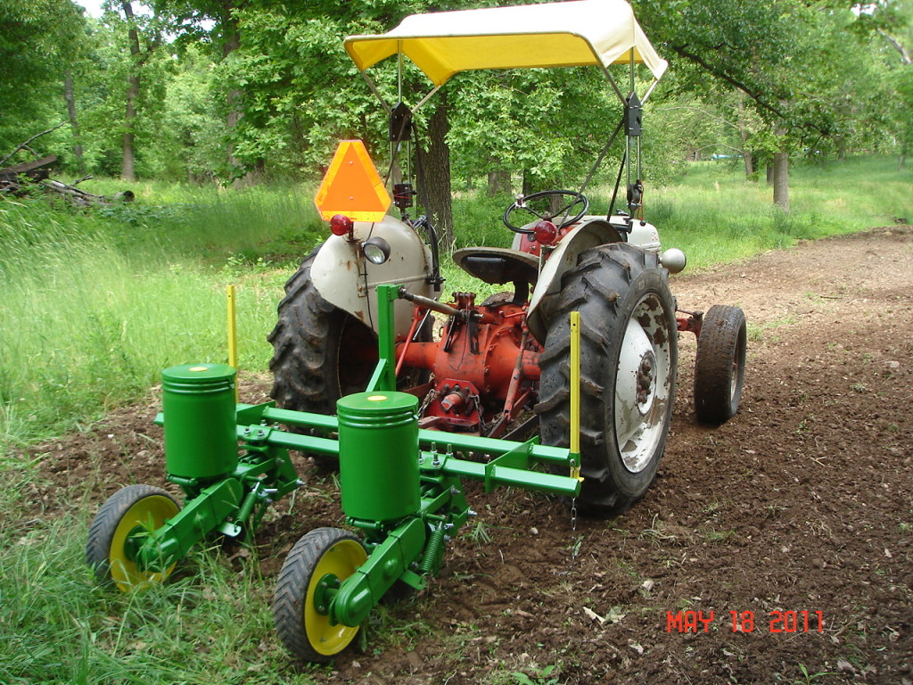

On the FB drill, fertilizer is loaded in the back box. Desired rate is applied by opening the gates. The fertilizer will feed when the seeds are drilled. The drill will need a prepared seed bed to plant into, the no-till planter will plant with minimal or "no tillage" required. The drill you're looking at will plant small seeds in 13 rows at 7" spacing. The no till planter may be adjustable for row spacing, can plant larger seeds, and will plant as many rows as there are units. Some things to look for on the drill, is the drive gears on both wheels, the fertilizer drive could be rusted up, holes in the seed and fertilizer boxes. The pictures show a JD 2 row 70 Flexi planter. It's not no till, but maybe you can see the difference of a drill and planter. The other picture is my food plot drill, a 7 X 7 JD/VB drill. It was a 15, cut down to 7. HTH Mark

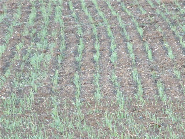

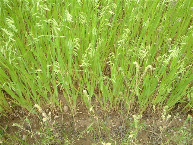

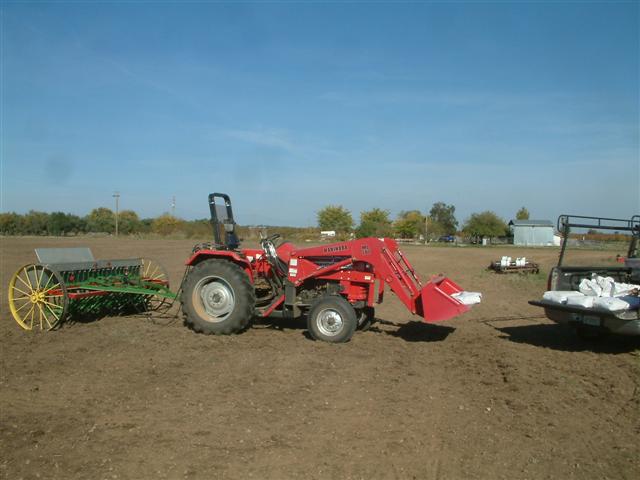

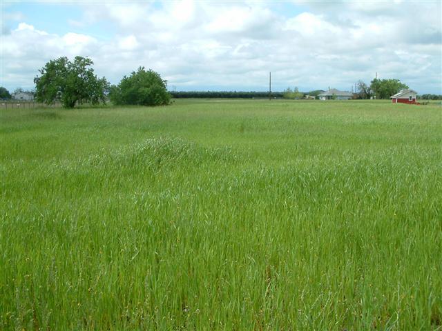

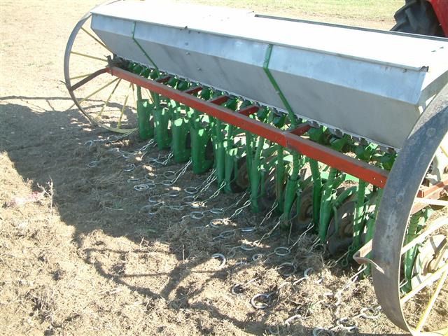

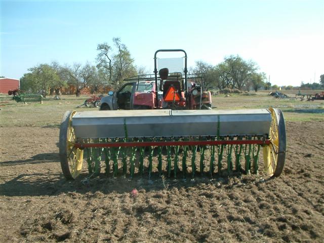

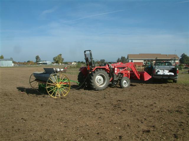

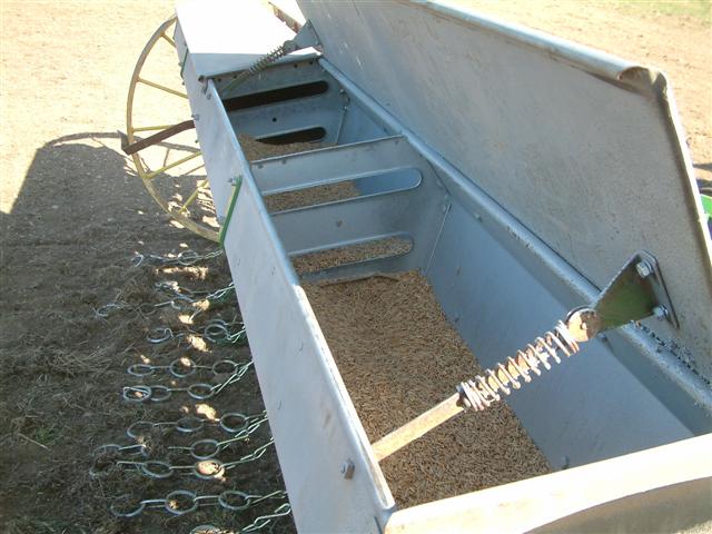

Here are a few photos of the Minneapolis Moline P3-6 grain drill that I restored and use to plant my 6-acre hayfield (Kanota oats). It's 10-ft wide, has 20 hoes/drop tubes (so the rows are spaced 6" apart). Cost me $275 for two of these. I used parts from both to make one good drill (the other unit is now lawn art). Spend about $200 in parts (fasteners, mostly and a hydraulic cylinder to raise and lower the hoes) and about 2 months of time to get the drill field-ready.
DSCF0156 (Small).JPGDSCF0157 (Small).JPGDSCF0158 (Small).JPGDSCF0159 (Small).JPGDSCF0160 (Small).JPG
It does a good job planting oats.
Good luck.
