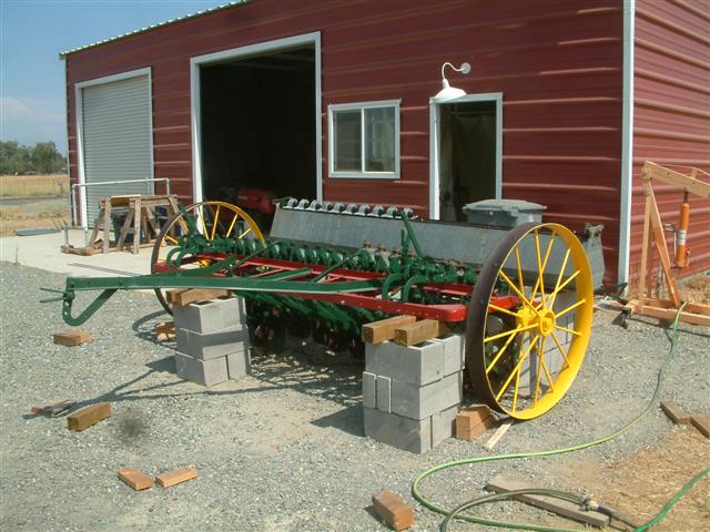

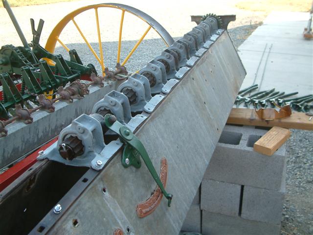

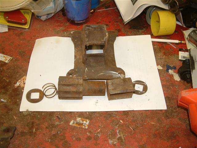

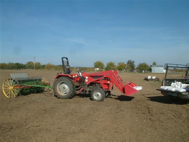

My guess would be that the fluted feeds are rusted into the seed cups. The Minneapolis Moline P3-6 drill that I restored a few years ago had that problem. You could try spraying PBB into the cups.
The cups and feeds on the fertilizer box were pretty rusted
I used Gemplers rust converter on the cups and feeds (leaves a black coating on the metal) and painted the cups with cold galvanize spray paint.
Unfortunately, to fix a severe rust problem like the one I had, you have to disassemble the grill. Not too difficult and a lot of fun:thumbsup:
Used that MM drill to plant Kanota oats
Good luck.
