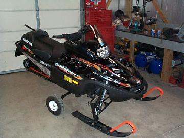

If you want a smaller unit, get the Kubota L3430HSTC. If you want a big unit, get the 5030HSTC. I'm prejudiced 'cause I have the 5030. Do to the fact that you are a Yooper (I don't expect any else to understand this), you need a cab tractor. It gets cold and windy up there just like it does down here in the lower, only more so up there. The air conditioning is nice for those few warm days and the excellent stereo/radio will pull in WJR for your enjoyment. Besides, you will be warm and cozy as you pull my stuck snowmobile out of a drift and chastise me for not staying on the trail which I never do when I ride in the UP.
