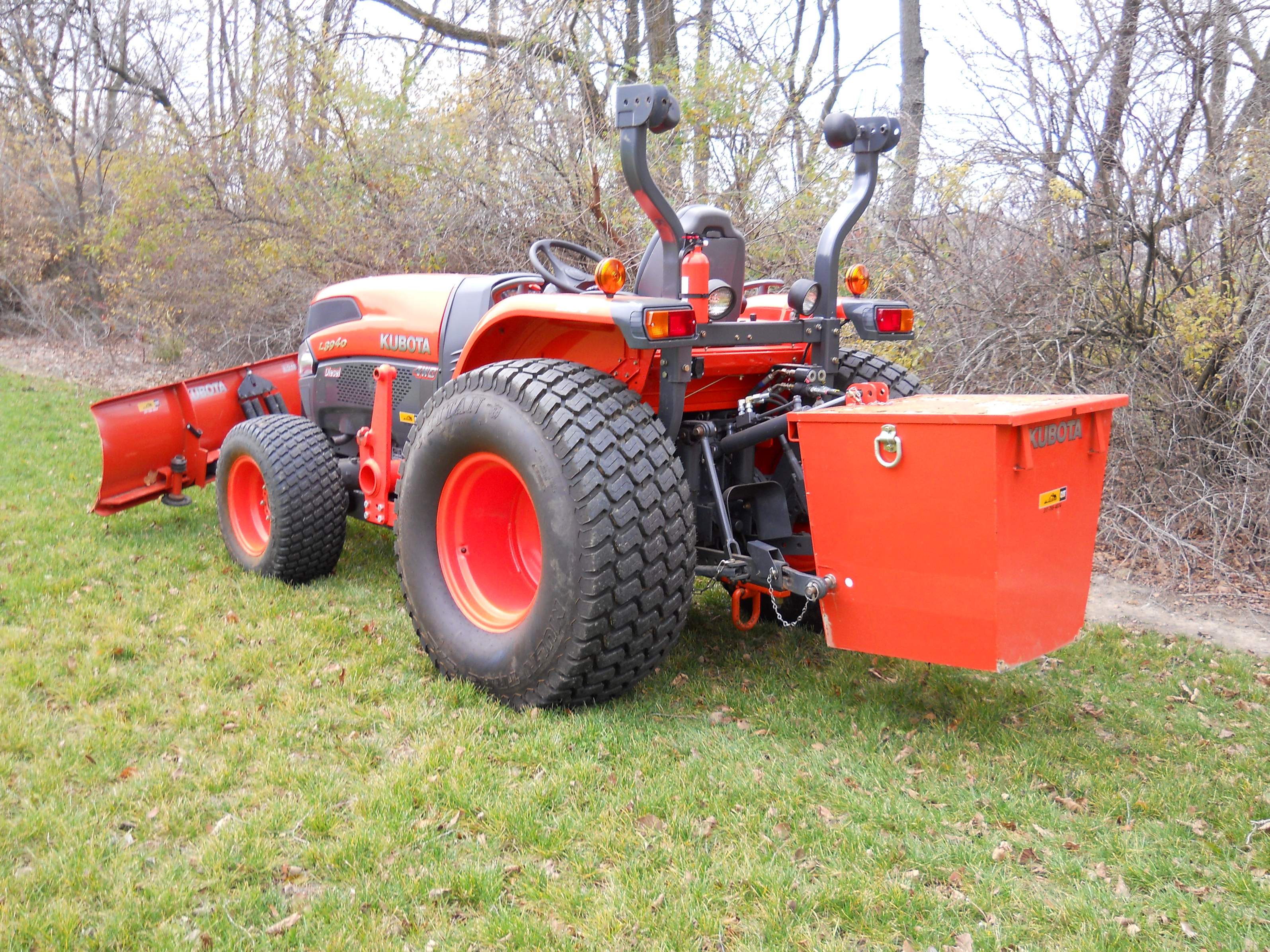

There is (or was) 3 types of turfs offered. One type is standard turfs. No tractor in the brochure has them mounted. They are mismatched tread front to rear, not a very impressive looking tire. The second type offered is the galaxy tire, or golf course tire as I like to call it. It is the same tire you see in SBAKF's post, and the same tire you see pulling the reel mower in the brochure. Very little tread depth, very short tire, but very wide. I have the 3rd type, which is a Titan Multi-Trac. In the brochure, it is on the tractor using the rotary broom. I found this to be a fair comprimise, since most of my work is mowing, some snow removal, and some fel duties. Works great in grass, snow, and dirt. Not great in mud, but it does ok. Rear size is 44x18-20, front is 29x12.5-15. Philip.

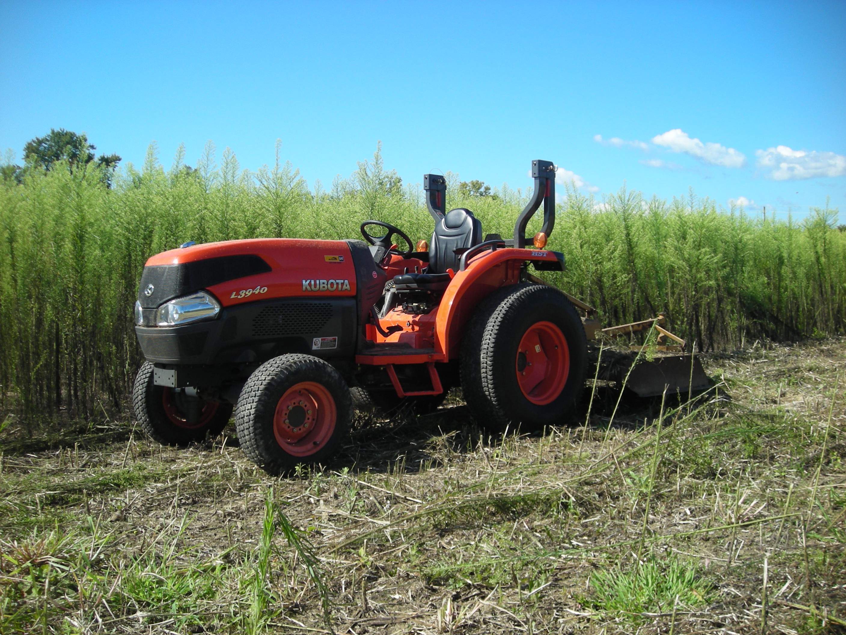

Here is a pic of the standard set of Kubota turfs. When I bought tractor, the tires I wanted was not in stock, had to special order, take about 5 days to get. It had R4's mounted as new rolling rubber, but dealer had a set of used standard turfs on lot, so they mounted those so I could take tractor home and start my bush hogging job. Now you have seen all 3 types of turfs offered by Kubota. Philip.
