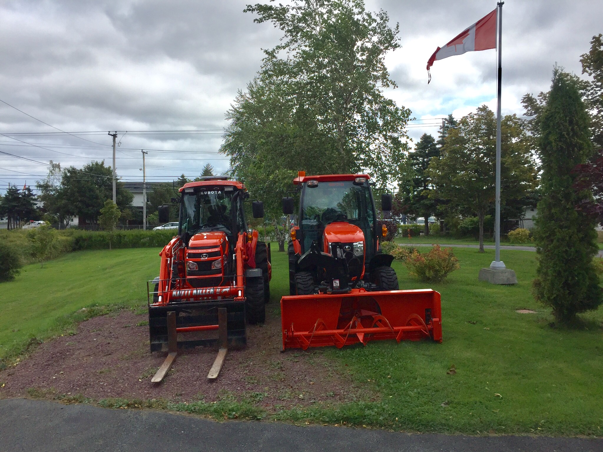

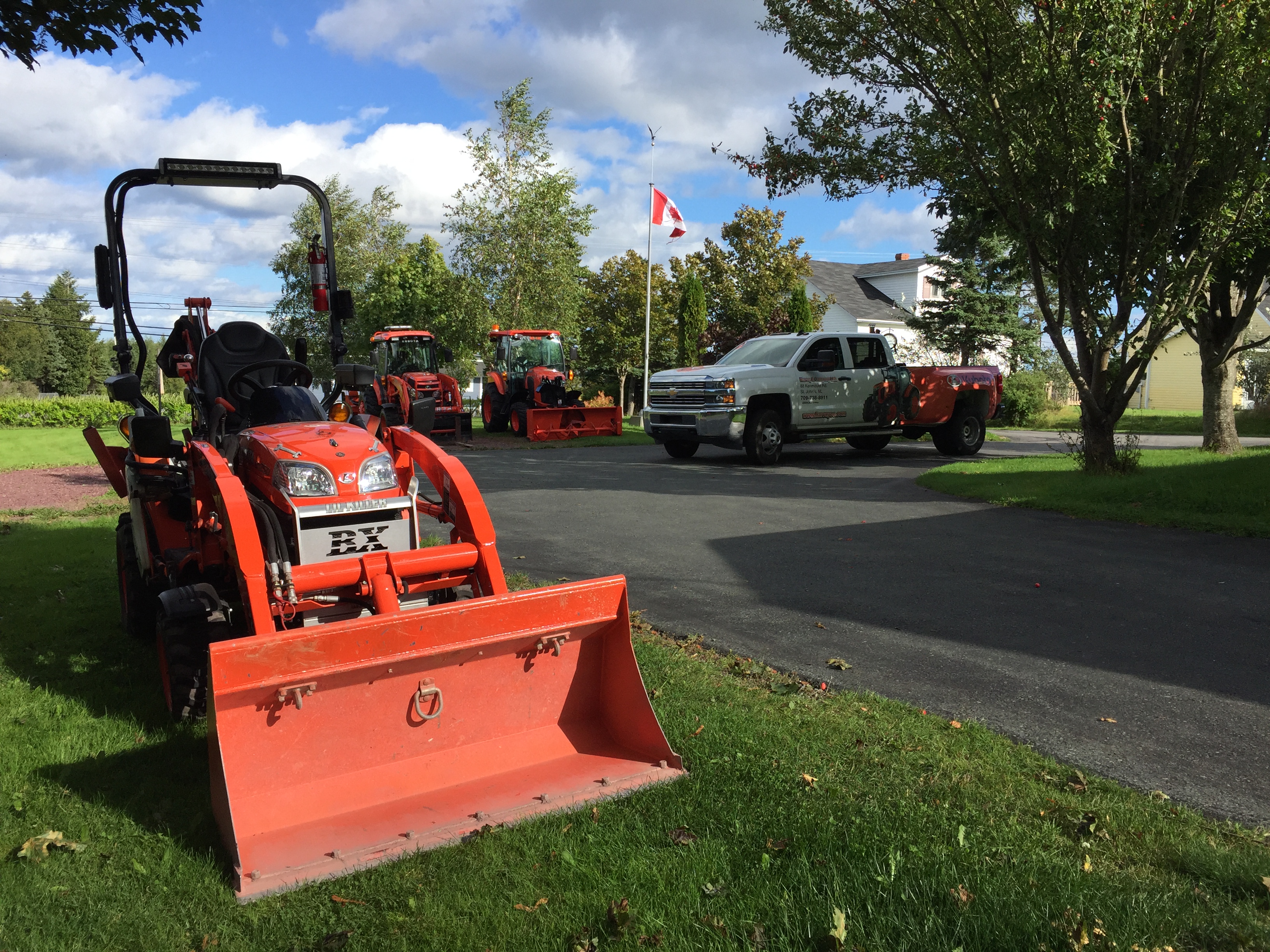

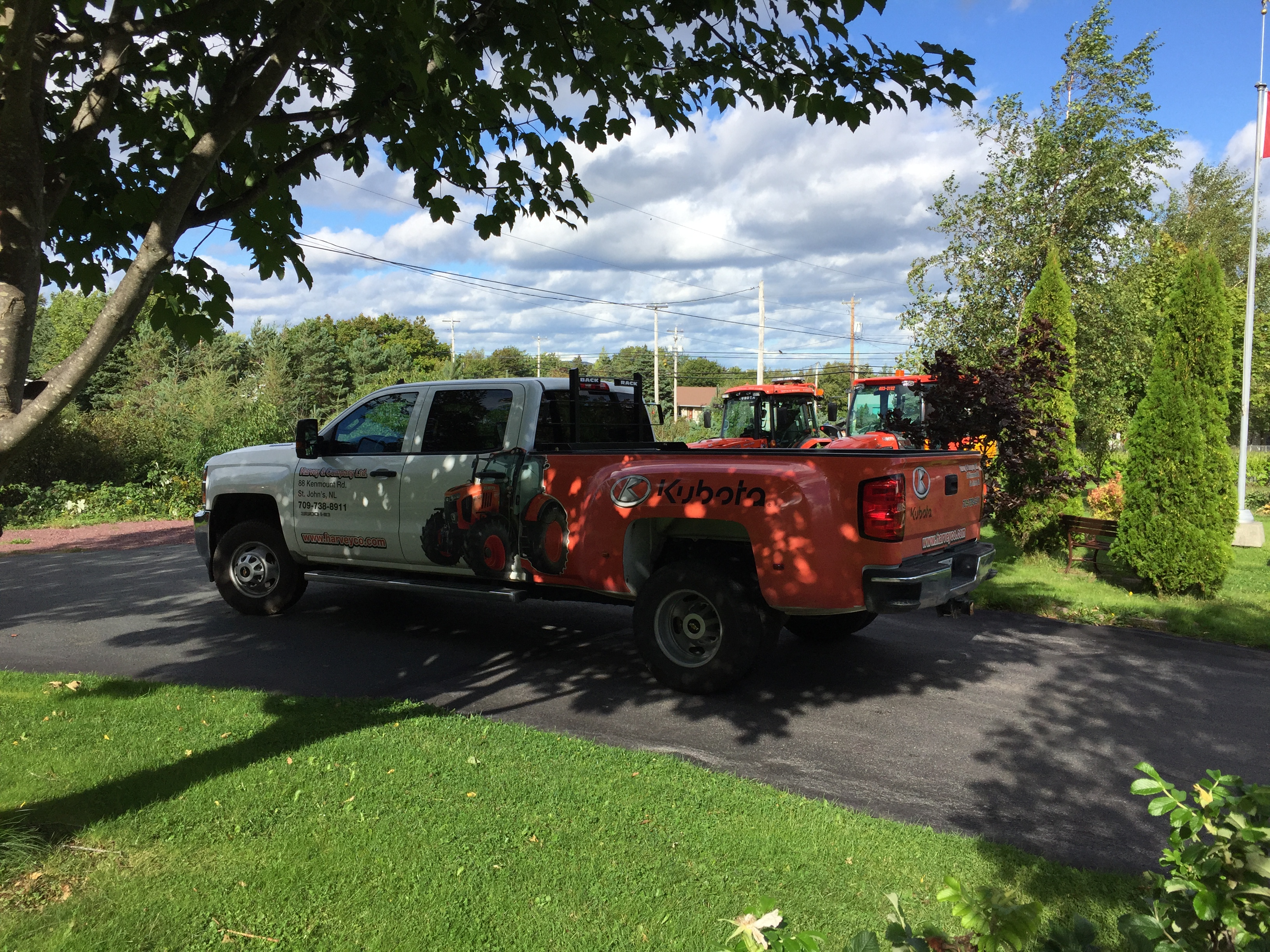

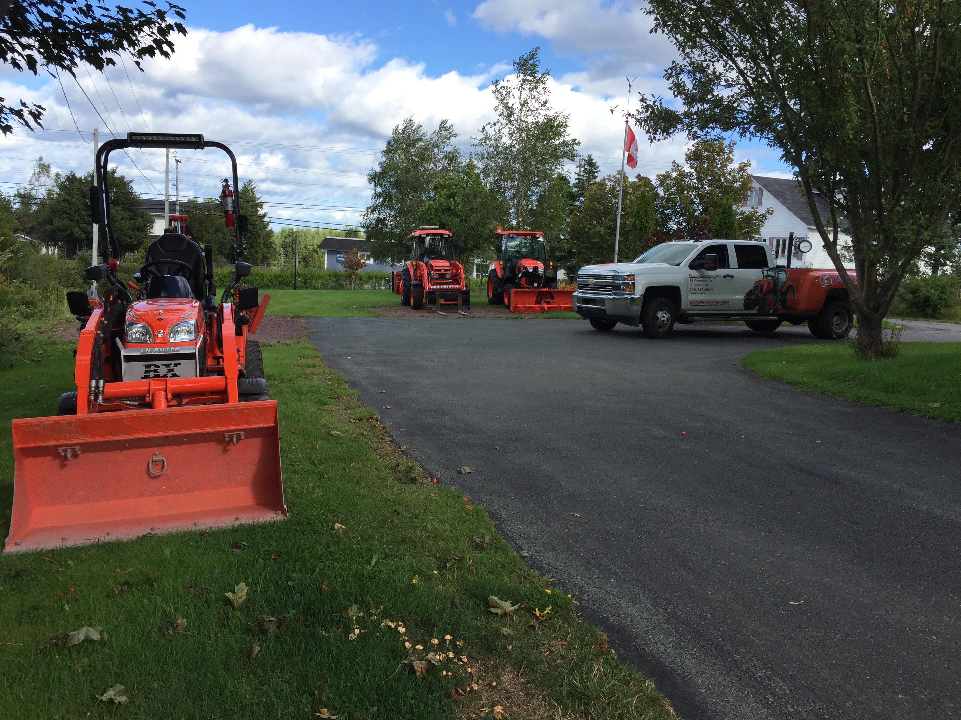

Thanks. Well those situations took both the dealer and Kubota Canada by surprise. Kubota Canada sent reps out along with the dealer to spend an afternoon with us and look and talk about issues we found along with fixes so they are trying to get things right. The issue with the grommet is that it was assembles bone dry so it had to fail at the job it was supposed to do. Here痴 a photo or two of their visit. Keep well.
