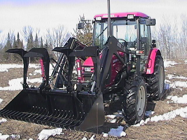

I was talked out of adding a grapple to the dirt bucket by dealer & glad. I bought a 66" rock bucket 2.5" between tines allow dirt to drop thru + dual hyd grapples. Single hyd tend to bend when grabbing something on one end only. Spacing between tines is going to define how much cleanup is left behind. Buy locally if you can as quality construction varies widely. These things can get abused & bent up easily. Loader lift is one thing but you will also be breaking out & rolling items too heavy to lift, pushing & dragging on slopes etc.

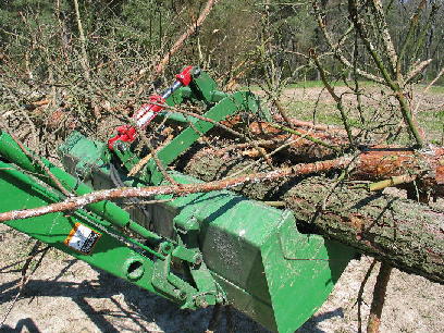

I have the bolt on ebay grapple from Andy in Illinois. It's a big help, and would recommend it, with reservations. I'm going to try to attach a picture, so you can see what I'm talking about. First, I have manure tines on my bucket. They stick out about 13" from the bottom of the bucket, and help a lot. I don't know how well the grapple would work without them. So you may want to consider something like that as well. I do a lot of tree and brush work, but have also pulled a lot of fence. No demolition, but I can't imagine it couldn't do it. Second, I also have a heavy duty bucket. And yet I have managed to bend up the top of my bucket from the rocking back and forth this grapple will do as you work with it. When I get a chance, I'm going to take it to my brothers and weld some steel on the top and then weld the grapple to that. Bolting it, if your doing heavy work, is not the best option. Third, I had to weld a brace closer to the end of the grapple tips to keep them from bending, which I did a few times. Don't know if I have a close up of this, but I'll see. Finally, I have bent the hydraulic piston a little. Still works, but will have to be replaced at some point in the future.
So, it will work, but will take some abuse. IF I were doing a lot of dirt work, and grapple work, I'd have two dedicated buckets. But this is pretty decent for the money. I couldn't imagine doing the work I have done without it.

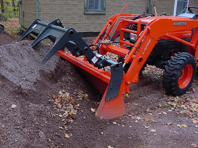

   / Grapple Add On or Grapple Bucket #8
Greg

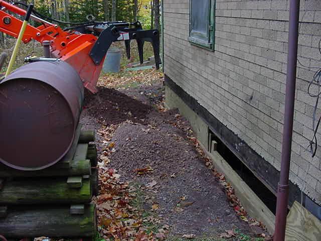

Based on my limited experience, I believe a seperate dirt bucket and grapple would be preferred (except for cost). I have a bolt-on grapple. Attaching a picture where I was backfilling around my old camp and would have liked to dump closer then the grapple would allow.
penokee /forums/images/graemlins/smile.gif
   / Grapple Add On or Grapple Bucket #9
Greg
two more photos - loading out crushed gravel. Grapple not a real problem, but would remove if doing a large quantity of dirt loading.

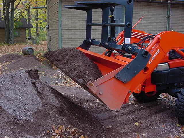

   / Grapple Add On or Grapple Bucket #10
Greg
Bucket filled (never tried loading with grapple in closed position, but would probably hinder getting into the pile deep enough)
