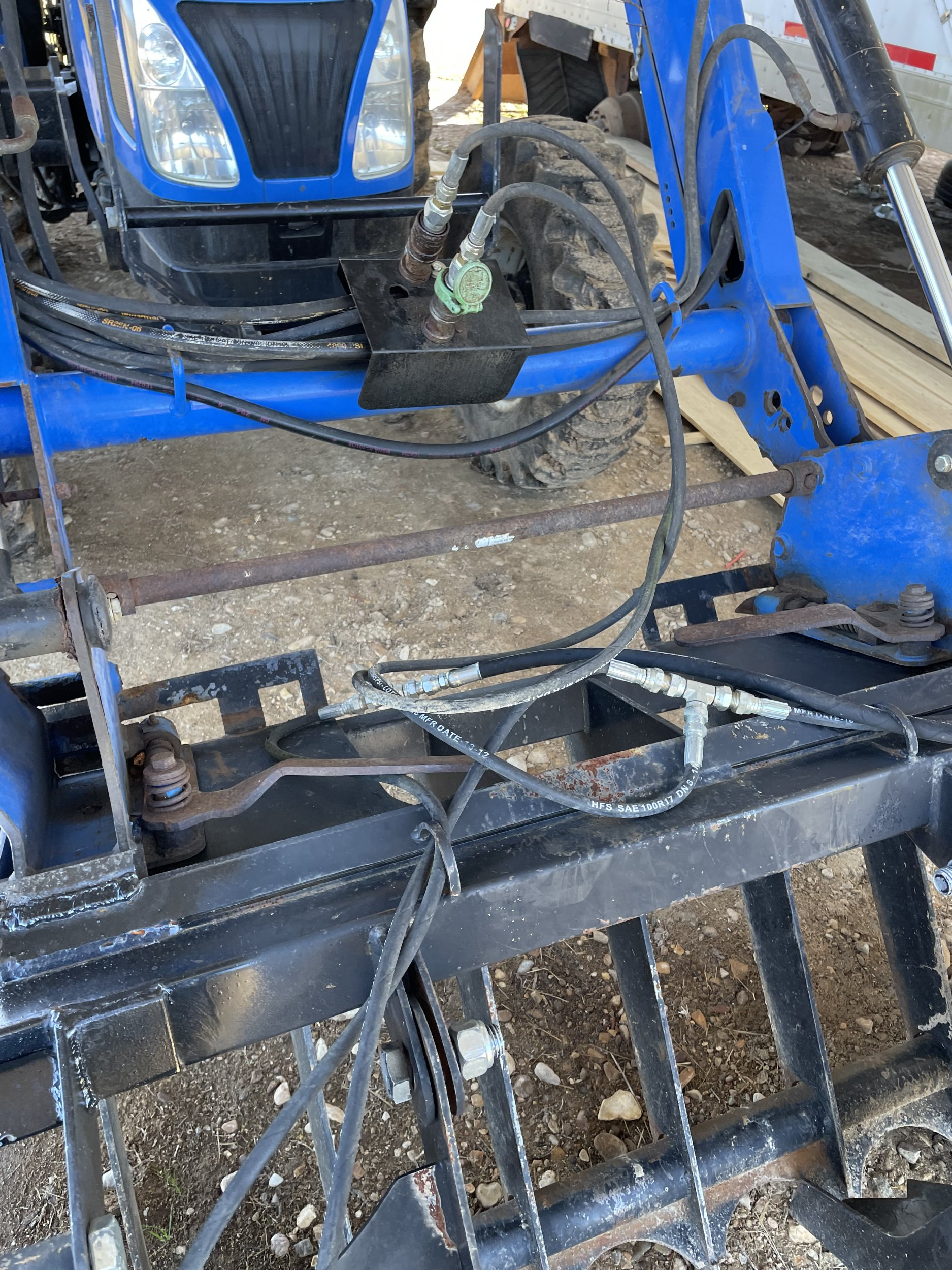

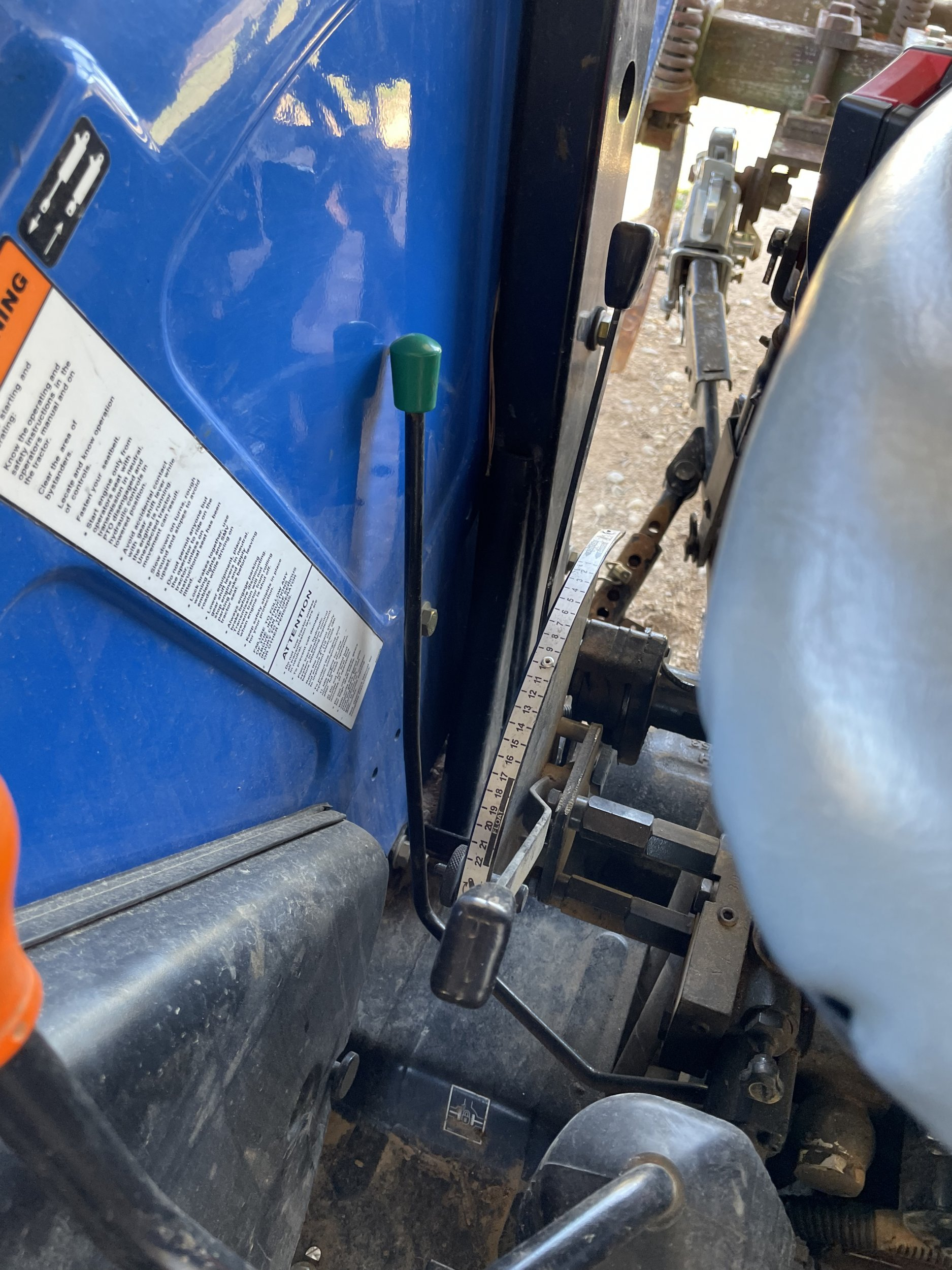

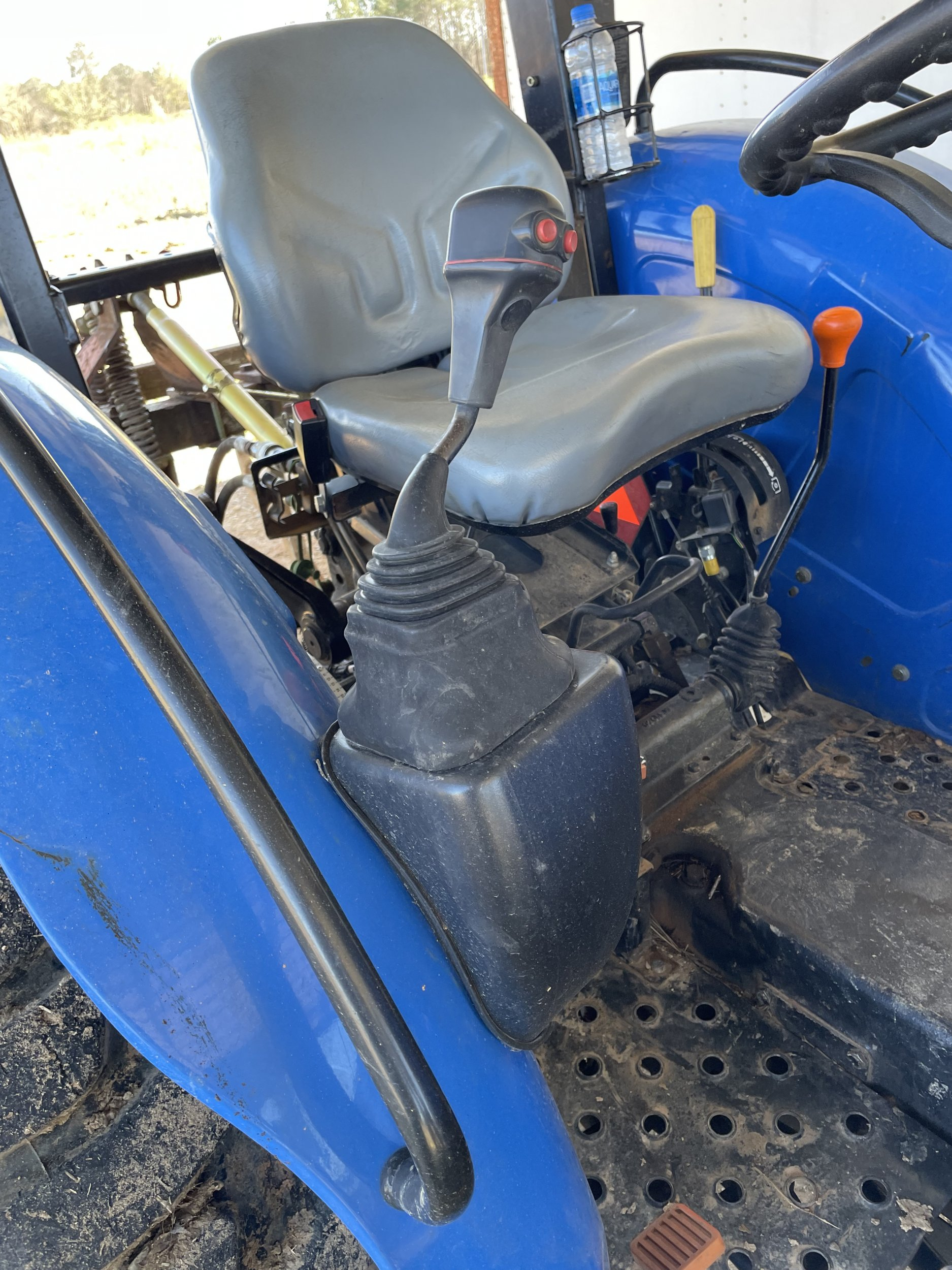

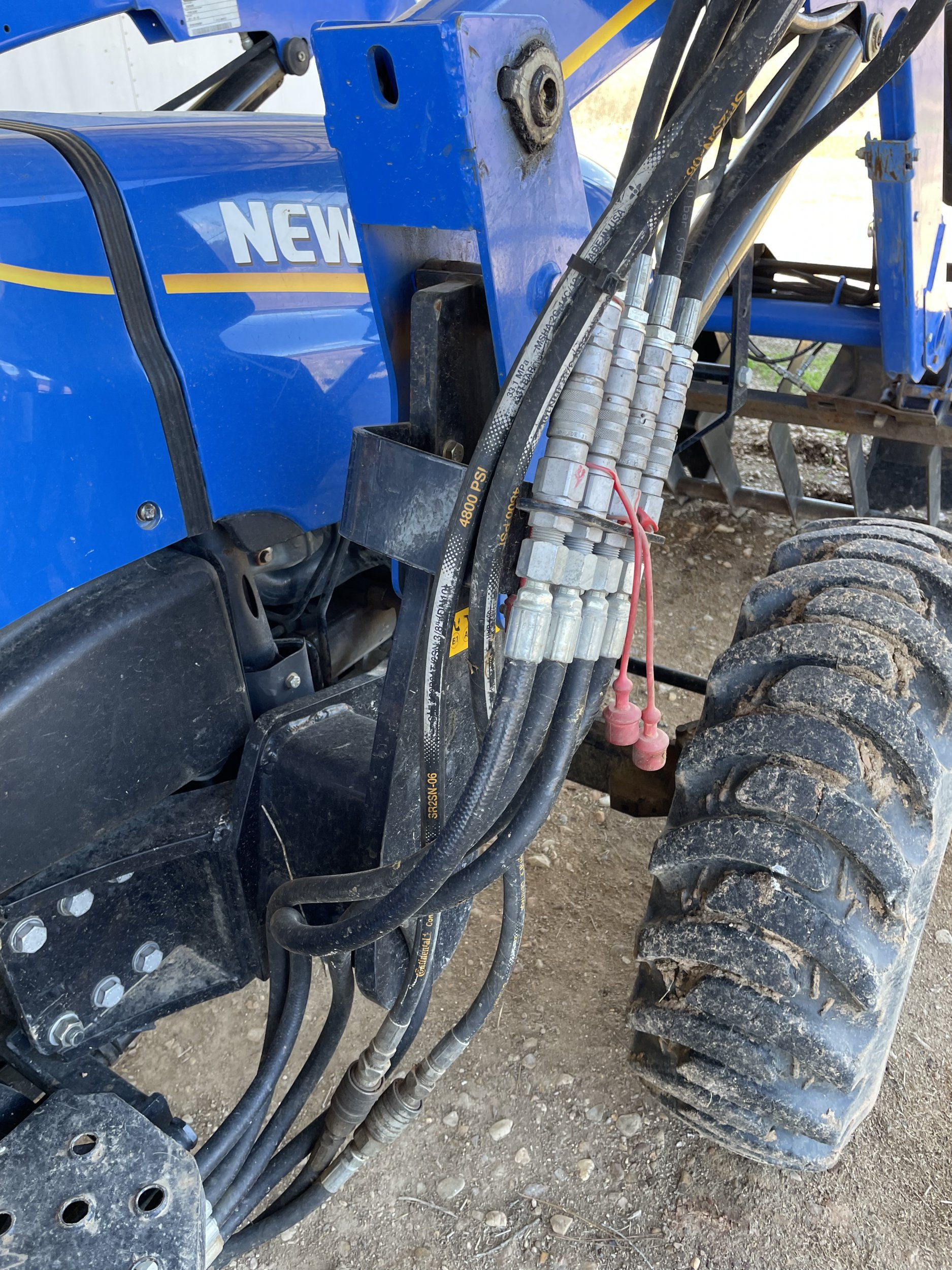

I purchased the 2016 workmaster 70 and was told it had a third remote. When I hooked grapple up the buttons on the lever want work grapple. The only way I can get grapple to work is by using the green handle lever by right fender. Here are some photos to show what I have. Can someone explain what I’m missing or need to do?

Looks like the green lever operates the third remote.
The grapple hoses should go to the valve that the green lever is connected to.
   / Grapple and third remote #4
Looks like they provided the handle with switches for the joystick. But I do not see the Solenoid valves. It does look like they just plumbed to the rear remote which is the green handle.
Nothing wrong with that but if you want to use the buttons, you will need to get the valves and wiring. It is a personal choice.

First I would look at what they provided.
I see the switches on the joystick. Is the wire for the switches there?
Next you will need a solenoid valve similar to the WR Valve I posted a link to.
It can be mounted anywhere you have room.
You will need fittings and possibly more hoses.
Once you have the valve mounted you will take a wire from your fuse panel to the switch and back to the solenoid. Then you will ground the other side of the coil.
Then you will take off the hose on your Power Beyond port on your loader valve. You then will run a new hose from the power beyond port on the loader valve to the IN port of the solenoid valve. Then you will put the hose that was on your power beyond on the Tank port of the solenoid valve.
It is fairly simple but does require some planning. Of course there is nothing wrong with using your remote.

That is what I was saying. I don't think they are wired to anything. I believe the buttons were made into the joystick for the addition of a third function valve.
It appears that your dealer chose not to use a separate valve but opted to utilize your rear remote. That really should have been a decision made by you not them. Basically they took the cheapest and easiest path to work your grapple.
