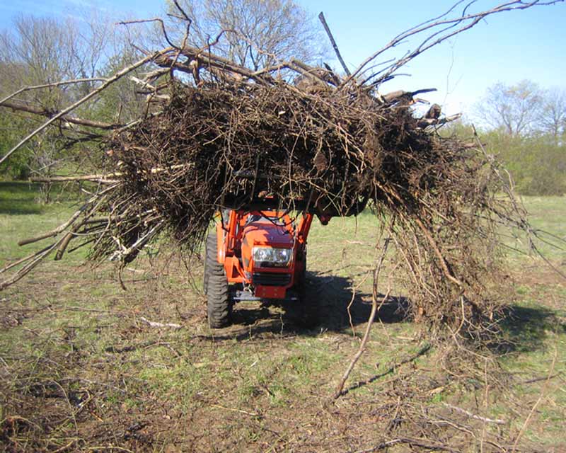

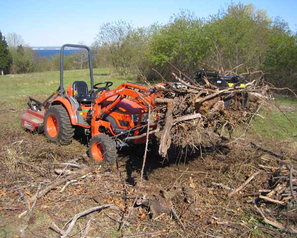

How about a plain ole grapple. They can be had for about a grand and are much more versatile than either a bucket grapple or forks grapples.
Bucket grapple would be my second choice though if brush was involved. I think the forks grapple looks like a nice tool for moving stacked logs and big branches but am not so sure it would scoop up lighter brush or unstacked wood very well.
