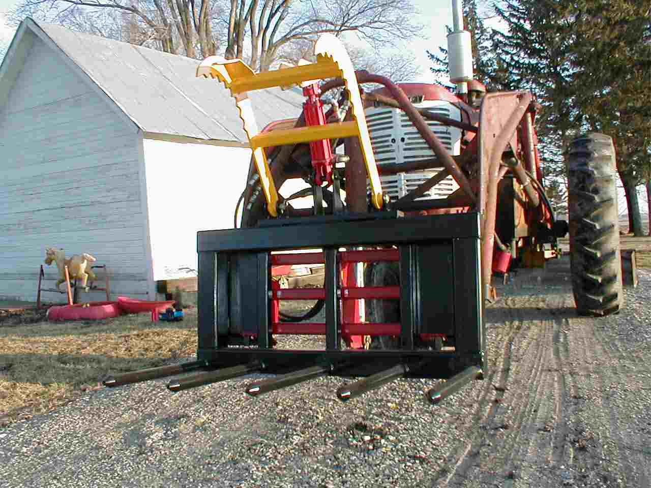

Just thought I would post some pictures of my recent project. I made this using a Iron Horse grapple attachment. This has a Bobcat style quick attach set up. Makes changing it very esay /forums/images/graemlins/grin.gif

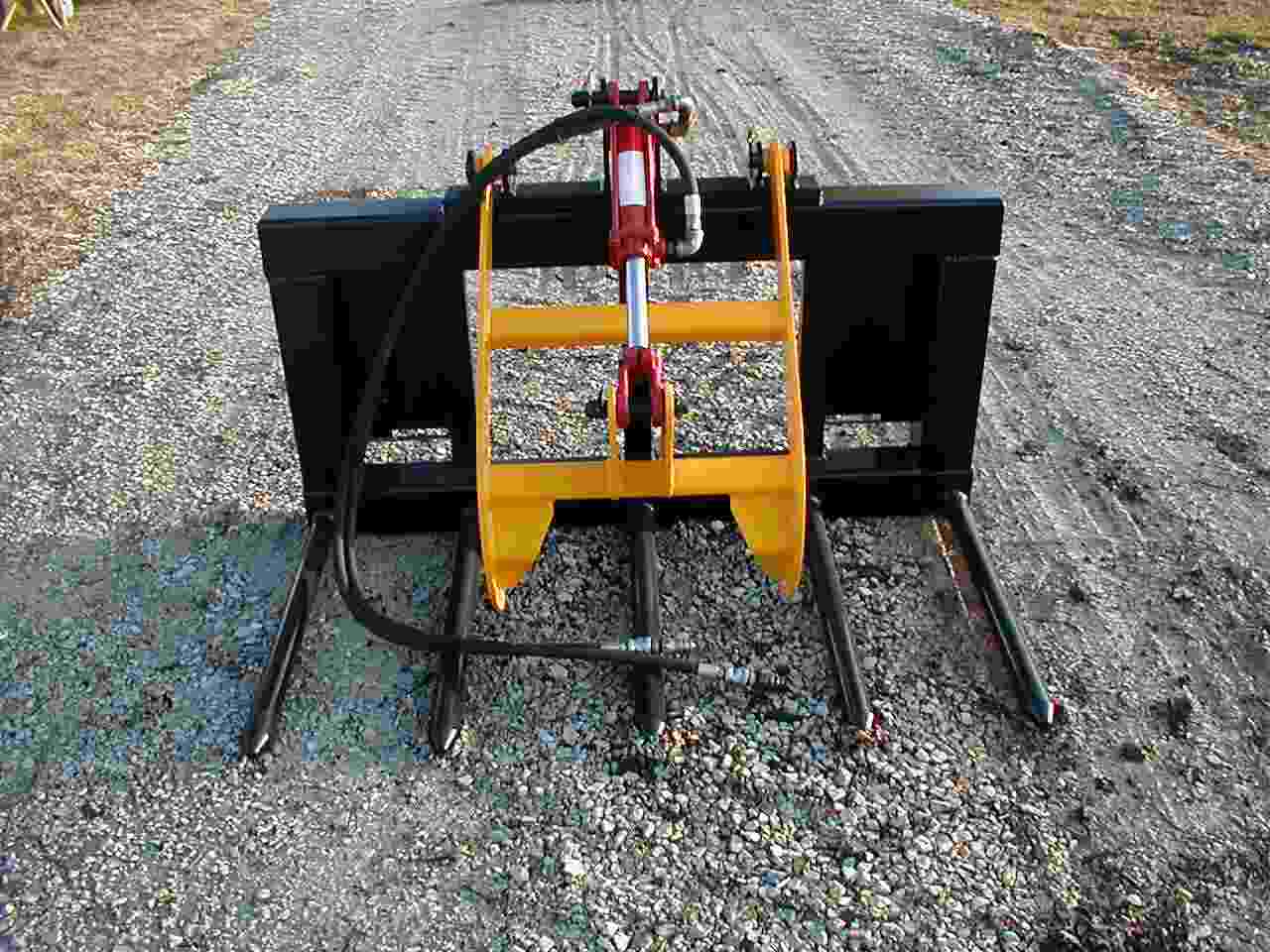

another picture

   / Grapple bucket #4
That oughta do the trick, nice job.
   / Grapple bucket #5
Andy that's another fine looking project. /forums/images/graemlins/wink.gif
   / Grapple bucket #6
Looks good, what did you use for the spears?
   / Grapple bucket #7
Nice looking device, now I know I should paint mine black... /forums/images/graemlins/grin.gif /forums/images/graemlins/grin.gif /forums/images/graemlins/grin.gif
   / Grapple bucket
The spears are made from 1 3/4" crs with the end turned to a point.
