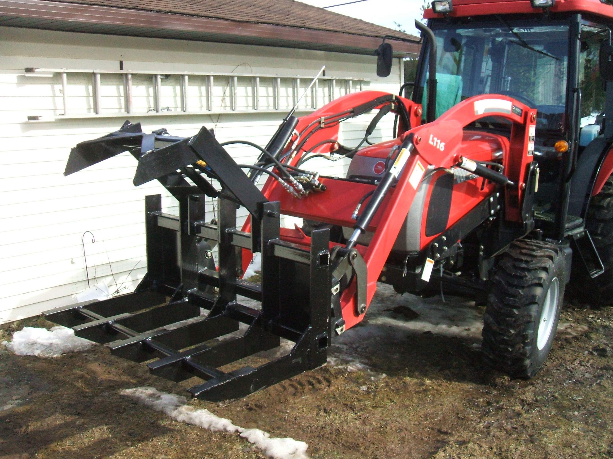

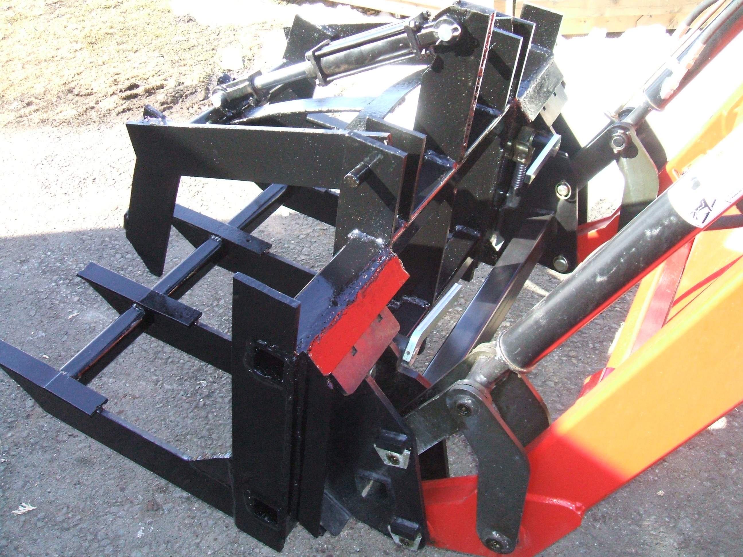

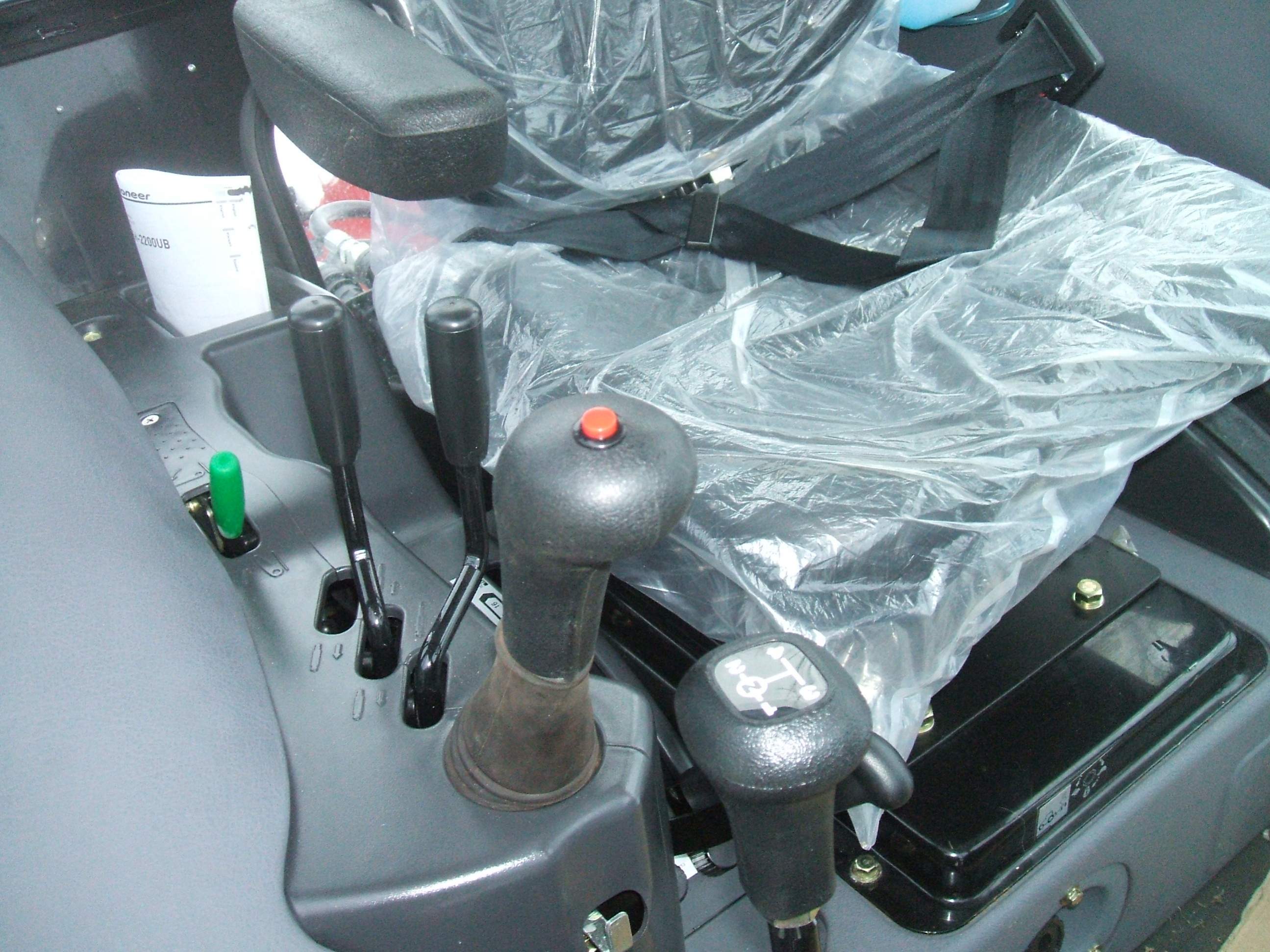

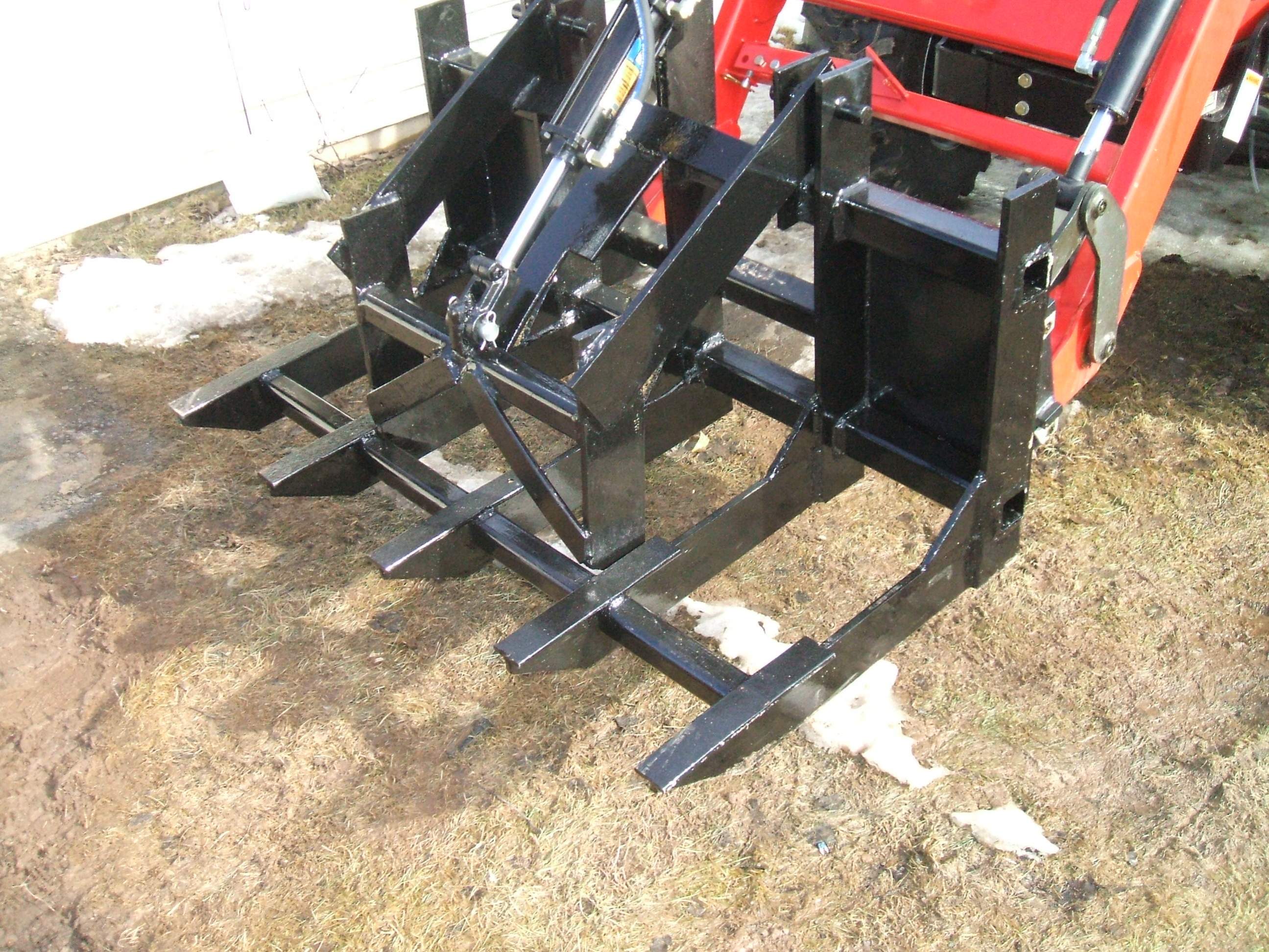

just finished my grapple.I want to thank you guys for answering my many questions .
   / grapple complete
thanks ,took about a week.most of it was fabricating ,chipping ,grinding and running wires for the joystick button and relay.rake all made of 1/2 x 4 steel plate and car leaf springs to strengthen the teeth.I hope its tough enough.I hate doing things twice
   / grapple complete #4
Very nice. You should get lots of fun hours out of that.
