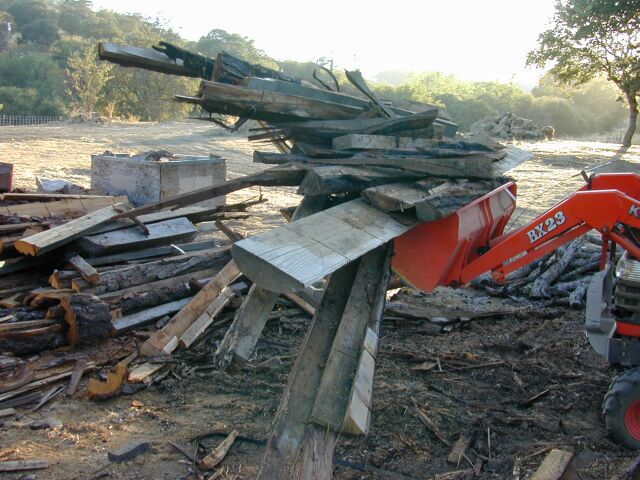

Another option is to make/get a set of brush forks. I eliminated both your choices by doing so and accomplished the same thing, though on a smaller scale. I am able to scooch under brush, logs, etc, and move to piles without getting off tractor. On rare occasion, I have been in bad terrain and have thrown a chain over the pile to transport.
