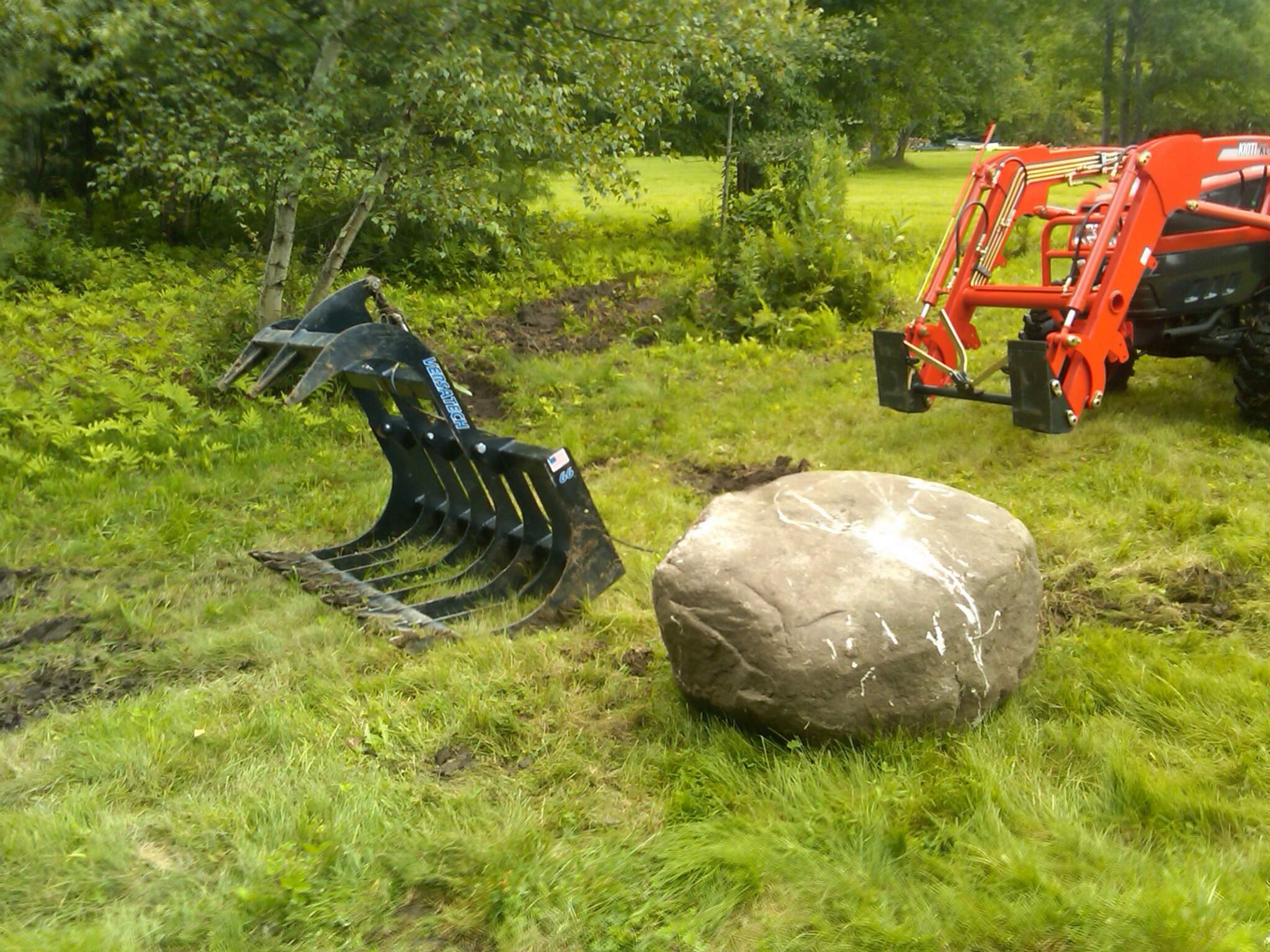

You might have a problem rehooking your hydraulic lines back up as it is now under pressure. Unloosen the fitting and let it out.
Oh I did alright, that photo was taken right after I got the boulder unjammed from the jaws. My first embarrassment of biting off more than I could chew. Shut down, relieve pressure, reconnect, wait for the ground to firm up so I could fill the mucky trenches I made with the tractor. Both my eldest son and wife found me out, but they were gentle on my mistakes...
