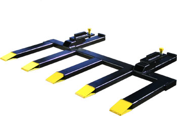

I would absolutely love to own a frame mounted hydralic controlled grapple - for me it would be way too expensive and I would not use it that much.
I just ordered a pair of light duty clamp on forks for Paynes Forks Inc. I noticed they make a clamp on debris forks - which I heard work really well. It might be worth it to take a look a them.
Paynesforks.com - Tractor & Skid Steer Bucket Forks Attachments

Those forks are pretty expensive though (at least through northerntool) and cost about the same as a bucket grapple kit. The only extra expense would be adding the hydraulics which could be anything from $50 if you already have rear remotes to $1000 if you elect to add an electric over hydraulic 3rd function valve.
