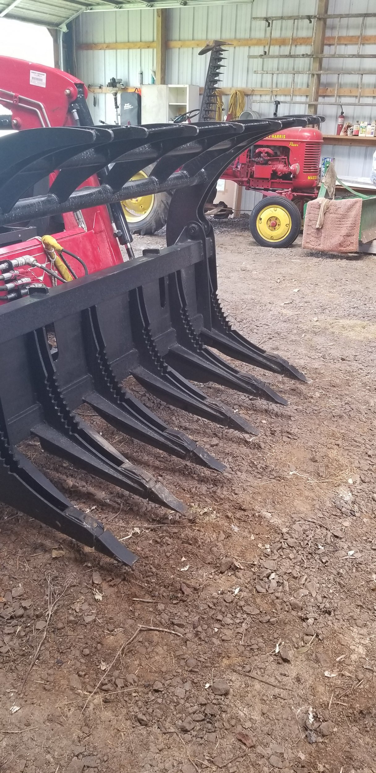

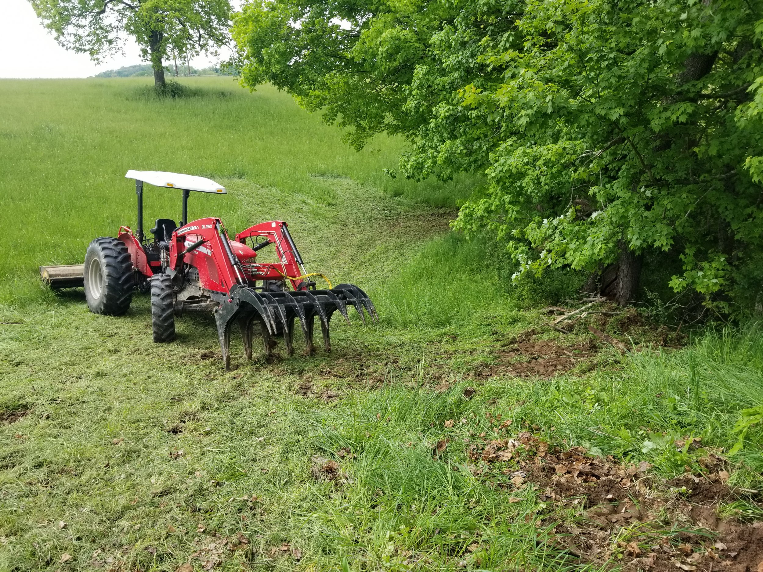

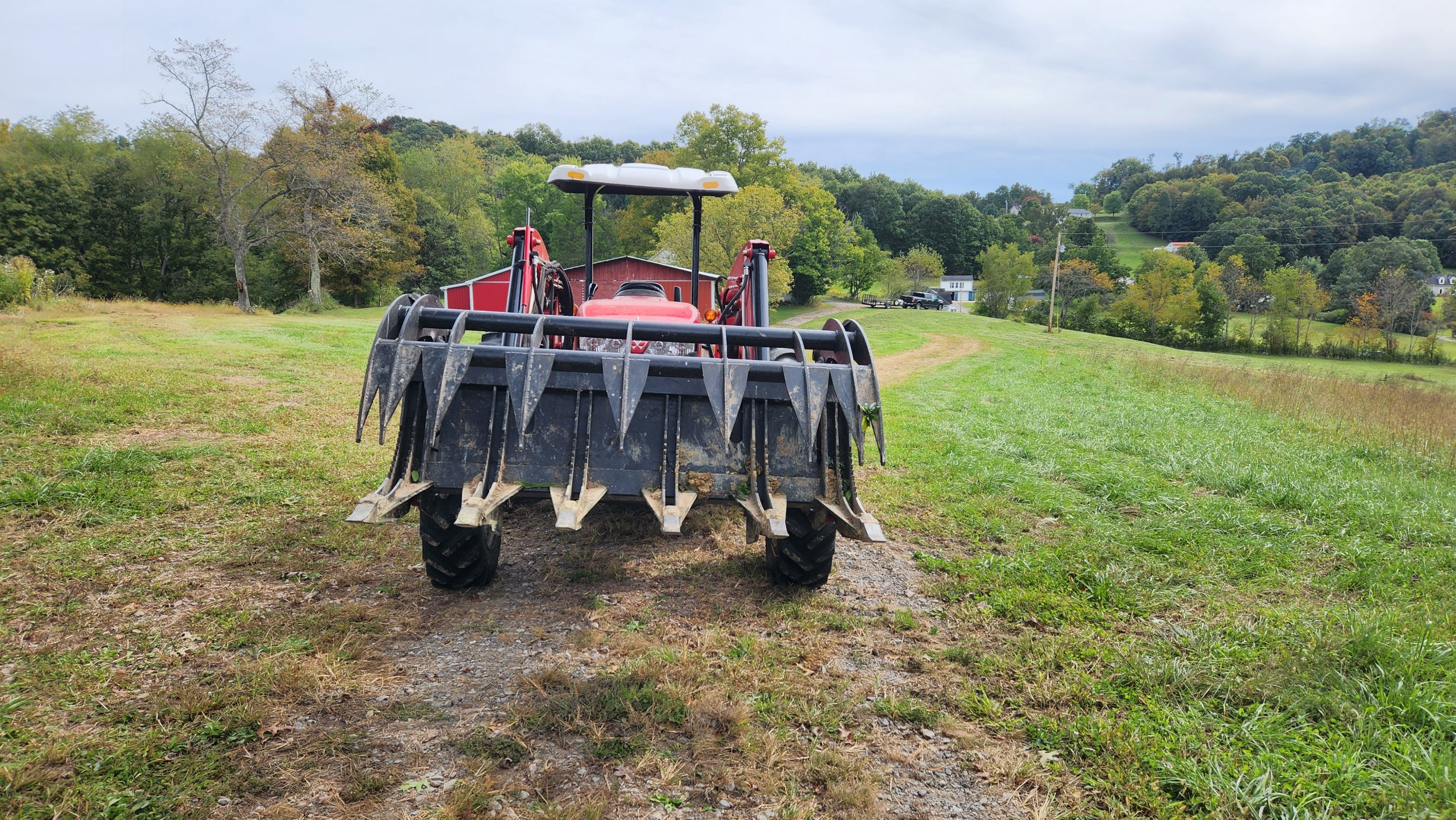

I think you are on a good track with the EA Wicked Root Grapple. They look good on paper and in photos I've seen. I use a Mid-State or Wildkat brand depending on where you look. So many are made around the same town there in the Carolinas and look to be copies of one another. Depends a lot on exactly what you intend to do with it. If you intend to rake for smaller rocks then the one I got has the teeth too far apart. I have found that a narrower grapple (like 5 or 6 feet at most) is much more maneuverable and less of a nuisance in day to day life than wider ones. I say do not get one wider than your front tires outer edges. Mine is so darn handy I almost never take it off and have not put the 4-in-1 pinch bucket back on in 3 or 4 years now because of it. Most of my use is cleaning up an old farm and moving downed tree limbs, tree trunks, and general debris including at times large rocks. Not for raking smaller rocks. A couple of pictures for what ever it is worth:
