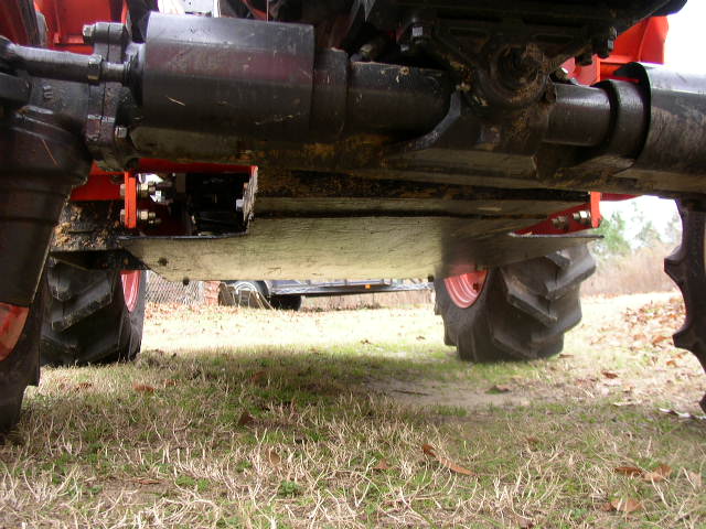

This is a belly pan that I made from scrap that was design to be fairly easy to install/unstall because I did't want any drain holes to maybe grab a snag an maybe go inside an do some damage

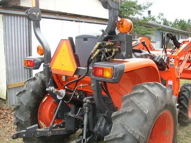

Rear remotes with hydraulic toplink.

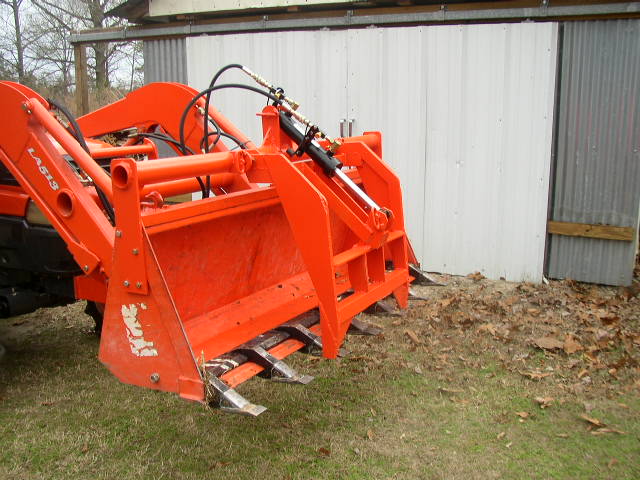

Had to buy a little metal here but even a cheapscape like me has to breakdown every now an again

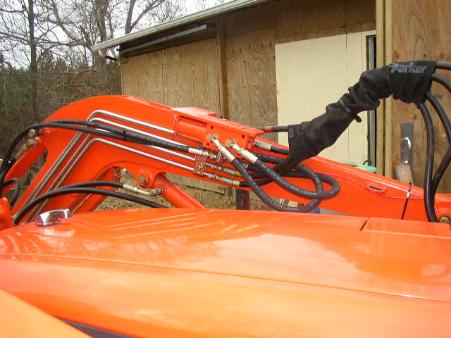

Valve setup

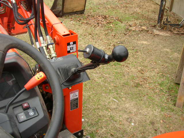

I found a piece of 1/2" metal conduit laying around an brazed apiece of tubing on the side that was big enough to fit my switch,cut a slot underneath,closed an drilled the other end,put set screws in the tubing ,removed the joystick ball an slipped tubing down stick an tighen screws.

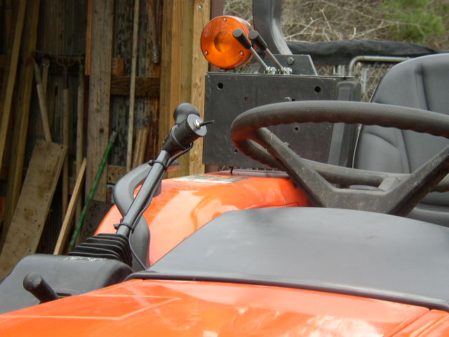

Finally,
another switch view with remote valve in back. The valve is mounted inside a box made from two pieces of u-channel {you
guessed it} [scrap] an mounted to the ROP with u-bolts.

The toothbar in 4th picture,I found it at [partboys.com or maybe partsboys.com] @ 40% off [heavy duty]. Cost me $195 plus $80 shipping.

wow really nice work! ever color coded /forums/images/graemlins/wink.gif though I don't own anything THAT color it is very nice one though. anyhow good job on the idea for the diverter switch location right on the joystick. no fumbeling there! /forums/images/graemlins/wink.gif

Slick looking set up, especially the grapple. The belly pan is nice also. I do a lot of slash and log retrieval for fire mitigation and use a Power Trac which has a slick belly and it just slides off of stuff that would have snagged or damaged my regular NH tractor. Nice work!
