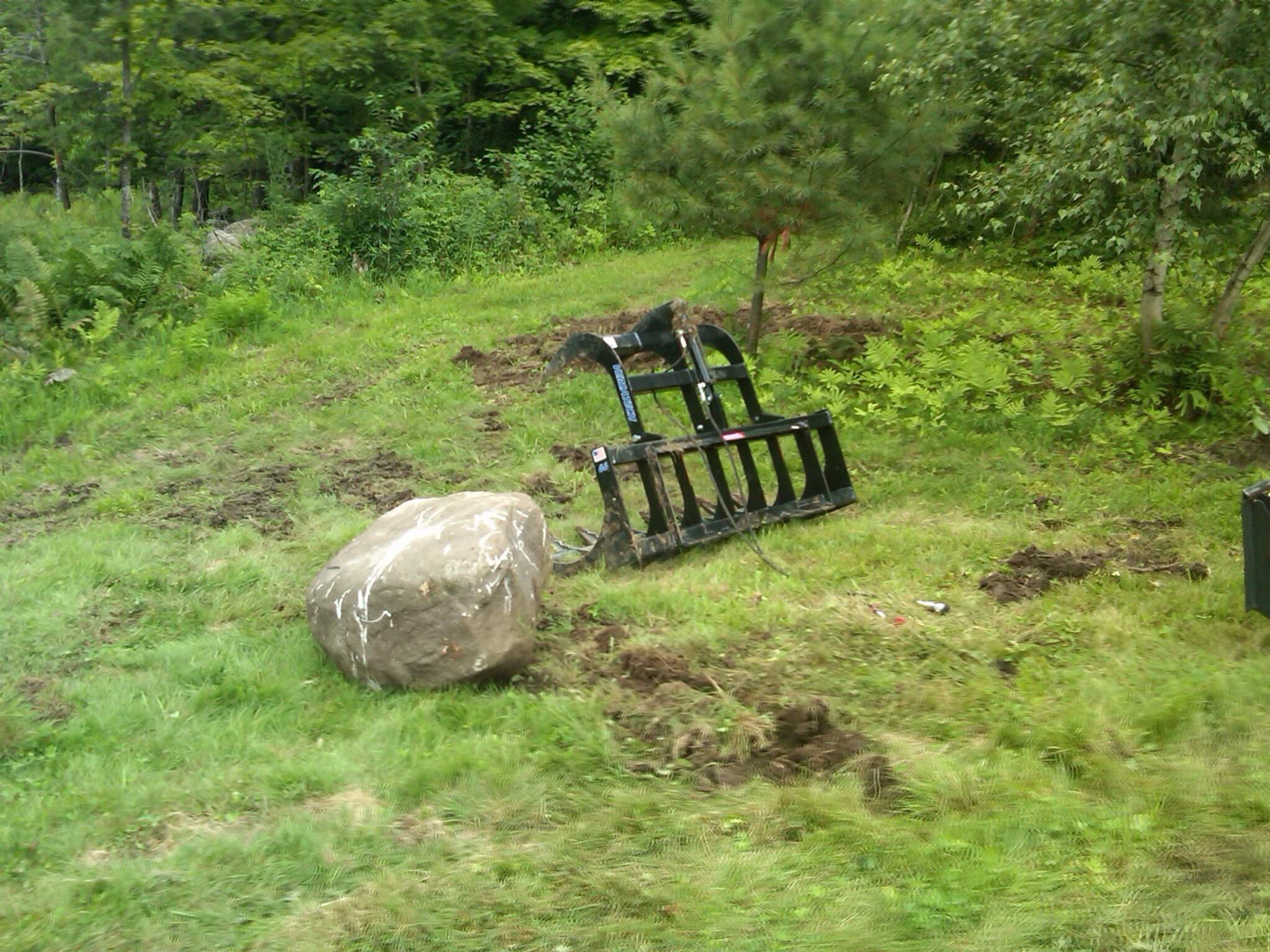

Grabbed onto a pretty hefty boulder, then the cylinder on the grapple wouldn't retract. Was light in the rear (forgot my handy dandy new ballast barrel). Got stuck in a wet spot, so could only dump the grapple in the woods, drag it to a better spot and clean out the connectors tomorrow, what else to check?

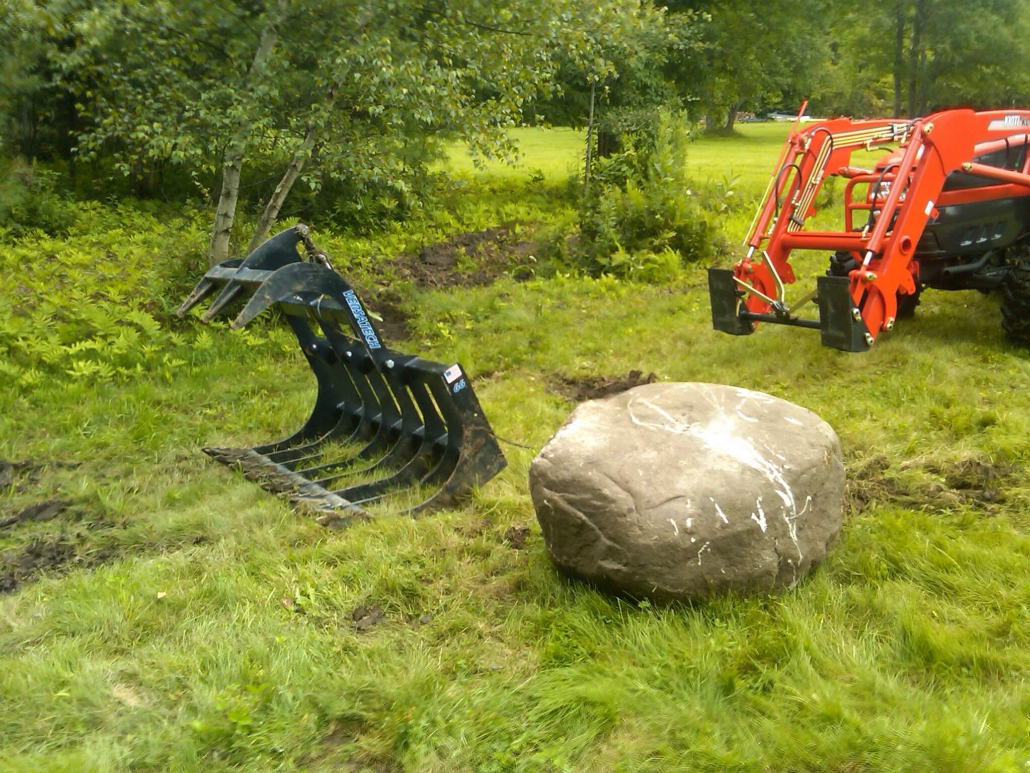

Update...
The hydraulics were fine, the grapple was lying on its face when I dropped it so didnt have good perspective. The boulder was on its elongated side, and it was jammed against the teeth on it was fully retracted, open as wide it would go, and the boulder couldn't move. After tugging with a chain and it wedging in even tighter, was gonna take off the bolts and free up the rock. Then HRH (Her Royal Hotness) also known as she who is smarter than me, told me to lift the grapple up with the bucket and see if I could jiggle it free. Pshawww, already lifted it it wont move... Dropped right out after a few shakes.
Why do women stick around when they are so much smarter than us? Pics tomorrow, after I listen to her explain how to use her camera...:cool:
