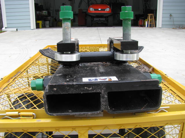

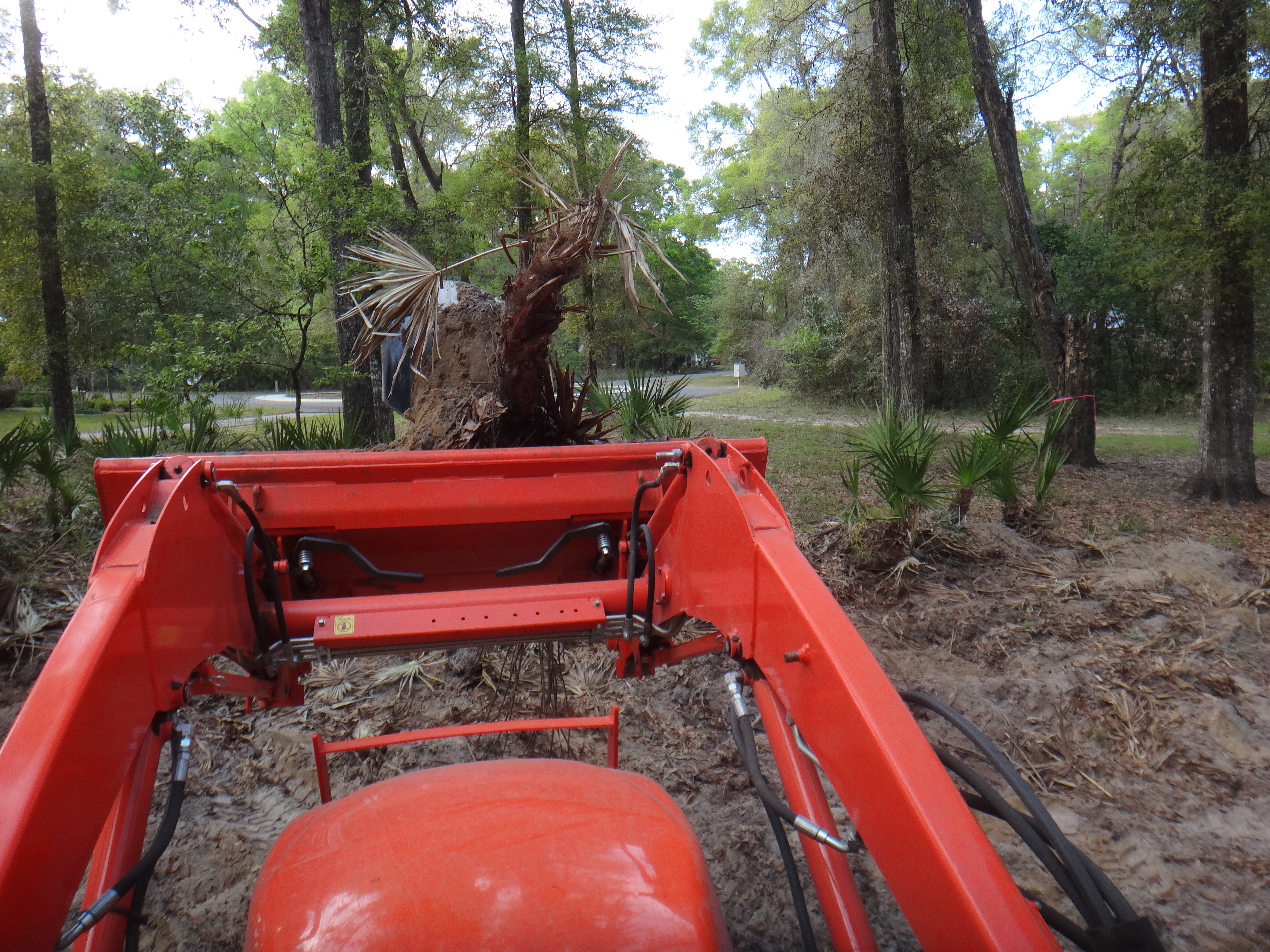

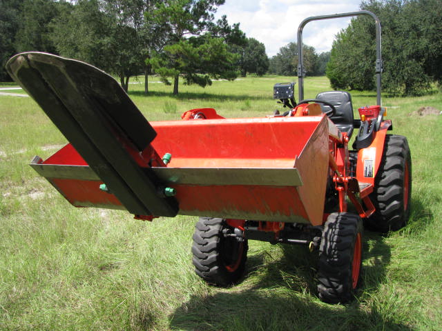

I have removed hundreds and hundreds of Palmettos with the Bucket Spade. First with Bucket Spade mounted on the standard bucket on a Kubota 'B' series tractor-loader, which required prudent operation, now with the Bucket Spade mounted on my Kubota heavy-chassis Grand L with Kubota's optional heavy-duty, round-back bucket, L2296. No problems. Well designed attachment for digging with a FEL bucket.
Bucket Solutions' Bucket Spade come with sockets and bolt locks to attach to pallet forks if you need to dig deeper than 48". I have never needed to reach deeper.
A Bucket Spade will be much more efficient at Palmetto removal than pallet forks alone. It is designed to dig. It is a spade!
