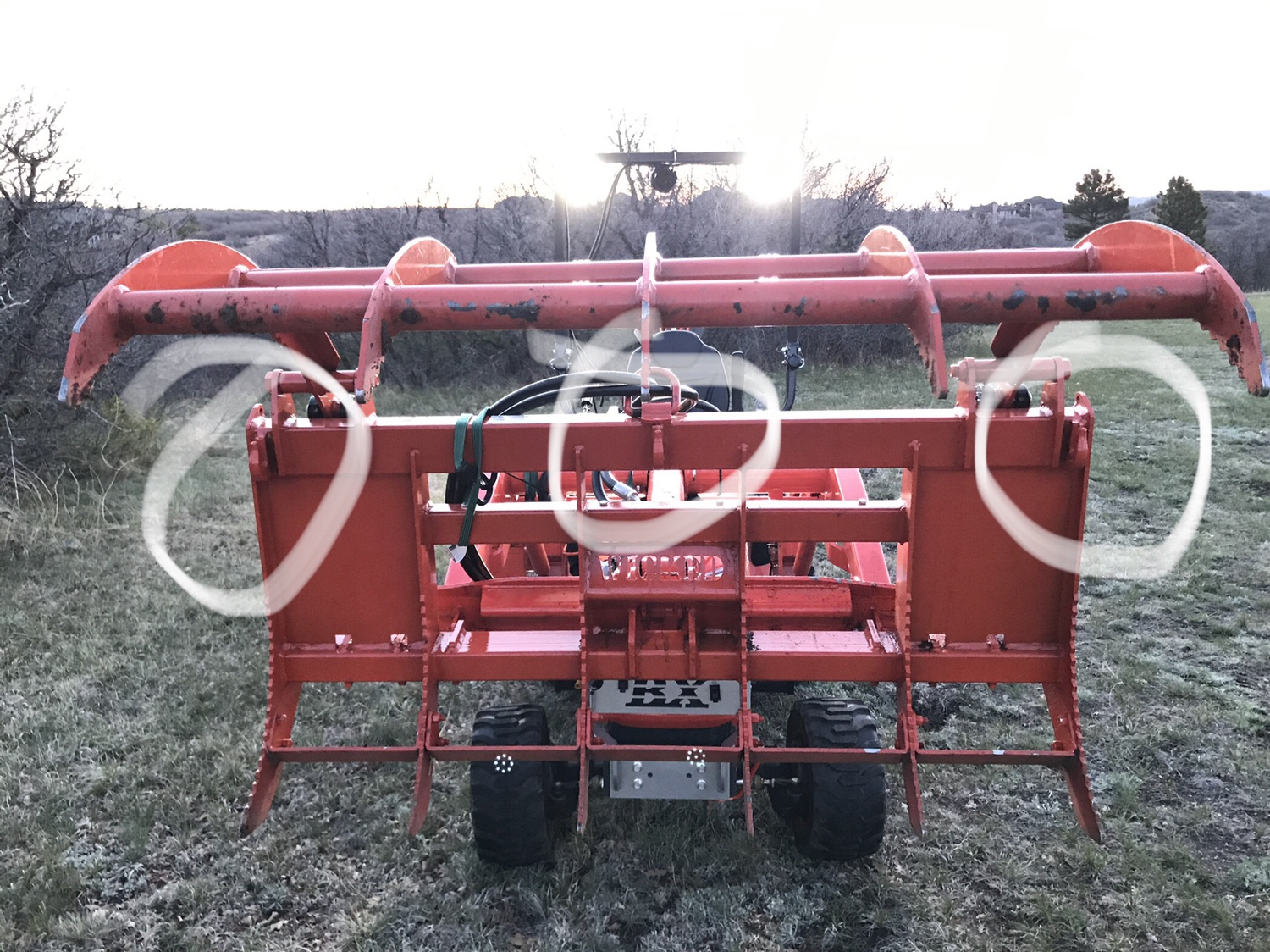

My EA grapple came with them... so yes it’s definitely possible.

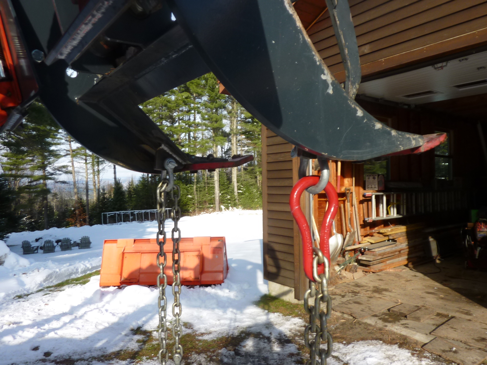

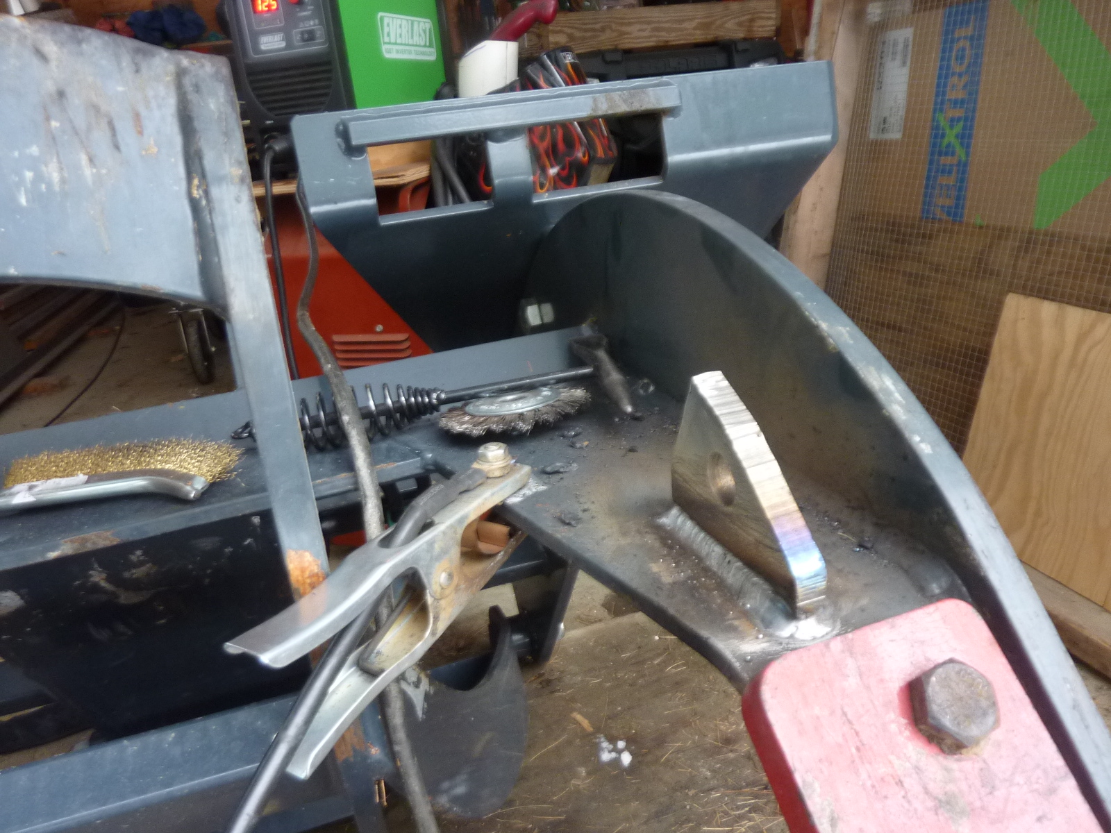

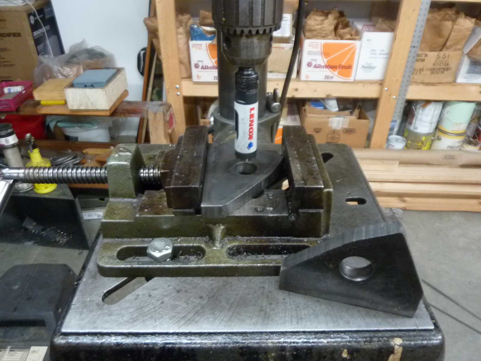

I have a logging grapple I wanted hooks on. I couldn't find a good place for weld on hooks. They would either be to exposed or in a poor position. So the first plan was to drill a couple 3/4" holes and use shackles. But drilling with a hand drill was a no-go in the hardened steel so I welded on a couple lugs I made. I can use a shackle for a slip connection or a grab link for a grab connection. This a a different type grapple than most of you have but it might give you some ideas.
