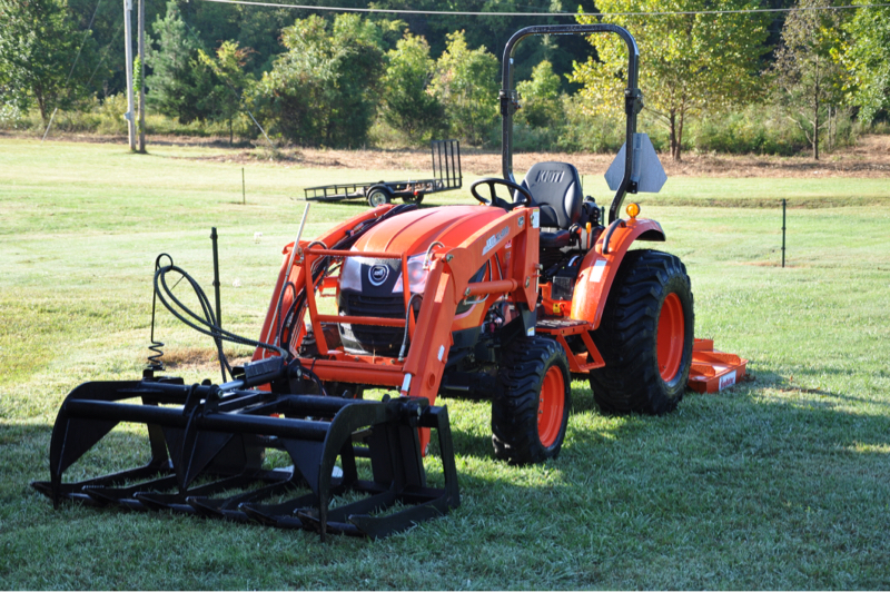

What grapples are you all using on the smaller machines, CK series? I have the 2610 and need a grapple to pick some logs up.
I rented a set of pallet forks and it worked great. Only had one log I couldn't pick up, 20' long 20" diameter hemlock log, tractor said NOPE, not moving it. So I just pushed it out of the way.
Got my sawmill set up and need an easy way to move logs onto the mill.
Thanks

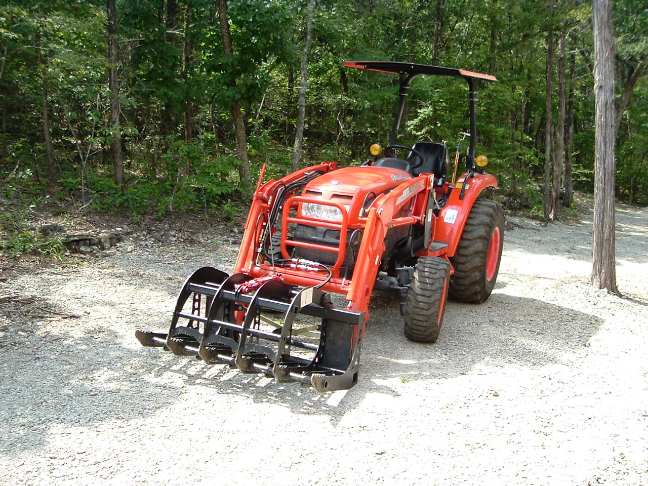

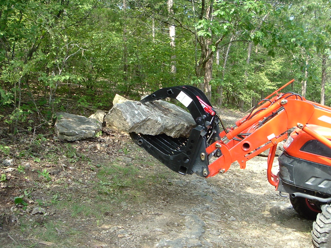

Many of us use 48" single lid grapples on CK and DK size tractors. Although not the cheapest, the slickest such grapple is made by Everything Attachments. I think they call it the compact grapple. It weighs less than 300lbs and is very nicely designed and built. Other companies make similar coarser and heavier versions of such a light duty grapple.
I have a 300lb 48" Millonzi grapple that has been clearing land for me over ten Summers first on a CK20 and now on a DK40se. Works great. I'd advise using rear remotes to control the grapple. Much cheaper and easier. Works just as well as diverted valve Etc.
A bucket grapple is also a reasonable solution but isn't as efficient or flexible. Much better than no grapple and about half as efficient as a true grapple. Cheaper for sure but needs the same hydraulic controls b

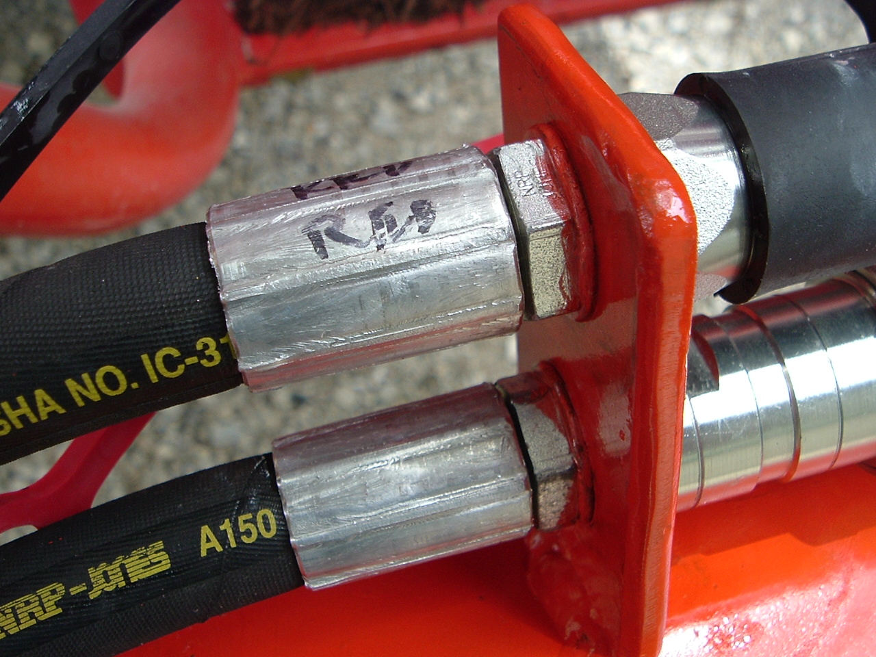

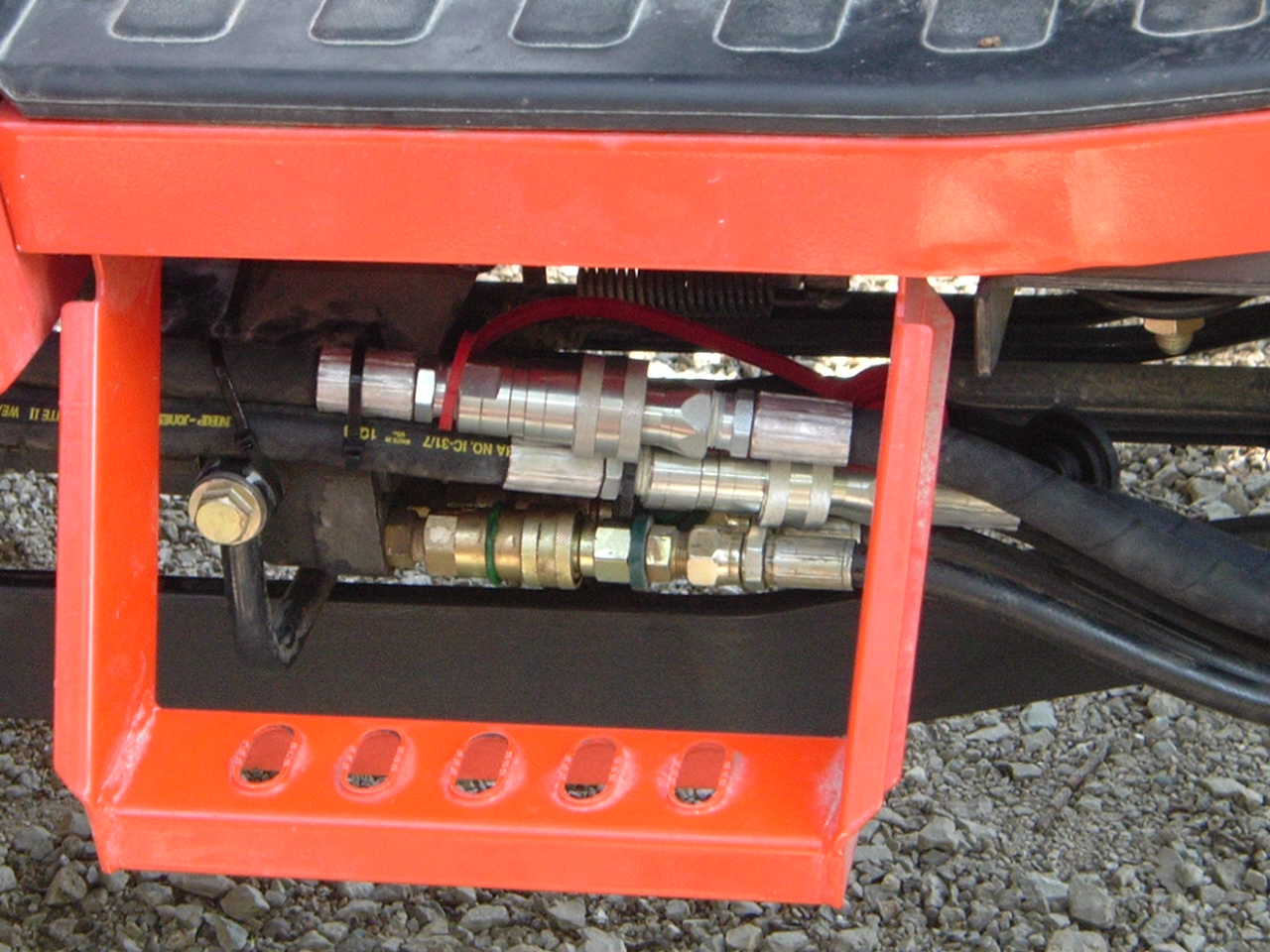

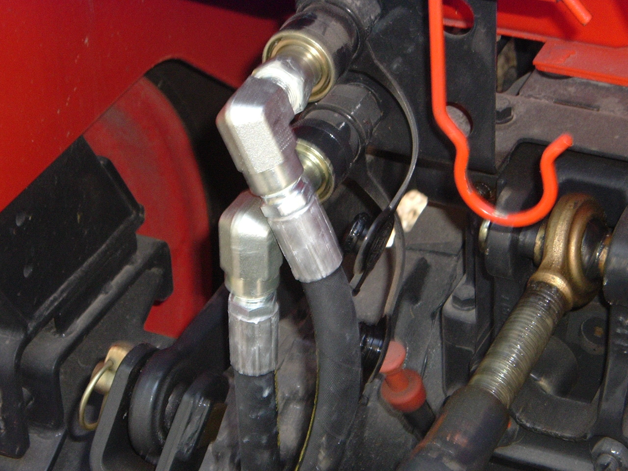

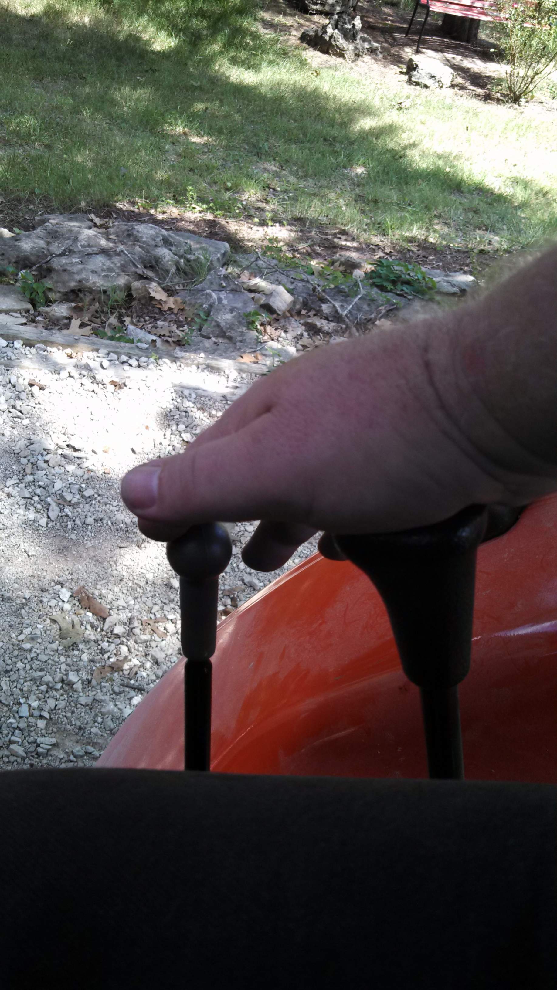

I have an extra remote on the rear of my tractor. If I am not mistaken I can control the tractor grapple with pushing or pulling the valve one way then the other. I might be wrong, it's known to happen from time to time..:)

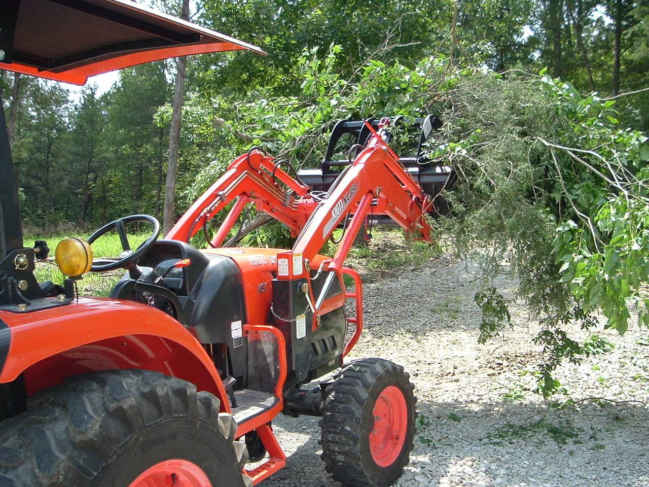

I bought the 48" grapple from Titan. It's working well, isn't super heavy weight wise and seems well built and a decent price.
   / Grapple #8
This is the grapple we use it works great.

I'll look them up. I have an extra remote on the rear of my tractor. If I am not mistaken I can control the tractor grapple with pushing or pulling the valve one way then the other. I might be wrong, it's known to happen from time to time..:)
You are correct. One set of rear remotes plus about $75 of 3/8" hydraulic hose and quick connect fittings is all you need. That's how my CK20 was set up. Very efficient.
