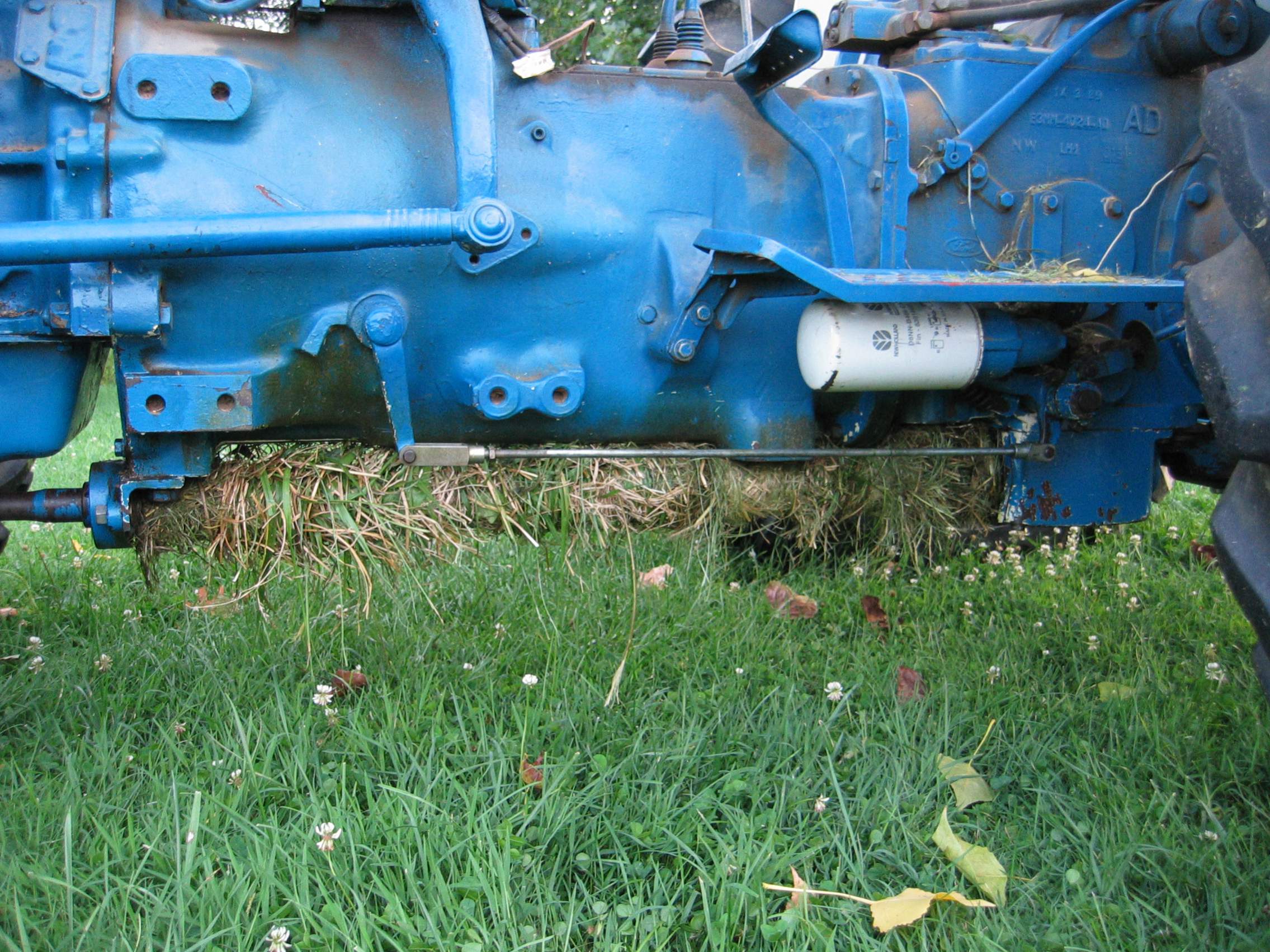

When I mow/bushhog long grass, the grass winds itself around the driveshaft. It's a real pain to get off, and it breaks the seal where the shaft enters the rear half of the tractor. Is there something I can do to prevent the grass from winding up? Is there a guard I can purchase to prevent it?

Is that a 4 wheel drive, drive shaft? If so, can you mow in 2 wheel drive? I bet you could build a cover for it by getting some heavy sheet metal as long as the drive shaft and wide enough to form into a half circle and bolt to both sides where a front end loader would bolt. Those holes should already be threaded. Se the 4 bolt holes, 2 at the front of the shaft and 2 half way back?

Mow more often and use 2wd if you can instead of 4wd. I never seen anything like that.

I thought the 3910 had a cover over the front drive shaft to prevent such from occurring. Was the cover removed, or am I wrong in my assumption?

I thought you were talking about the pto drive shaft! You obviously have a 4WD tractor. Do you have to mow in 4WD? If you do, check with a NH dealer and see if a driveshaft cover is available. Other wise you'll have to make one. My TD95D had a shaft cover on it and so I would think they were used on all 4WD tractors.
I looked on Messick's website and there is a shield for the drive shaft.

Doesn't the shaft turn in 4wd and 2wd as long as the tractor is moving?
   / Grass winding up on driveshaft (Ford 3910) #10
I am not sure on this particular tractor, but on my tractor it doesn't.
