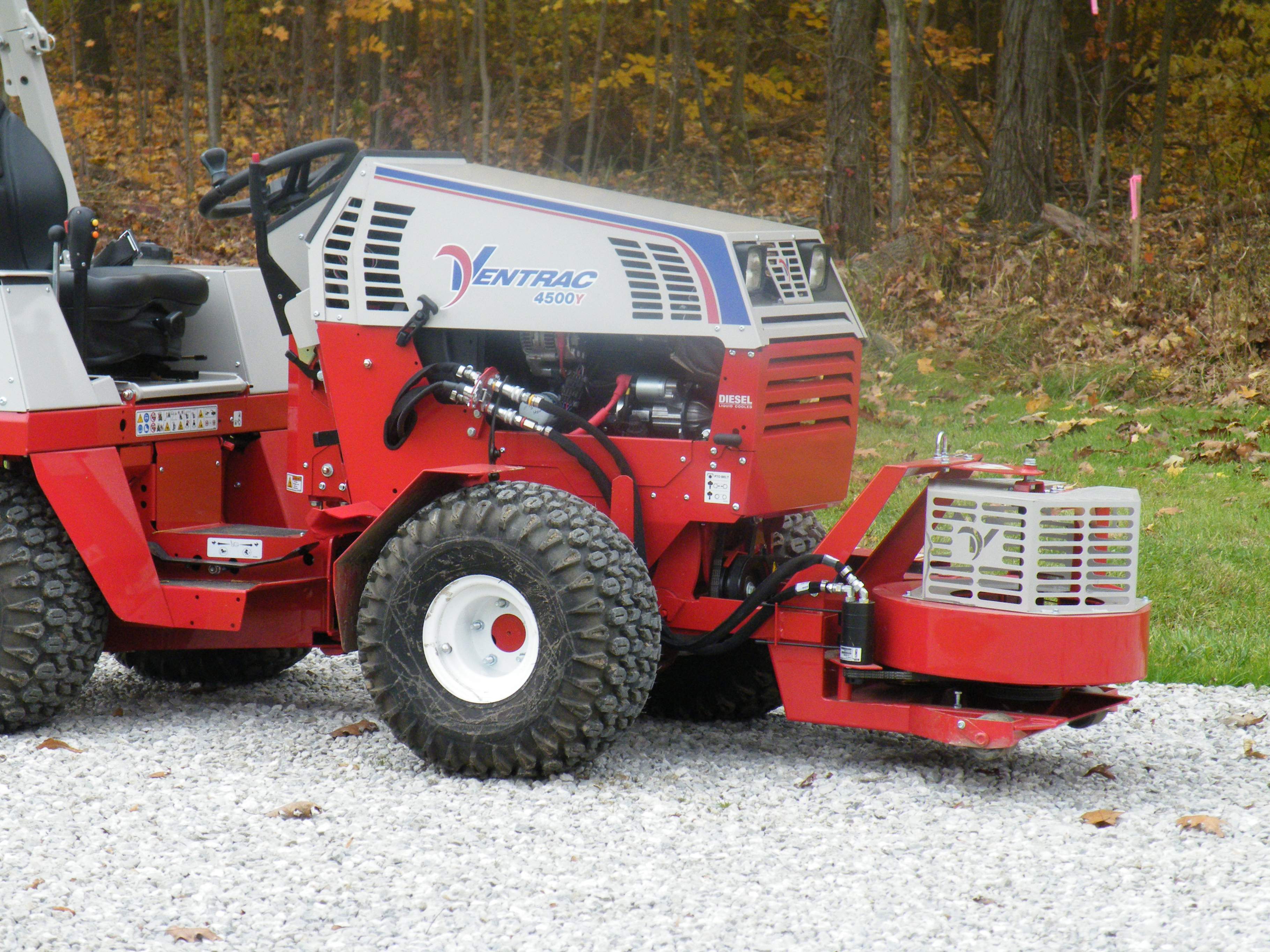

I like the Ventrac 4500 series but don't know if you can get it there.
