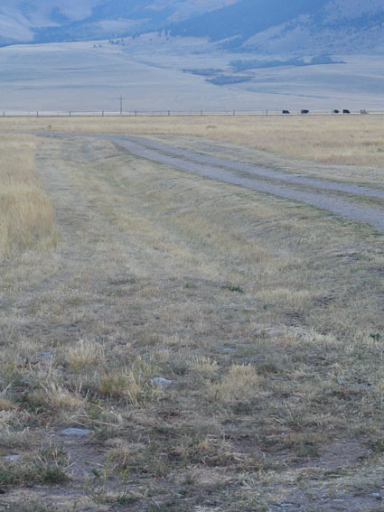

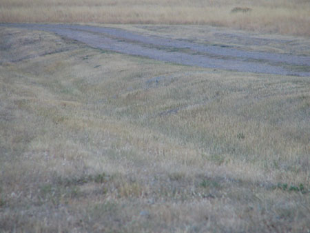

I just got my first real tractor, Boris, a Belarus 825. I am going to rebuild my driveway and wanted to get everyone's input (I know it is a common topic, but wanted to get comments on my specific situation).
Basically I live in SW Montana and we get a LOT of wind. In the winter we will get a few inches/feet of snow, then it will get blown away in a day or so as it isn't too long after a snow storm that the everyday wind is back in action. (if the wind even subsides while the snow comes, sometimes it is ground blizzard conditions). So we can get some HUGE drifts.
With that said, the previous owner of this property had a taller driveway constructed when he built the house in 1992. He stated he had the driveway built up so much to ensure the wind would just blow the snow off of it, instead of it creating a drift on the north or south side.
As you can see by the photos I included, the driveway is pretty much shot.

2. The ditch can get kind of steep on the one side, will the BB and RAB work for me? (I dont want to tip my tractor over obviously, do I need to worry about this if I were to tackle with the tractor wheel in the deepest part of the ditch?)

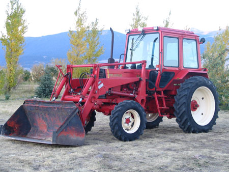

Boris, is almost 10' tall, has loaded rear tires & FEL.

Boris is a big dude.
Looks like you should be able to do that project no sweat. You will most likely use the boxblade and angle blade for many other projects and future maintenance anyway. Size of implements sounds right to me. There should be a manual adjustment for the top link and side links too. That will allow you to cut or rip and tilt the blade(s) to one side for crowning the drive.
Just watch out going in that ditch along the side of your road and go slow. It doesn't look too bad, but you will feel it when you get the tractor tilted a little. Dragging a boxblade will help with tipping, but if you ever feel it tipping, stop and drop the bucket onto the ground quickly and back out with the bucket down. Raise the box a little but be prepared to drop it too if needed. If there is a wheel spacing wider than what you have now, make that change and put the wheels at their widest stance too. Once you get it fairly smooth with the crown you want, it should be a lot safer and easier. I would do your project myself rather than pay the guy with the grader. IMHO, your money is better invested in implements for future use and the tractor experience you gain is invaluable. That's what you got it for anyway, right?

I'd recommend getting a rear blade with offset and tilt capability. This will allow you to work the sides of the driveway while keeping the tractor safely on the road. Between the adjustments on the blade and the side link on your tractor you can get some pretty aggresive angles that allow you to freshen up ditches as well, all from the safety of the driveway.

Use the back blade to windrow as much of the present road surface to one side of the road as possible. Roll this windrow back and forth till the road surface seems even and smooth but leave it on the edge of the road. Then work on the other side of the road at 90 degrees to the road and use the loader bucket to bring material from the ditch and side slopes to the road. Then windrow this material into the existing windrow and move the windrow back and forth a few times leaving it on the opposite side as be before. repeat the ditch dirt procedure on the other side. Now start windrowing back and forth to get an even distribution of materials and then use the gage wheels to leave a little on pass till you run out of material.
This should approximate what the road grader can do.:D
Happy road building.
