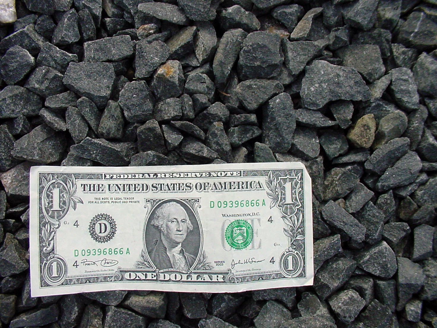

On the lower part of my drive I have 3/4 processed stone which is stone and stone dust that packs down very well, and I can plow it without much trouble. Near the house I have 3/4 trap rock (see attached pic). The trap rock is nice because you don't track stone dust into the house, but the down side is it is very hard to plow. I usually have to back blade it or I end up with a pile of stone on the lawn:(. It does look nicer than the processed, though. Whatever you use, make sure you have a nice crown on the drive. Good luck.
