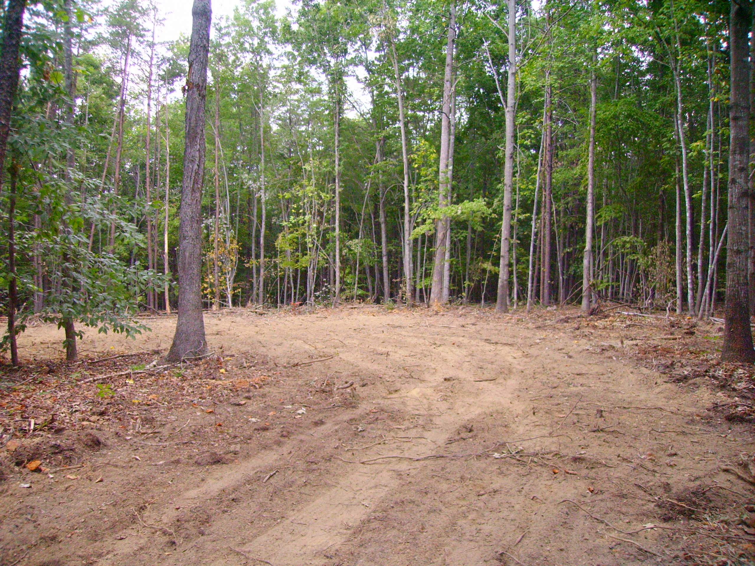

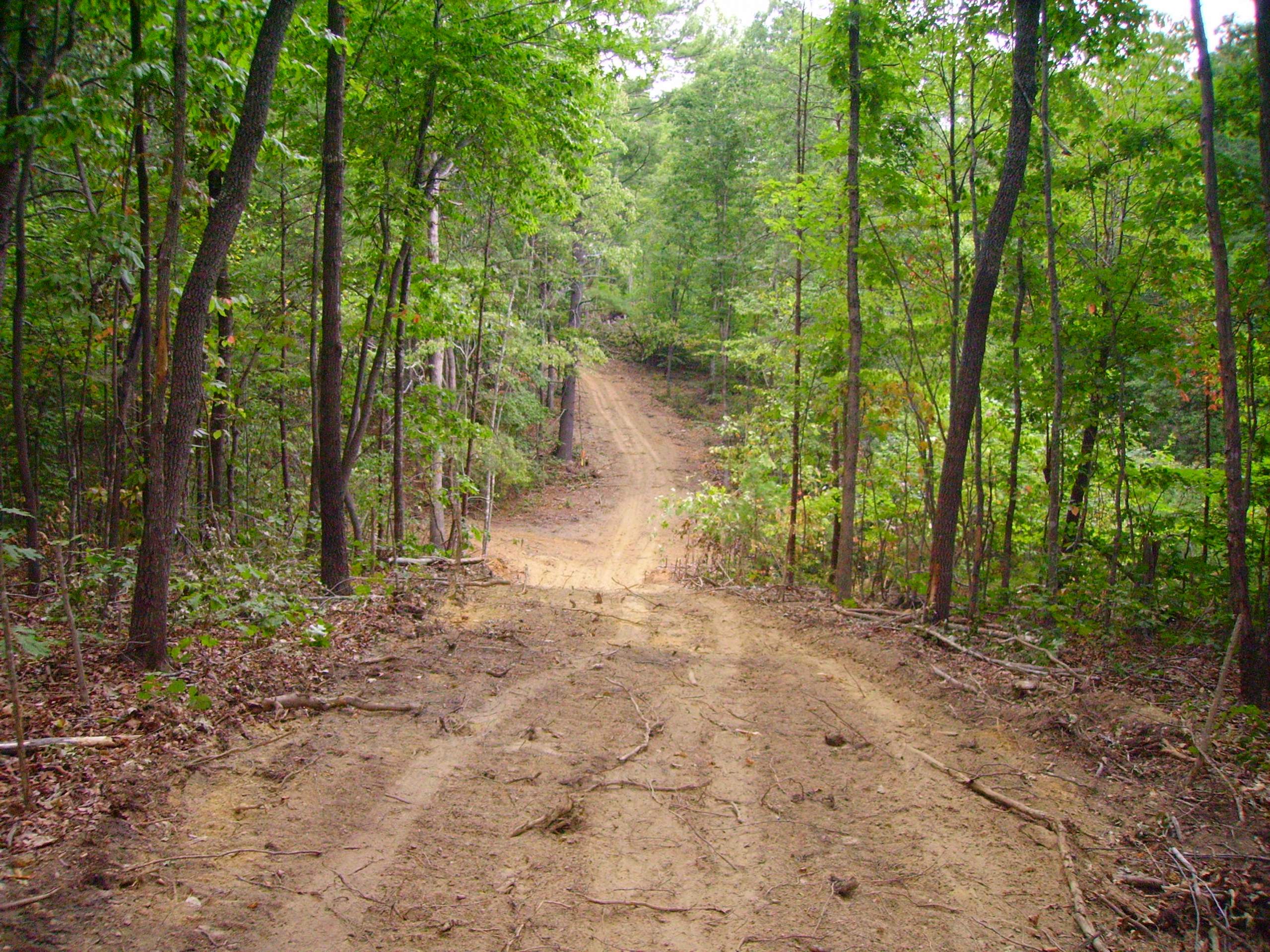

I need some info: I am building a gravel driveway thru the woods, 1000' long. How wide do I need to cut my trees back so that I have room for the drive and ditches? I'm thinking 10' for the road and 10' for the ditches on each side but not sure this is wide enough. Should I cut a 30' wide path? Thanks
   / Gravel Driveway #2
I would go a lot wider. While it is nice to have the trees along the driveway you will find that trees cause problems. On the southern side of the driveway you will want the trees back far enough so that sunlight can shine on the driveway most of the day. the sun will keep it dryer than if it is shaded. Ive lived on gravel roads all my life and it does make a difference. The shaded parts of the road always seem to turn to mud during bad weather with out the sun to help dry it that moisture just soaks in. Also make sure that the driveway that it has a real good crown across the road. I hope this helps.
   / Gravel Driveway

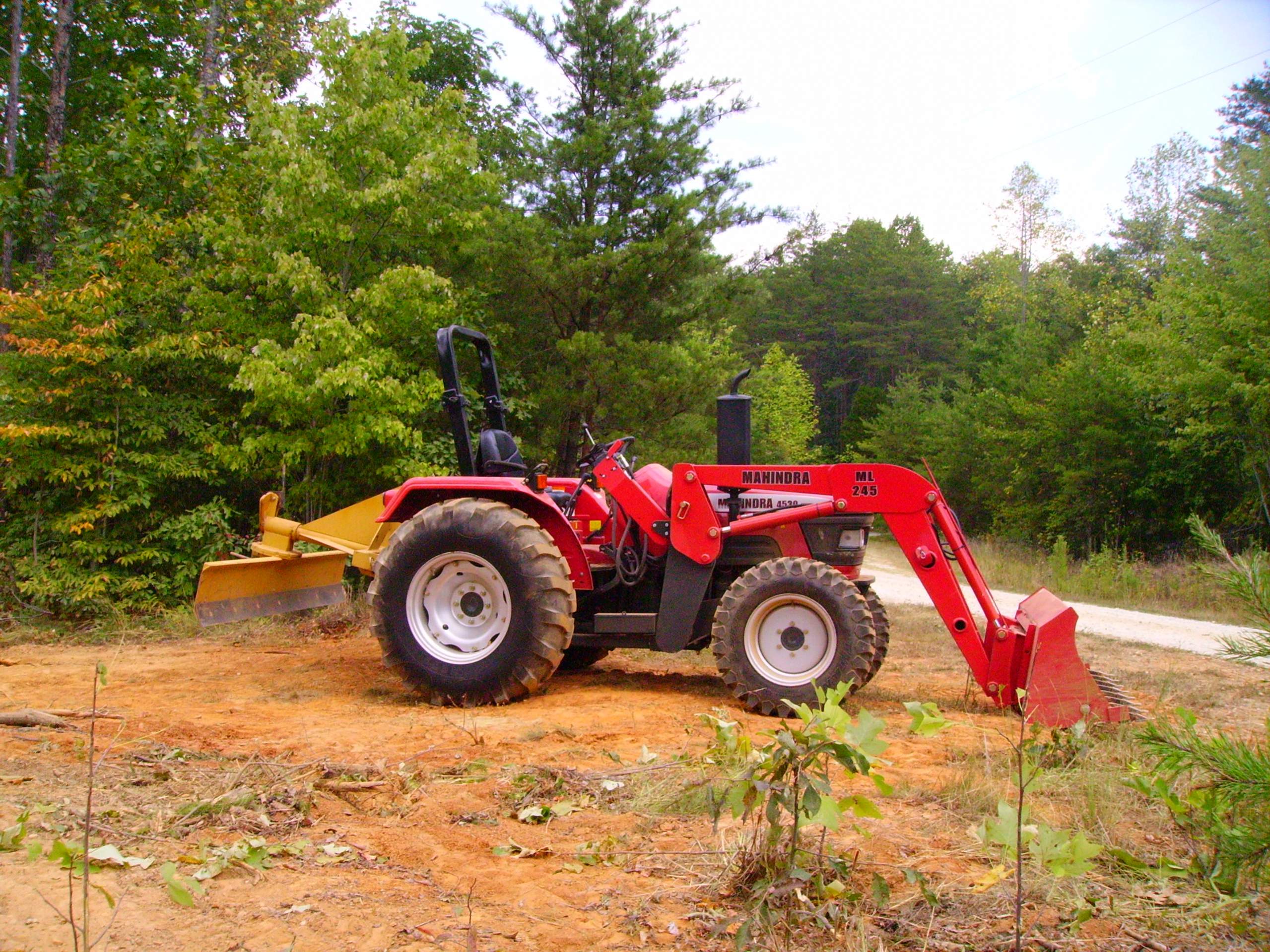

Thanks alot, now I can sleep at night. I hired a dozer for one day so I could cut the trees and skid them out with my 4530 Mahindra. Now I know how wide to cut. I have 15 acres that I will build a few RV sites on for my RV and for friends when they visit. It's a mud hole right now. The photo's were taken this summer when the dust was ankle deep.

Thanks for the photo's, they helped a lot. I have a 50' right away with 10' on each side for utilites, that leaves me 30' for the road. I will cut it 30' wide. I like this site, you guys a very helpful.
