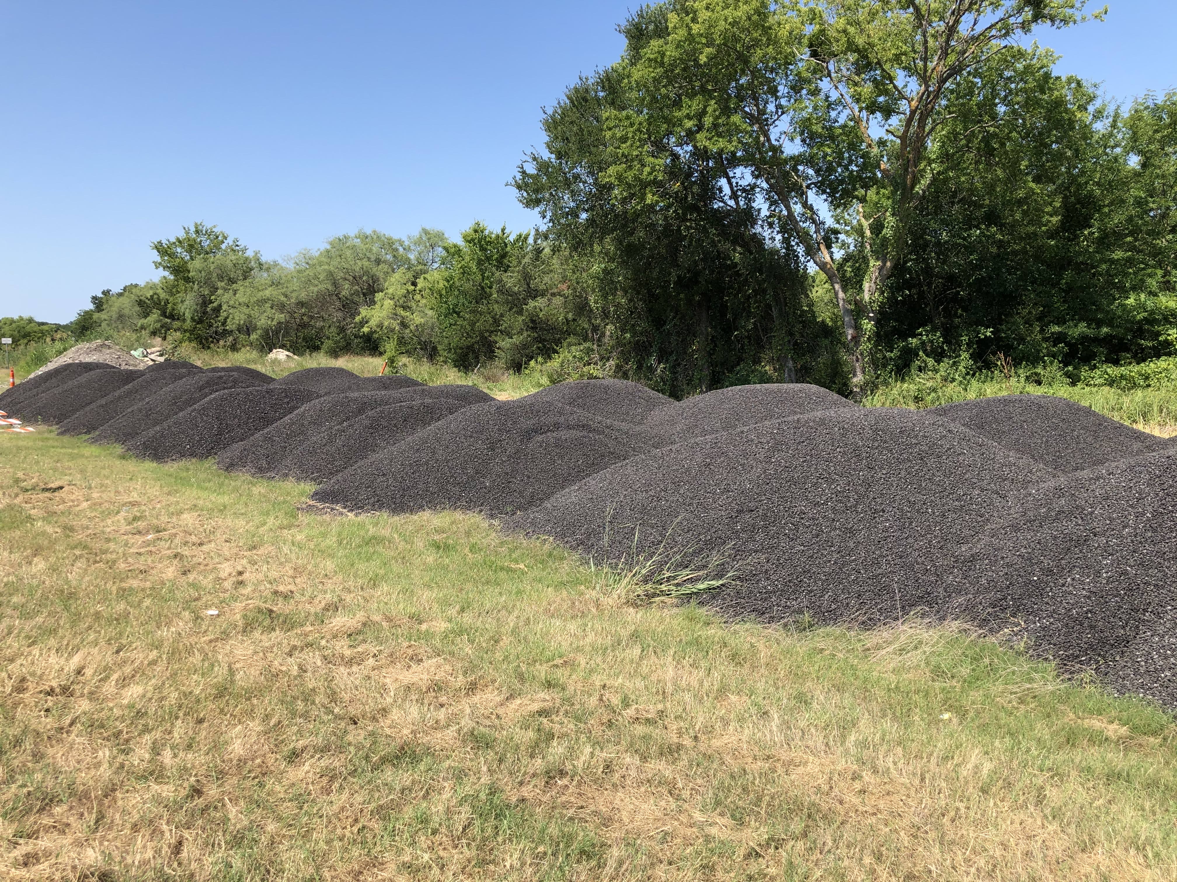

Anyone know what type of gravel the state (Tx in my case) uses for asphalt roads.
I see large piles all the time on the side of the road. Usually dark grey and almost black sometimes. I assume they use it to mix for road building.
Looks 1” or less and very uniform size.

Piles on side of road are for seal coat applications.
Spread hot liquid asphalt, and distribute the rock on top. Sweep off excess.

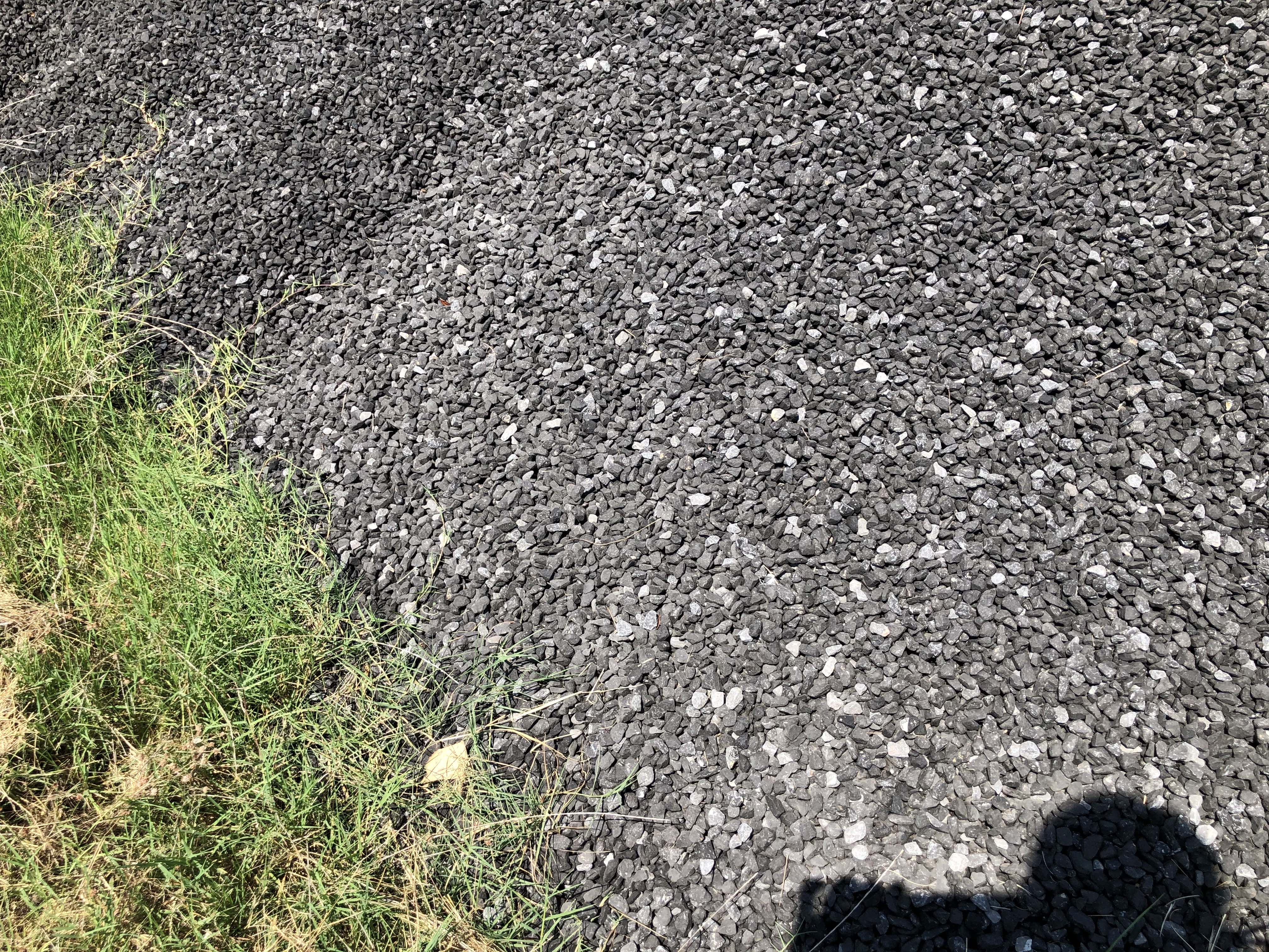

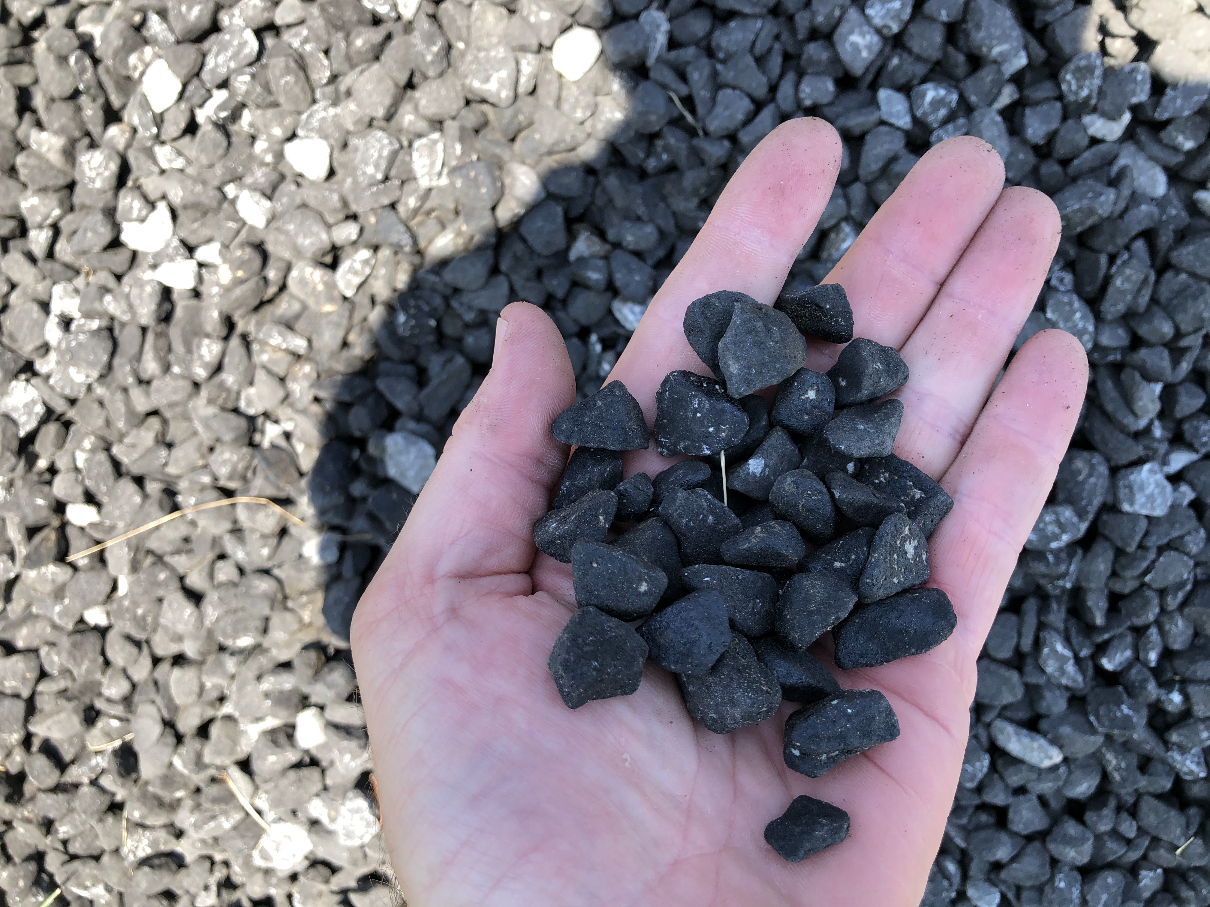

Here’s what I’m seeing. I’m thinking about putting it down over a crushed concrete base if I can find a source.
   / Gravel question #9
Yes, chip n’ seal a term used for it.
No/little fines in this material generally, won’t ever pack and setup above a hard base.

I see your point about it not setting up without fines.
