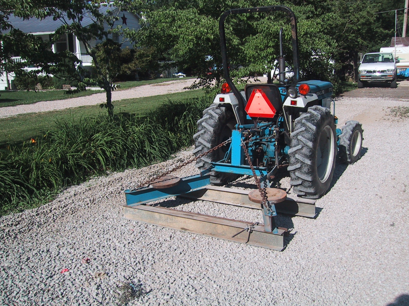

A buddy and me are trying to build a copy of the Grademaster or Duragrader. Has anyone tried these ? They seem real simple but cost 1000$ or more. I have a 1/4 mile gravel drive that drives me nuts keeping the washboards out! So far a pallet with blocks drug slowly works best. Thanks.
   / gravel road maintainer #3

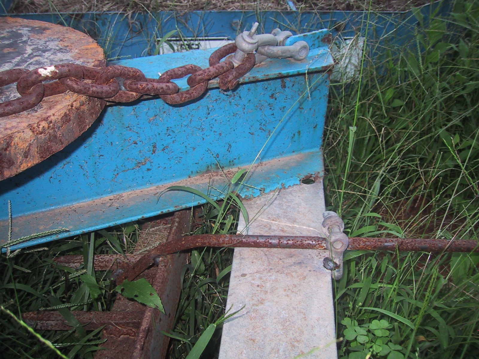

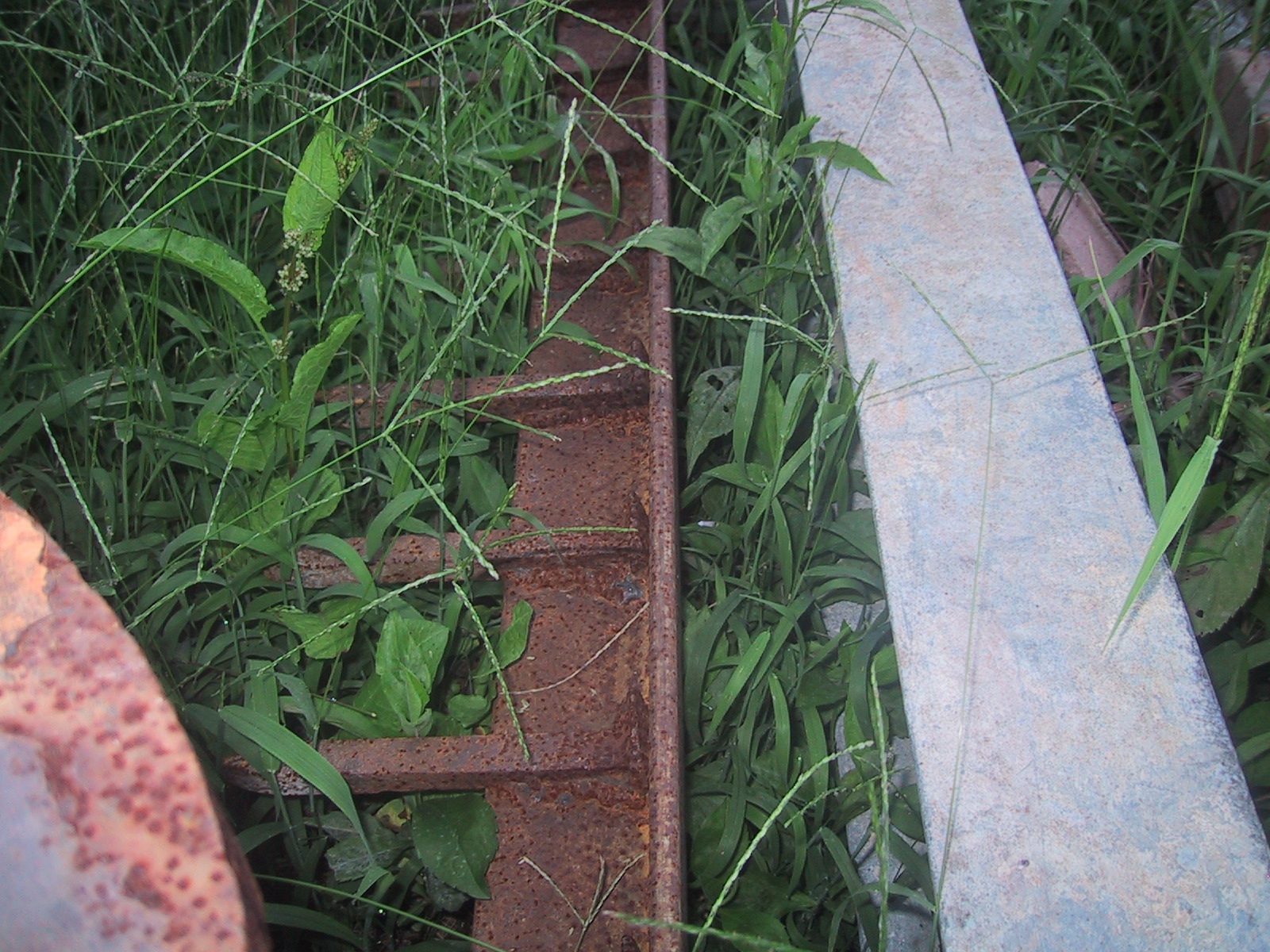

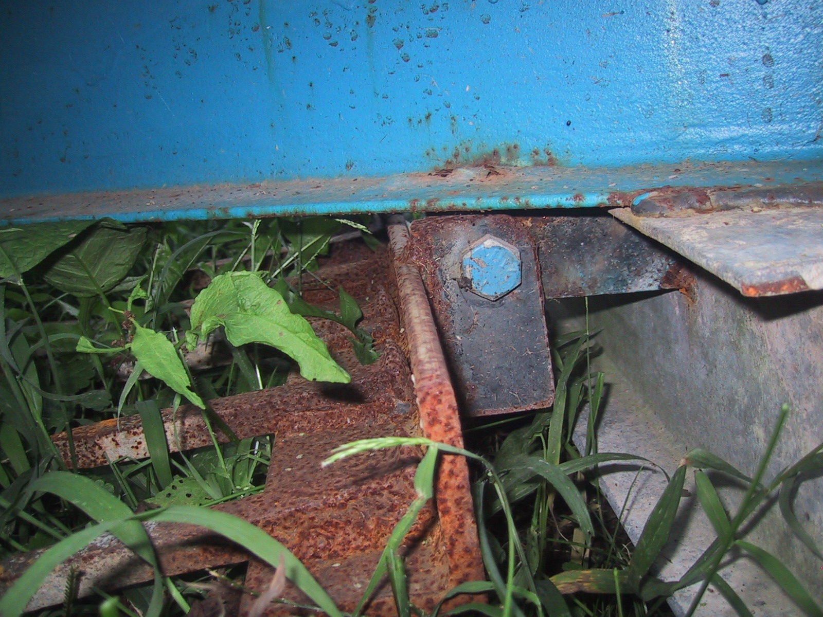

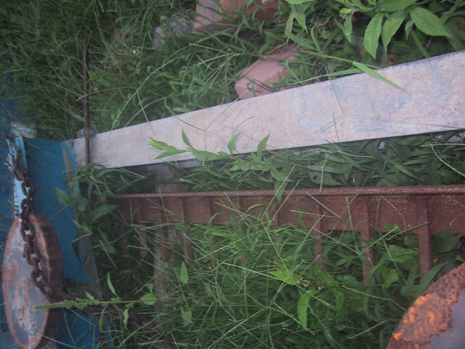

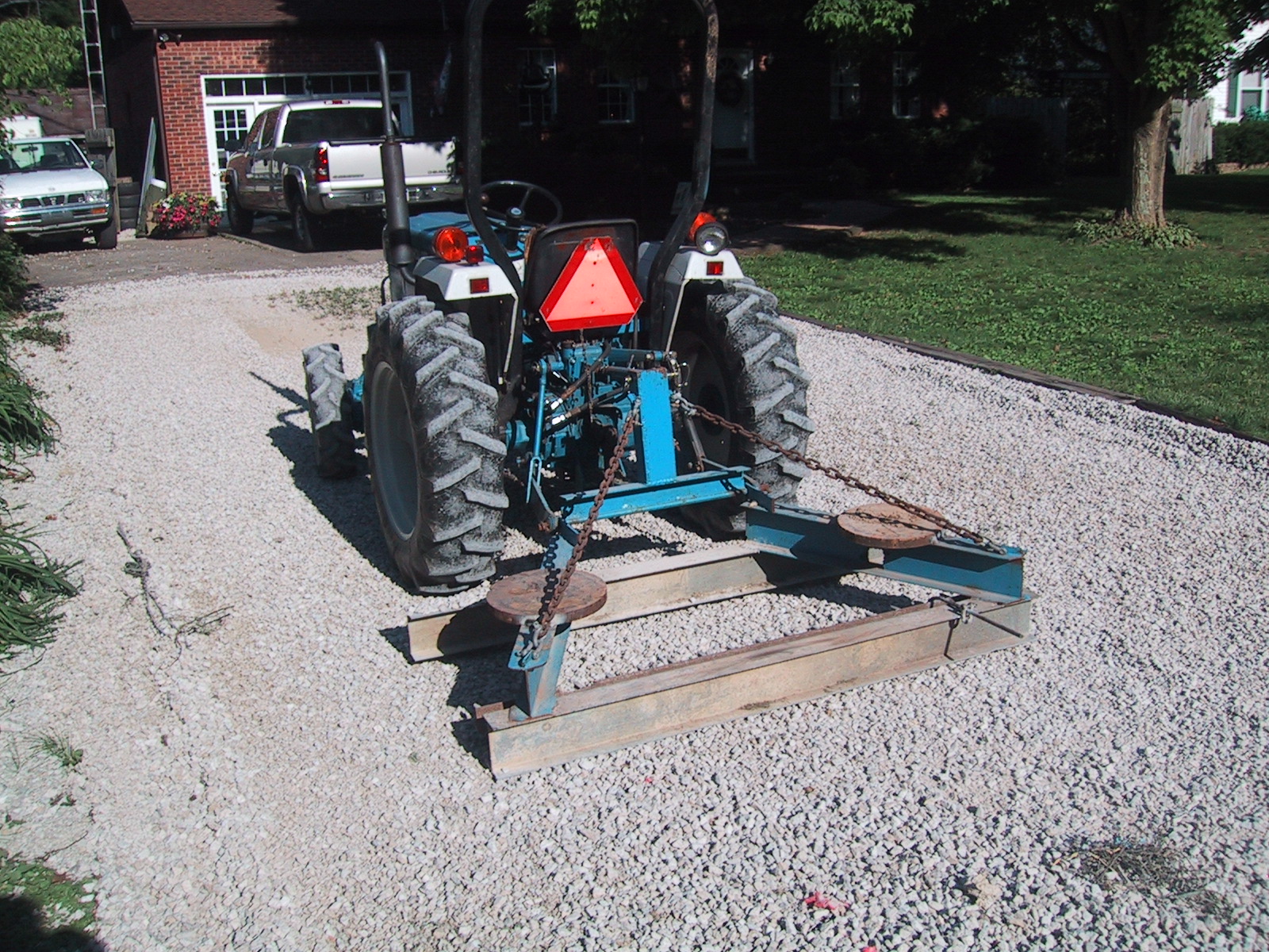

This is one I built to use on my drive way. Is built from Guard rail post and RailRoad Spikes. Total cost about $25 and 6 hours labor. It works for me as my budget is limited for such things.

OldMax,
Nice job of using what is available!

Make sure whatever you build will allow you to create a crown. The down side of any drag typre set-up is that it grades flat and pushes material to the side, hollowing out the road and allowing water to pool.
Ideally you need to be able to pull material from the ditches to the center of the road. Water can then run un-obstructed from the road to the lowest portion of the ditch. If water sits on the road surface you will always have washboard and potholes.
Good luck.
