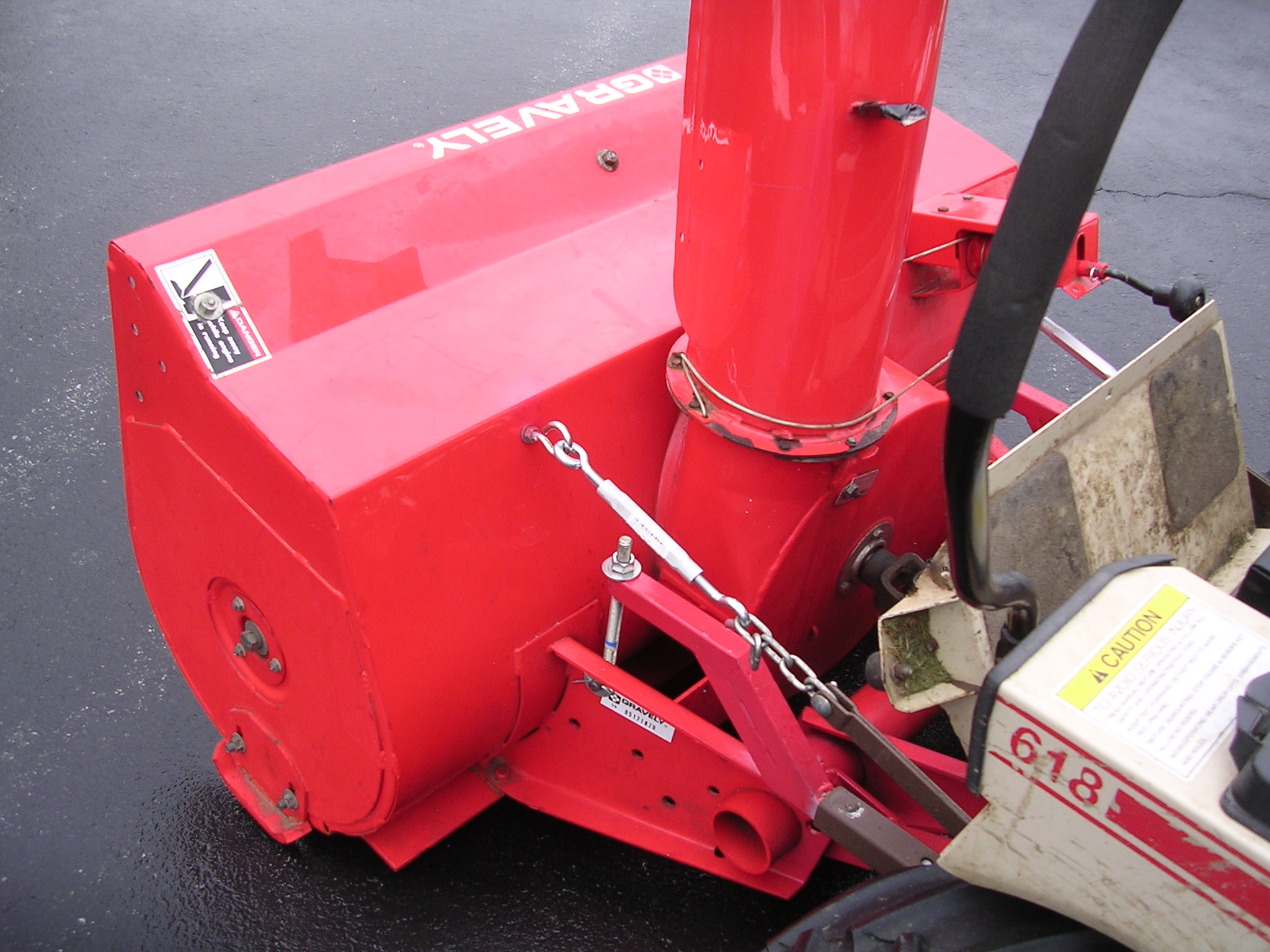

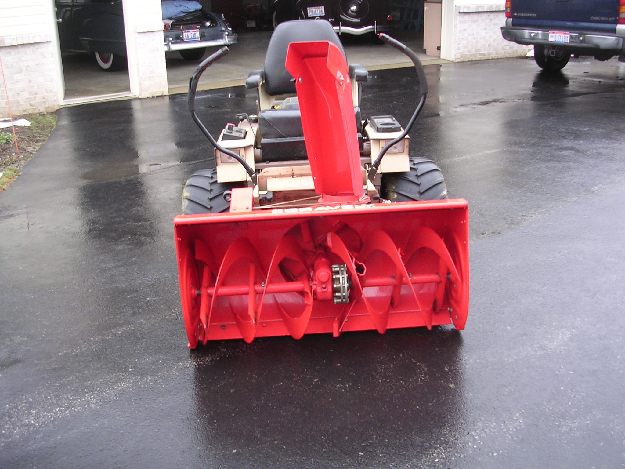

Does anybody know the the max impillar shaft RPM for a Gravely snowblower model 05171879. It is a 1991 model with a 40 inch augar. Thanks Dave

Gravely PTO speeds are about 900 RPM.

Richard Tx Thanks for your reply to my Gravely RPM. question, Would your answer of 900 RPM. be the normal operating speed? My gear box ratio seems to be aprox. 10-1 That would be a little less than 100 RPM. for the augar speed, does this sound correct to you?
thanks Dave
   / Gravely 40 inch snowblwer shaft speed [RPM] #5
The PTO speed of 900 RPM is at engine rated RPM. The old L models which had a 2400 RPM Gravely engine had different gearing than the later tractors that had Kohler, Briggs, etc which were rated at 3600 RPM. In any case, the PTO RPM stayed the same.
The blower gearing is what it is, so 10:1 seems fine to me.
Be aware that some snow blowers have a bronze gear in them. As such GL4 lubricant is mandatory. GL5 acts more like cutting oil to yellow metal.
