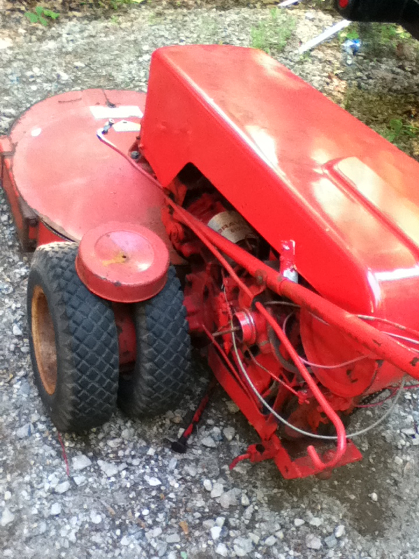

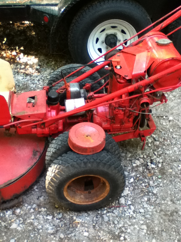

Hey guys so I finally got the gravely to sputter and it's gettin spark. Now I had my pops take a look and he said I have fueling issues. Honestly I'm not good at all with carbs so, where would be a good starring point? Also I'm gonna probably sell this when I repair it and play for awhile, so I'll upload a picture and what do you guys think this might be worth? Thanks

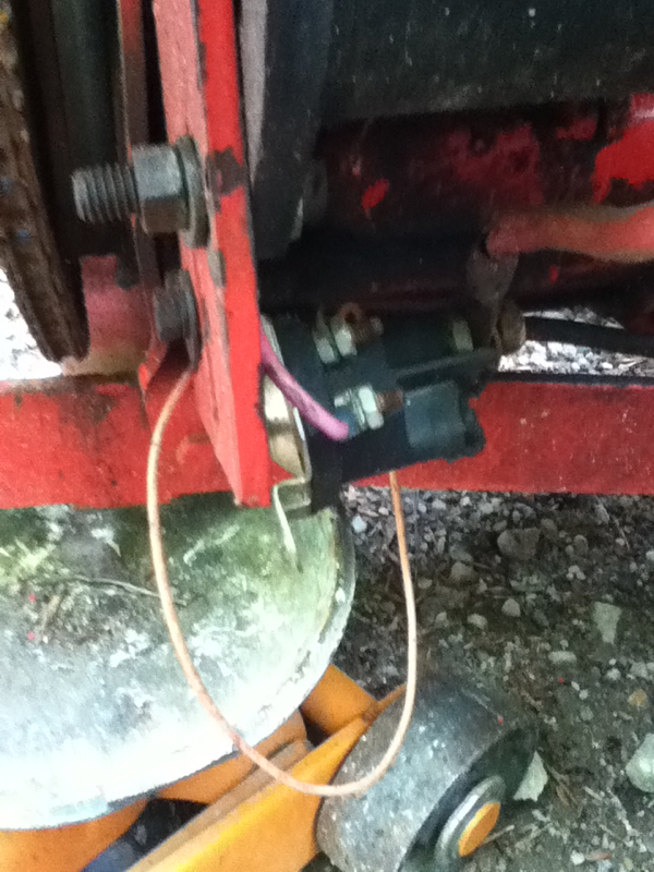

ok thats tomarrows project.. now one more question the startir sylinoid is all mashed up so is that part of the reason it wont fire?

also, looking at the picture i posted, what do you think this would be worth in good running shape? thanks
   / Gravely l8 #17

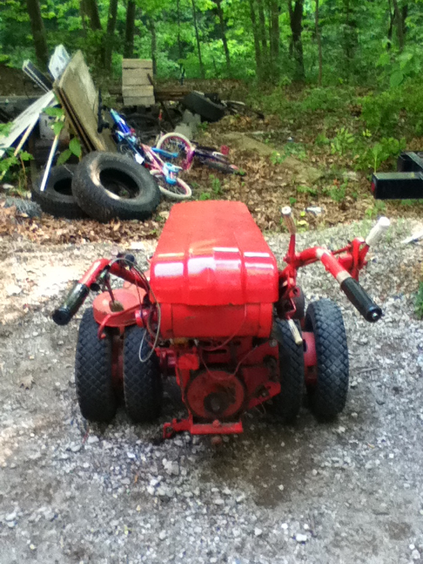

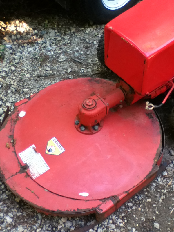

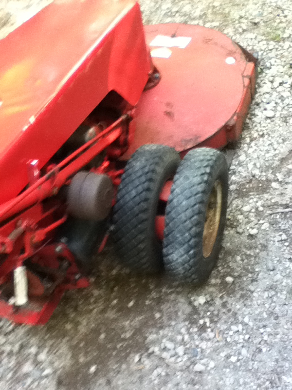

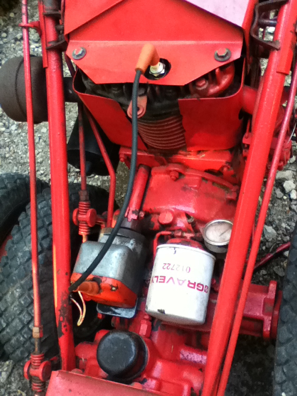

Maybe between $200 and $400 depending on condition. Some more pictures would be a big help, side profiles as well as under the hood and of the mower. If you decided to sell, send me a PM, I'm just one county over.
   / Gravely l8
#18
here we go
