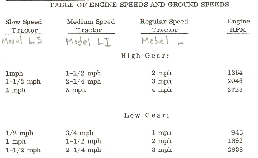

So the wheelhorse low low at idle is really crawling. Like 1/4 MPH or slower. This is why the gravely C8 seems fast in low low . So what RPM is gravely idle? about 800 RPM?if C8 or LS low low is 1/2 MPH at 946 RPM it probably cannot go much slower than that. If I am bushhogging I need around 2000 RPM right? So now we have a 1 MPH ground speed. This is why my CS still seems faster compared to my wheelhorse. Because it is.
Found the attached gravely speed chart page in an old manual.

Randy- 1500 is idle and 2800 is the top rpms. Also I had a brain fart with my last post. Gear reduction wheels will not work on a multi speed tractor ( L/C 8 ). You will need an L/CI tractor, then you will have a real crawler and that's all it'll be good for. - Kris
