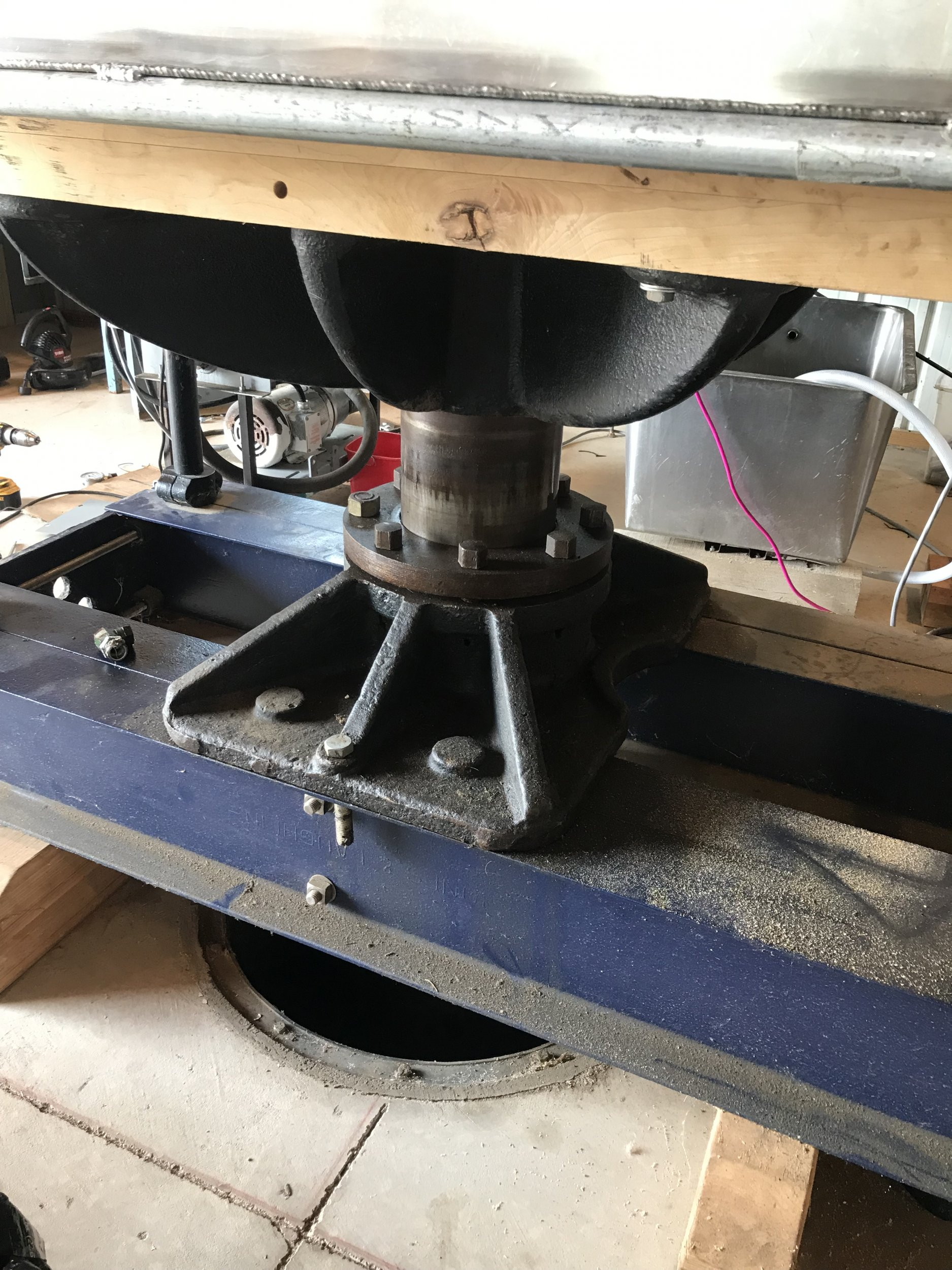

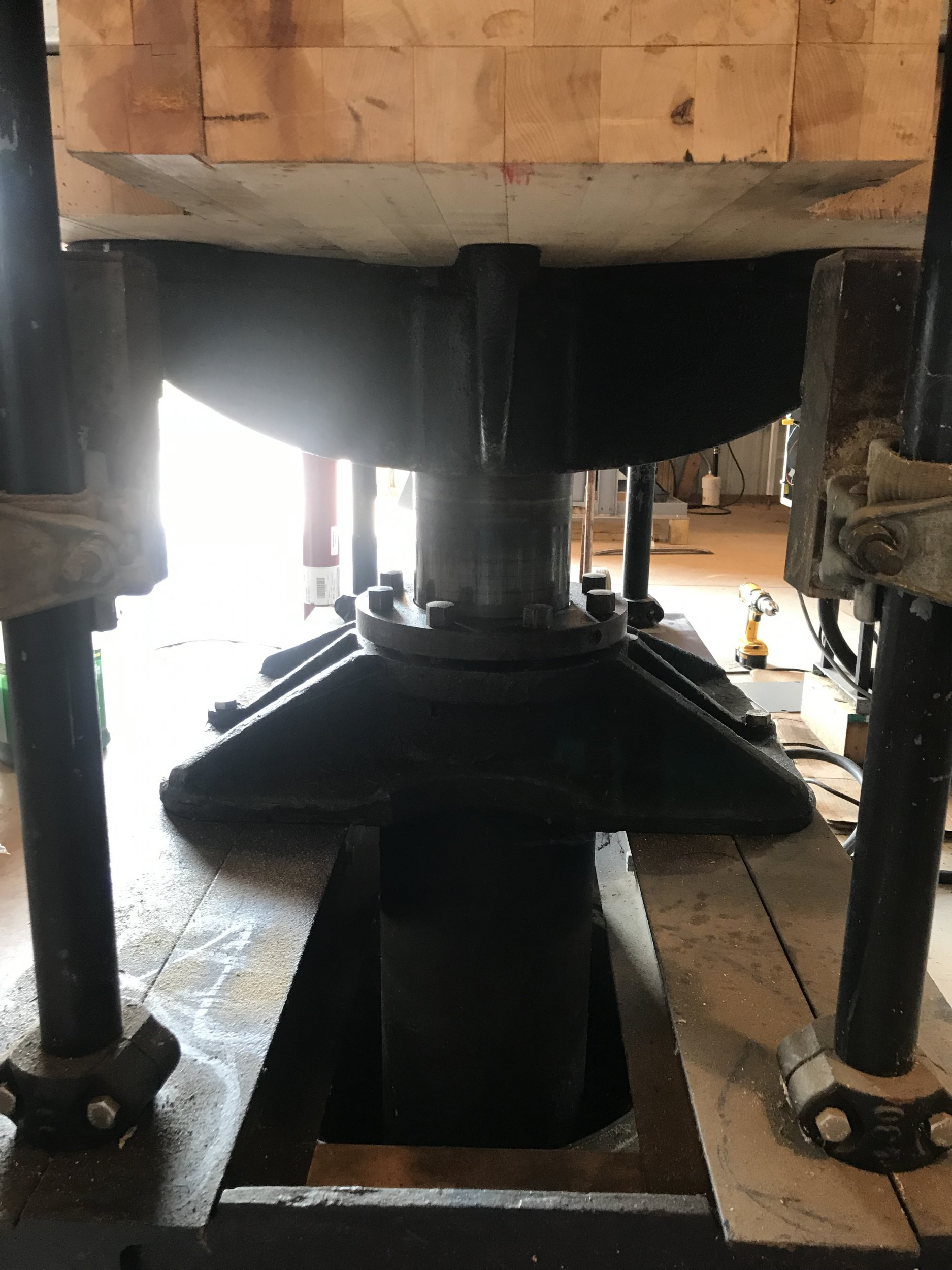

Here are some photos of the press cylinder

R8
Are those pictures with the press fully open or closed?
If closed it looks like the bottom of the shaft or piston could be covered with corrosion and be slightly rough vs a nice smooth polished surface. If rough surface this would create extra friction preventing press from opening fully
do not polish or sand off rust preventing finish though.
   / Gravity Hydraulic Cylinder Requires Pressure to Return to 'Home' Position
#9
It is not fully closed. Some of the piston has rust on it, the piston does not have any plating. The surface is still quite smooth, I have wiped it down extensively with scotch bride pads. I'm betting it is a tight gland.....
oldnslo, you were 100% correct! Even though it looked smooth, it was not. I took a grinder with a light wire brush and cleaned it up really good. It wasn't really a solid bit of rust, it was that corrosion that just kinda swirls when hit with a brush, but you can then wipe it off with a paper towel. Immediately after doing that, it descended just as it should.
