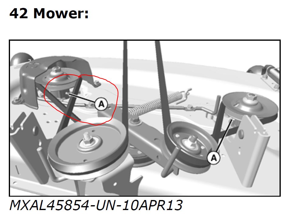

Friends,
I have an X304 with a missing grease zerk (see pic/diagram with red circle). I purchased a replacement grease zerk from JD but it's threaded and does not seat.
So, I called JD parts (local) and found out:
1) the spindle bearing is sealed so the zerk doesn't serve much purpose other than "customers wanted a zerk in that location"
2) the factory zerk is a press-in so a standard threaded won't work. Funny, when I purchased it I told them which zerk I needed for that mower and that's what they sold me. :confused:
As such, any recommendation on sizing for a self threading zerk or perhaps tapping it myself? I'm hesitant to tap it as I don't want to damage the bearing seal.
If you had this issue, did you resolve it? I'll likely just leave as is since it sounds like a non-issue but wanted some feedback.
Thanks!

So the upper bearing in the X series is sealed and the lower is open. That video everyone references is misleading. I'm sure some of the Deere spindles have both sealed bearings- especially if someone put on an aftermarket spindle. But the majority are as they should be. The nice thing about the X series spindle is that either now or when the bearing does fail, you can unbolt it from the deck. Then you can open it up, drill, tap, clean and install your zirc. Do it or don't do it at your convenience, but it doesn't pay to press more grease into a spindle that may have dirt in it. Bearings in these spindles run smaller than those in many competing products and do tend to fail quicker if the deck is frequently washed or are underserviced.

You can buy press-in zerk fittings. There is a special tool that costs around $7 that looks like a punch but it has an opening on one end that perfectly fits over the zerk without damaging it. Tap tap with a small hammer and they go right in. Some folks use a small socket to tap them in but doing so can damage the mouth of the socket.
You can get the tool on Amazon. Just search for Lumax LX-1430 Silver Straight Drive Grease Fitting Tool
You can get a pack of press-in zerks there as well.
